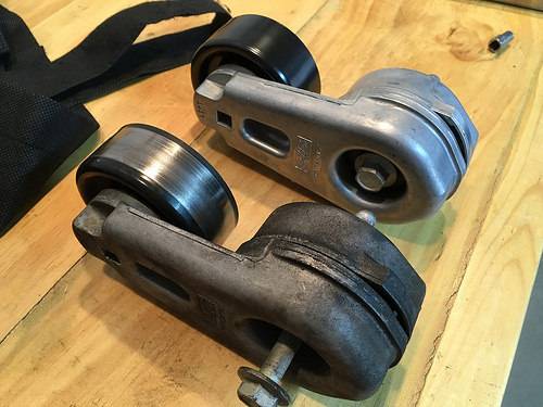

Devin, I changed the belt, pulley and the tentioner last night and on a somewhat cold start this morning my clanking noise has subsided. The old Tentioner actually didn't even want to move when i went to remove the belt so much so that I was forced to cut the belt off. I suspect the old Tentioner was my problem. I'll still be listening and on the look out for this sound over the next bit.
At one point I honestly thought the noise was coming most notably from the DCCV solenoids. Thought it was possibly the A/C clutch also at one point.
Noise is gone is all that matters to me.
GL
Thanks for the Update BigRig, I spoke with another LLSOC member and a mechanic friend of mine. The three of us have also decided I will start with a tensioner/pulley. (by pulley do you mean the pulley on the tensioner? Or did you replace a separate part?)

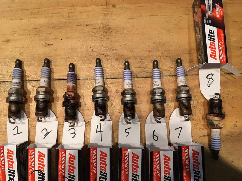

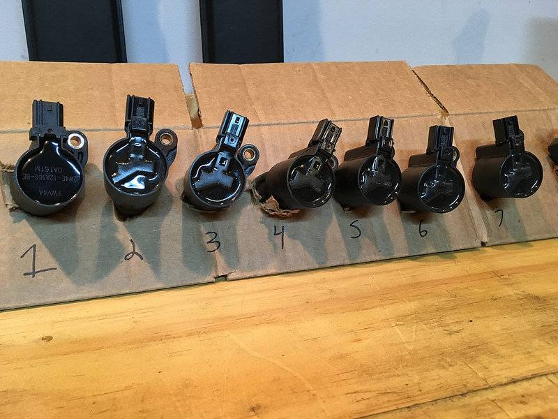

But the luck was short lived - I have noticed the car has been "chugging" lately under medium/heavy throttle, at lower rpm. Usually when cruising on the highway or winding it out uphill, on ramps, etc. Almost felt like the tq converter or trans was engaging in/out, but no cel, no other symptoms. Just noticeable vibrating and jerky acceleration every so often. I even started to think the K&N intake was causing turbulence and irregularity at certain throttle inputs. But tonight the problem keep happening, to the point where no matter when I was on the gas it would do it. Idle got rough, leveled out, repeat. Eventually, the CEl starts flashing when the car was sputtering as I pulled away from a stop, after the flash it stayed on and I was able to get home alright, but had to use light throttle the entire drive. Smell of rotten eggs (cats) was present after the misfiring.
Scanned it when I arrived home and got: P0300, P0301, P0302. Cyl 1&2 misfires. I knew I was on borrowed time with this car being on 7 original coils. (one replaced with the previous owner, and all 8 plugs done at that time) But Man - I did not think I would get cooling parts, rear deck speaker, coils, and a window regulator all in the first three months with her. Trans is probably next with this luck streak I am on!

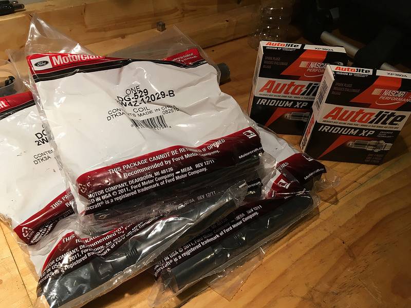

Here is what I know: Get all 8 new motorcrafts. Get new plugs for all 8 at the same time, and set the gap to 1mm. (thanks to Joegr for his daily post in any given thread).
My questions for the group are:
1) How often do coils fail without a VCG leak or cowl cover water leak? Is it possible mine died of old age?
2) Car still has ESP coverage, so I will take what I can get from the dealer, but my guess is I will be out of pocket for 6-7 coils, plugs, and who knows what else based on what they want to fix and cover for this. Does anyone have any good advice or an experience to share regarding coil pack failure and how to manage this with a dealer and ESP plan to minimize cost and maximize the repair? - I have no problem fixing the rest, but I am almost hoping the VCG leaked and that will get fixed, allowing me to buy the other COP's and plugs and swap those out myself. The tech I have gotten to know is very familiar with the LS and the COP/VCG job, but again, not sure how to approach this so that I can obtain the best benefit while under ESP care.

Got the car back this morning. COP #1 was replaced under ESP care, #2 & #3 did not fail the stress test, per the tech, and therefore would not be covered under ford. No Oil leaks found in any of the 8 plug holes. I am ordering 8 plugs and 7 COPS and will fix the rest on my own shortly. Just want all done at the same time. To do one at a time at the dealer, would cost me 2x as much if I had to do all of them that way. Would rather spend the $$ now and know that they are all new.
-dev
I would take it back so that they can replace plug #1... if the coil was bad, then so is the plug, it could be damaging the new coil right now.

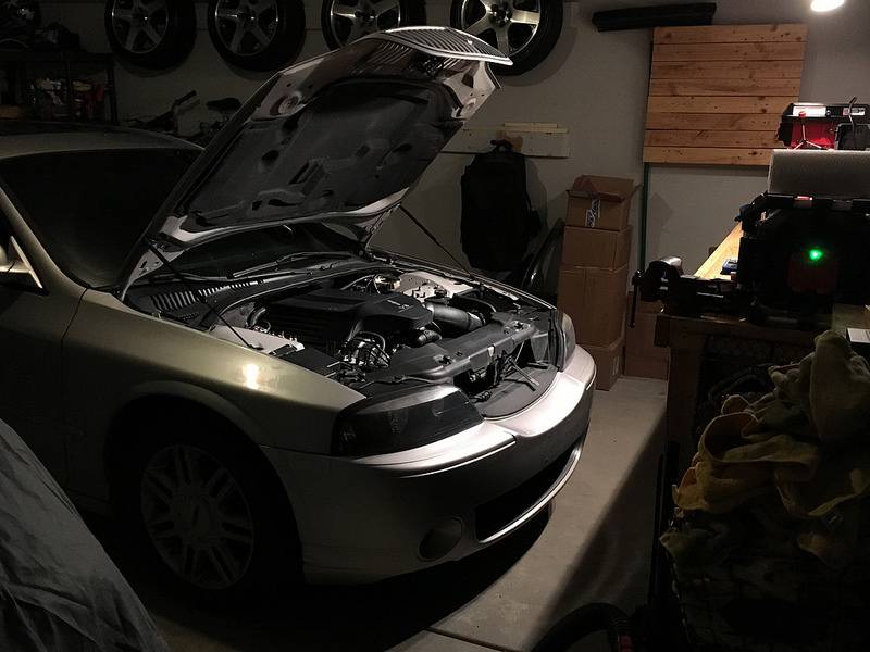

Fuel filter, Coils, and plug swap done last night/this morning. Some good news, some bad.
Good:
1) Job was not as bad as I anticipated. Various threads on here to thank for preparation (tools needed, etc) - thanks LVC!
2) No oil in any plug wells, but some on the plug threads of #3 and #8.
3) Replaced coil cover bolts, and am happy with the turnout.
4) Car runs like a champ!

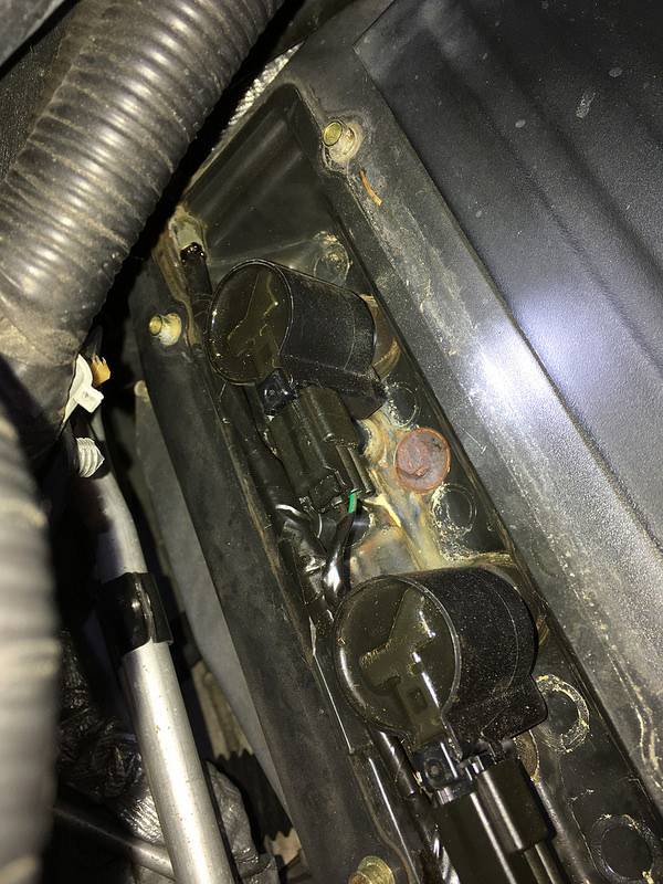

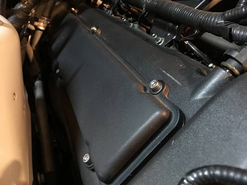

1) The car clearly has suffered some sort of water intrusion from either faulty sealant application on the covers, or just typical LS cowl water leak/intrusion. Passenger side shows water stains, rusty valve cover hardware, and this was the side of the recently failed #1 and failing #2/#3.

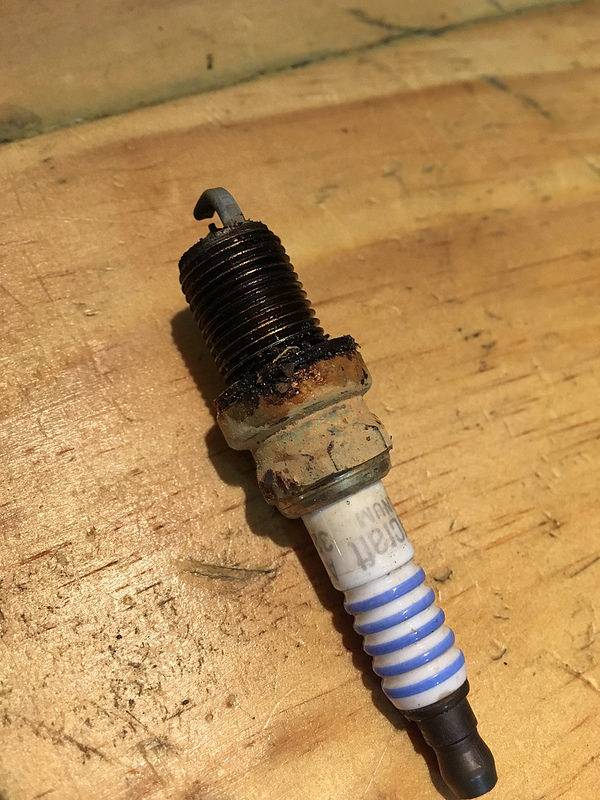

2) Cylinder #3 and #8, showed nothing in the wells but hardened oil at the base of the plug (not fresh or wet) and some buildup on the plug threads and base.
3) I broke #4's coil electrical connector when installing. It just snipped off like it was nothing.
4) Witnessed the water drip DIRECTLY onto the p/s coil cover after my test drive. Nothing new to the LS crowd, so back to part ordering I go.
Fresh parts:
First sight at #3 & #4 - indicative of a water leak.
Old coils: #1 less than 100mi on it, 2-7: 74K, #8: 20K or so on it.
Old Plugs: 20k or so, done when #8 COP replaced by prev. owner
Close-up of #8's plug (YIKES!)

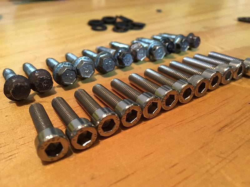

New hardware - Old ones pictured, were dirty, rusty, and slightly stripped. Stainless M5x20, .80" pitch.

I sealed the coil-covers with fresh rtv, and then ran some extra over the outside of the wiring after they were bolted down. While I feel good about the seal as it sits, I need to get this leak fixed. After the test drive, I glanced under the hood and was able to observe the drips - Passenger side.

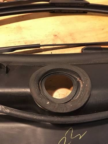

I will order the wiper shaft seals (5W4Z-54021A46-A), and new cowl pins. Anything else you guys recommend for chasing down this water leak?

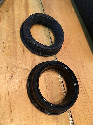

Replaced the old seal last night, Looks like I also need some new stripping near the cabin-air filter cowl drains. The old stuff was all broken-down and flaking like a croissant. So I do not thin my leak is fixed yet, but definitely getting there. Anyone know where I can grab some new metal clips for the cowl seal? A few of mine are not sticking like they should, and This appears to be part of my problem.
Old seal:

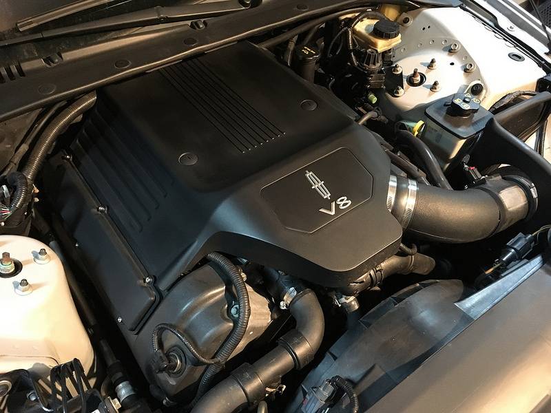

Quick video of the intake, after COP/plug install.
[video]https://flic.kr/p/FoYGsw[/video]

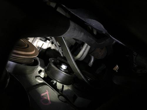

Got the Tensioner, Idler pulley, and leaky VCT seals done today. Install wasn't that bad, I got the LS on ramps - did the belt removal from the top, and the two components were unbolted and removed from the bottom. About an hour's worth of work. VCT seals took 5-10min per side. Intake went back on and I was off for a quick victory drive.

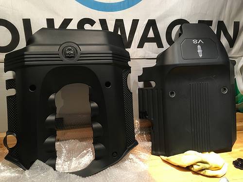

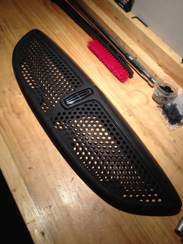

Picked this up this week too (Cover from 4.2 XJ) Anxious to start this project!

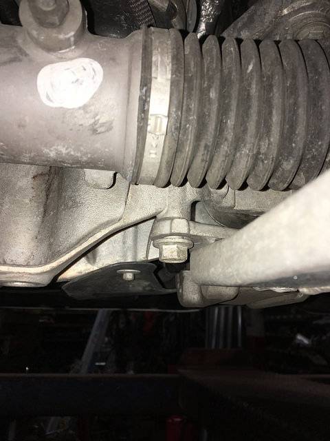

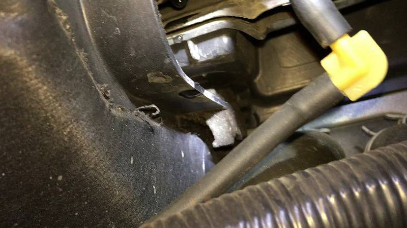

Question for the group - The aluminum chassis braces underneath the car. Is there supposed to be a gap between the bar and the shoulder/collar of the frontward bolt that keeps into bolted to the body? (near the rack) See picture below. I will check the manual tonight for tq spec, but it is one of the things I noticed while the LS was on the lift.

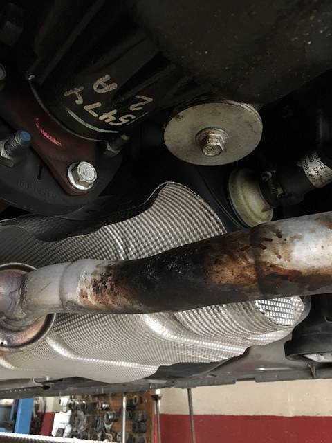

Lastly - Can you say bad diff seal? (yikes)
Video soon of the exhaust, will probably dump it in the LS video thread as well once I get around to it.
It's a shoulder bolt, It can't screw in any further. Do not exceed the spec'd torque.
Thanks guys! Had bolts similar to this on my last car(s) so I assumed as such, but definitely wanted to check with you all.
That cover is going to look SWEET! Where did you locate that?
Side note, has anyone done any cover modifications like this to a 1st gen?
Anxious to hear the straight pipe...
Thanks, LKQ vendor on ebay $50 shipped to my door (they did an excellent job wrapping it in bubble wrap) Search 4.2 Stype or XJ v8 engine cover. Usually a few for sale at any given time.
Found one - EXAMPLE LINK
Yes - Mike H. has done a hybrid of an LS cover, using the Jag middle section.
