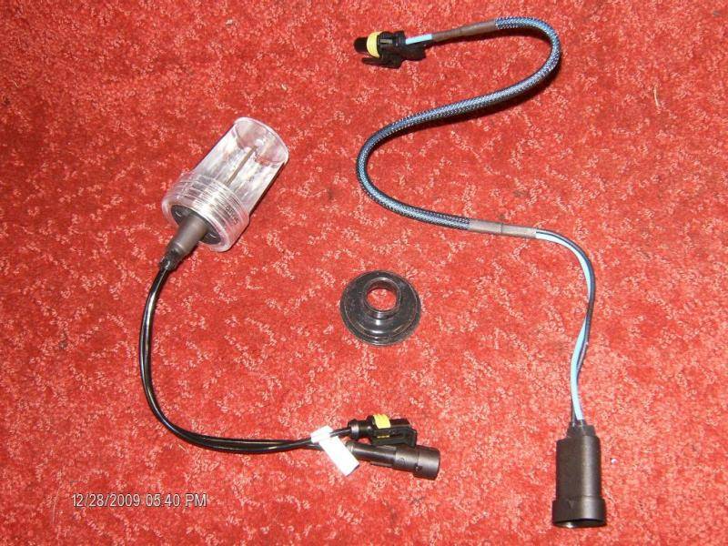

Hey DLF, I'm having some issues with my recently purchased adapters. I bought a ddm tuning HID kit. I need to first put the bulb into the housing then use the adapter over that to secure it, correct? Because with the ddm kit, the various pig tails behind the bulb are too large to go through the adapter. Do I need to splice the wires behind the bulb in order to get it in there?

I've never seen the DDM bulbs, so it's hard for me to comment. I was able to put the bulb pigtails through the center hole in the adapter one at a time.
Rather than cutting the wires, you'd probably be better off enlarging the hole.

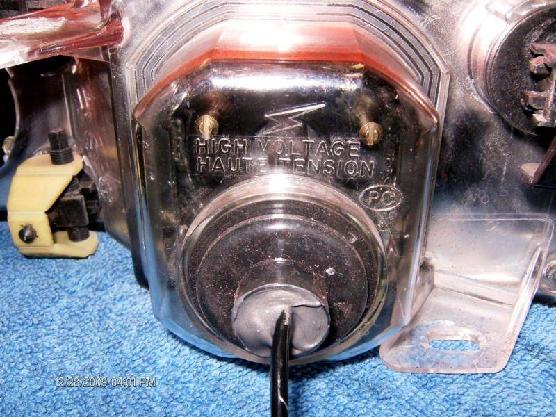

Here are a couple of pics of my bulbs. I had to remove the large grommet to seperate the bulb from the rest of the wiring in order to use the adapters and finish wiring up the new ballasts. I then used the grommet to seal the back of the stock HID cover.

I'm trying to get some pics uploaded, but mine is pretty similar to that. How'd you get the gromett off, and how'd you reseal it later? And now I'm confused with the wiring, that large pigtail that is on the bulb side of the gromett, (part of the piece that you completley removed to get the adapter on, the light blue wire in your picture) Where do I connect that?

Completely read my post on LOD that I linked in your other thread.
