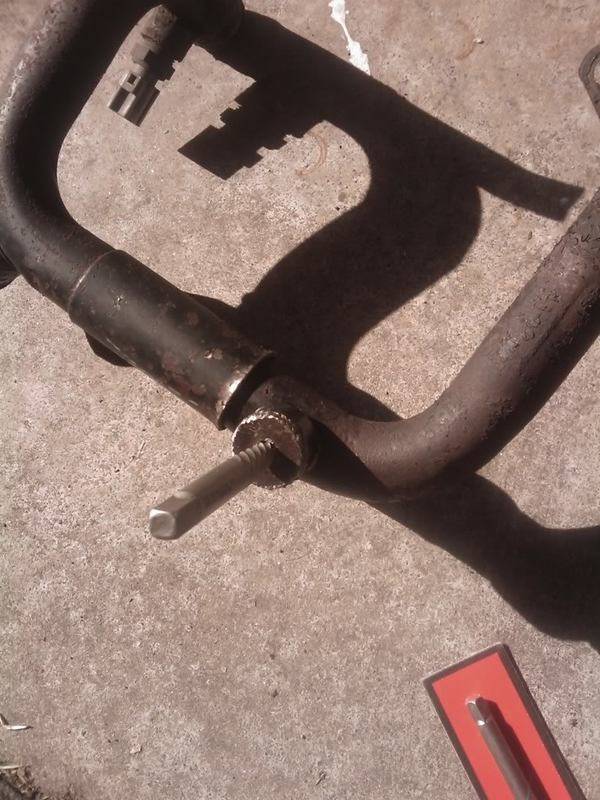

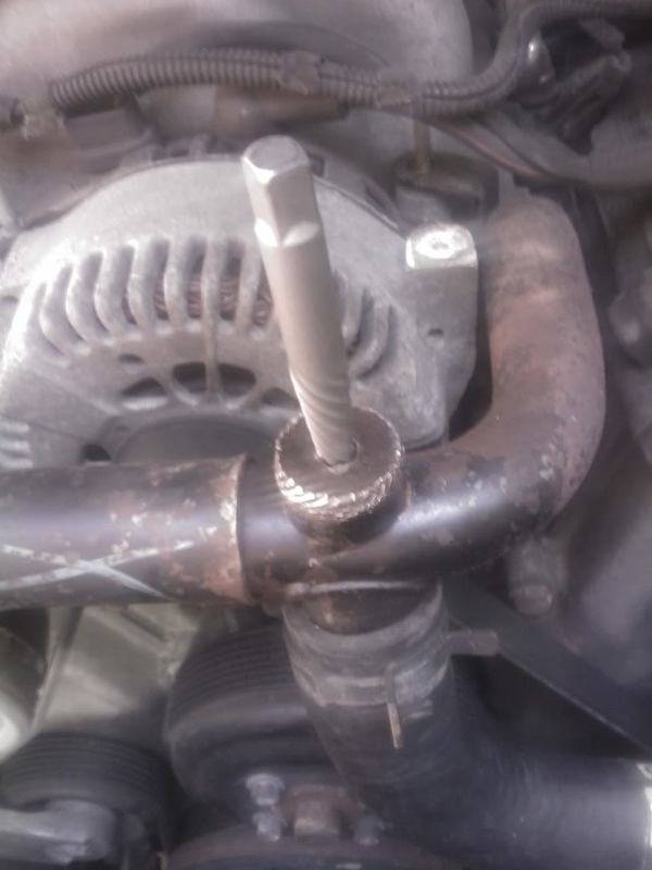

Ok, got an easy out. ( screw extractor is what 'this' is called at sears ) Not exactly what tommy described but functionally the same thing. Got it in there and it bit pretty well. I still couldn't get the damn thing off though. Since it was leaking at the point where it goes into the engine I pulled the crossover off.

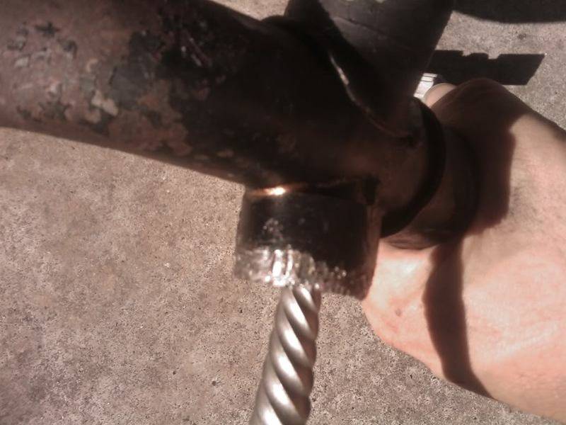

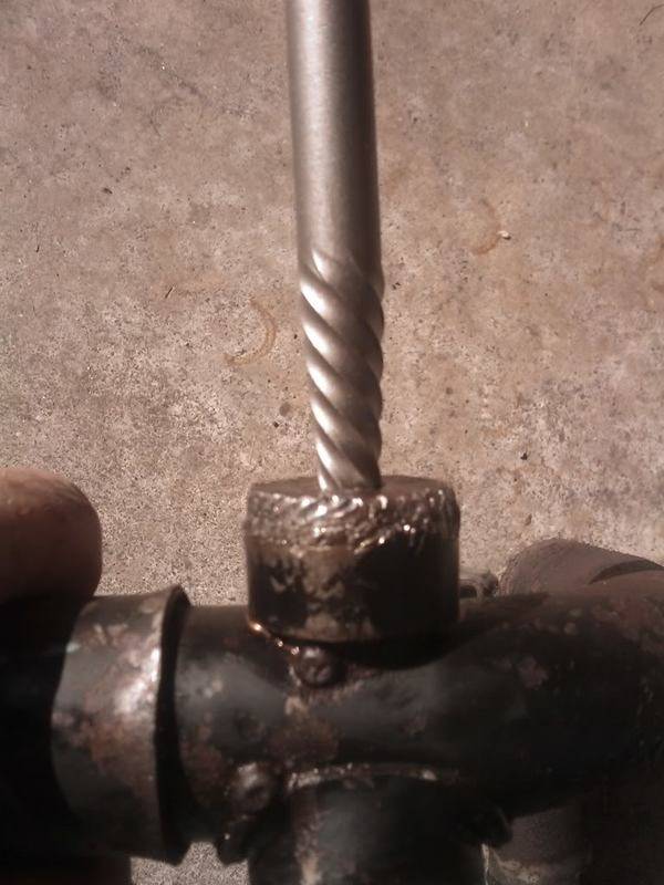

Now I have it off with 2 different size easy outs and a pipe wrench. I'm going to need a vice of some sort to hammer this thing in and get the easy out to bite. If you look at the side of the pipe where the screw goes in (at the base) you see a spot of brass (?) that looks shinny. Worried this might be stress related and don't want to crack the pipe.
I'll torch it down. Put ice on top and try the easy out. Then the pipe wrench. After that I'm back to square one.

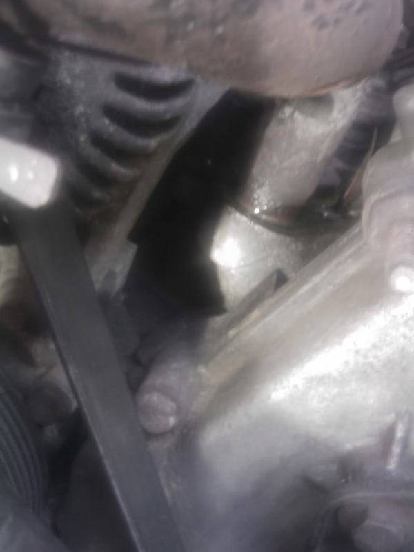

Here are some pics.
Where it was leaking on the right side.
I'd forget it now - you've chewed up the top of the pipe itself. Find another crossover in good condition.
