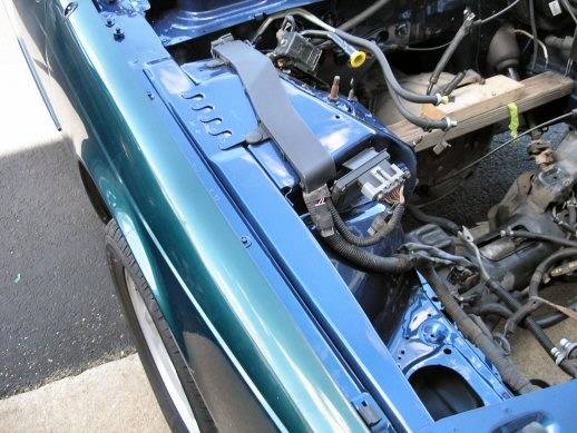

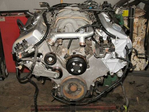

pic 1: vista blue
pic 2: driver side inner fender

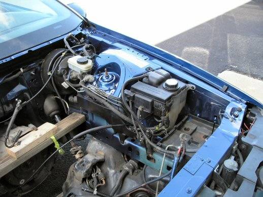

pic 3: passenger side inner fender

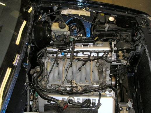

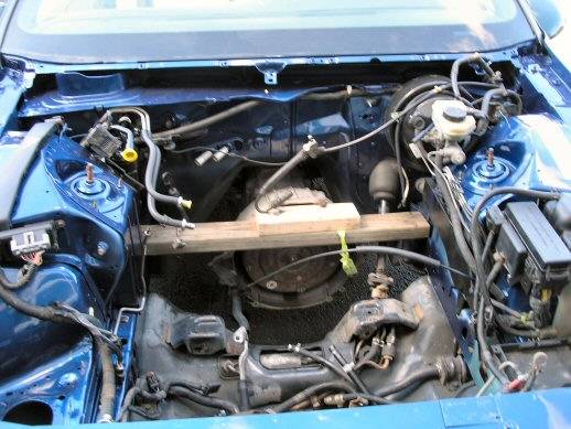

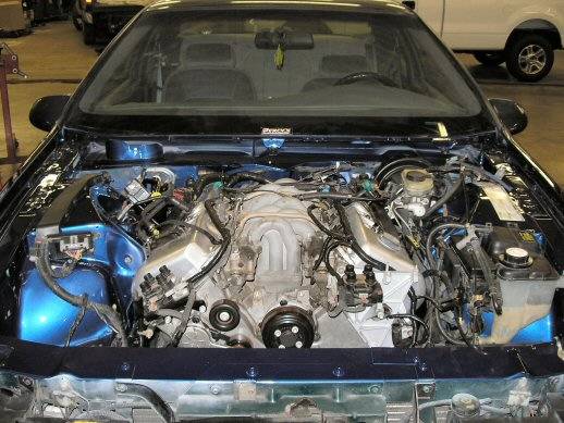

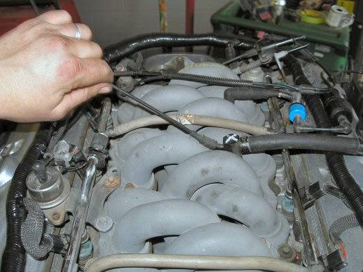

pic 4: where does this vacc line go to on a 95 markviii?
pic 5: hope its wired right lol!! just kiddin eric lol

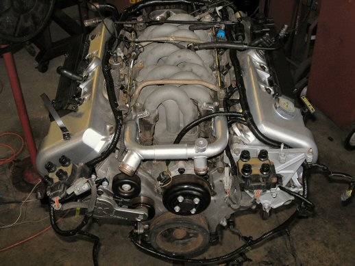

pic 6: fully loomed, ive been crosseyed for the last few days but sure is purdy
pic 7: nice loomed harness no more ball-o-wires
pic 8: purdy bulk head and main loom, and NEW iac and tps cuz i dont wanna have to touch this when the eng is in

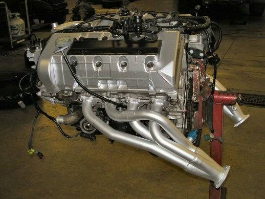

its came a long way and the eng should be sitting in the eng bay, with the headers on tommorow wont be runnin till a few more parts come in but its going good, and if i rember to take my camera cable (house and dog sitting for my parents)i can upload pics over the weekend of the progress if not it wont be till next week

Mines a 96 thou...looks like driller has a line on his in one of the pics in the intake r&r thread and his garage.
Better ask a pre OBDII guy.
Vacumn line goes into a vacumn canister in the inner fender cavity on the passenger side. then runs to the HVAC unit in the cabin.
Mike
See in 96 they just moved it to feed off the main vacuum line. Does the same thing, just find the heater canister and provide the vacuum. Your heater vents will get whacked without it.
In the last pic you can see where your line is coming from in the top right corner.

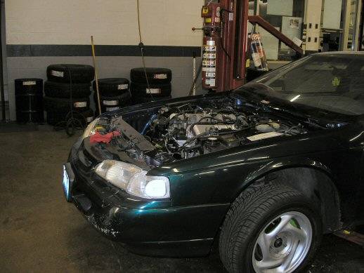

and............................................................................its in the hole!!!!
not too much hooked up yet had to fight the headers in and everything fought the whole way down but finally it went in, but after working a 8 hour day then doing this for 5 hours after that.

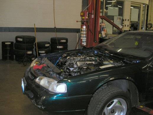

No new pics, but the SCT progammer is on the way, the heater hoses and ac lines are all installed, the main starter wiring is done. The rad hoses, rad and fan, throttle cable, cruise cable, fluids and some crossed fingers...DOHC POWERED!!!
