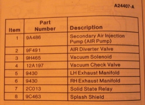

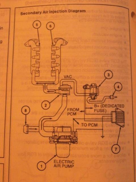

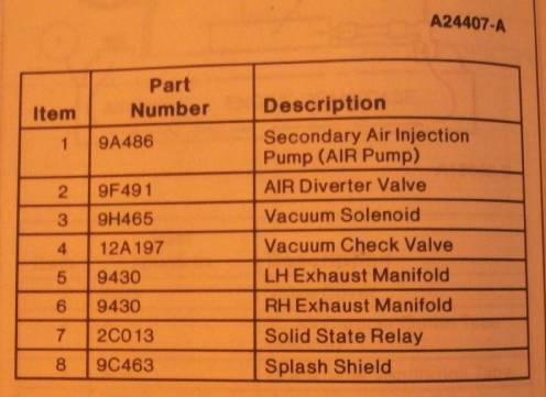

nonetheless, I'm not ready to quit just yet. In a '96 manual it's diagrammed in 03-08 and I'll post pix after work. It's a much simpler system than on the LS noted above here.
The secondary air pump has an inlet and outlet, in from fresh air and out goes to AIR diverter valve just between the radiator and in front of the main crank pulley.
The diverter valve is supposed to have 3 unions:
1)in from the pump,
2)out to the exh mans/cats and
3) one going out to the vac solenoid.
My diverter valve looks like it just has two hose unions: in from pump and out to exhaust.
Does anyone have a picture of their AIR diverter valve for the smog pump to compare? I think 96,7,8 are the same
