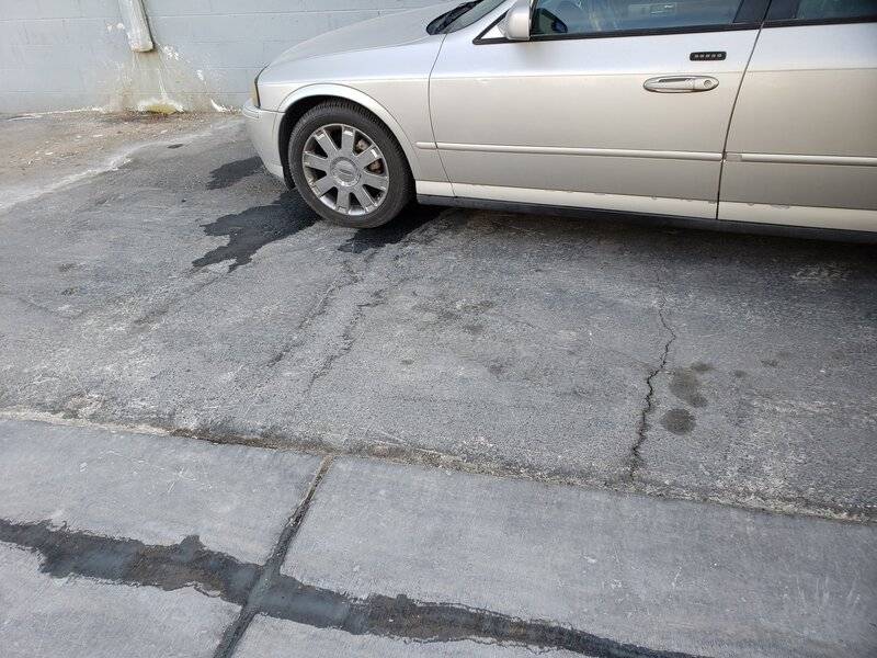

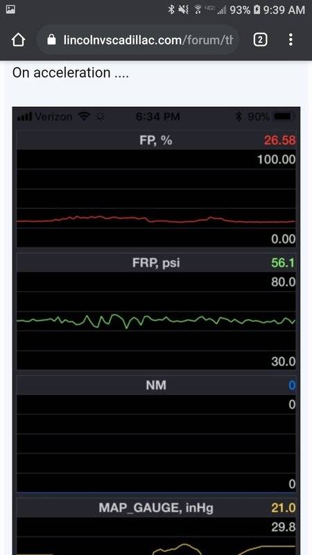

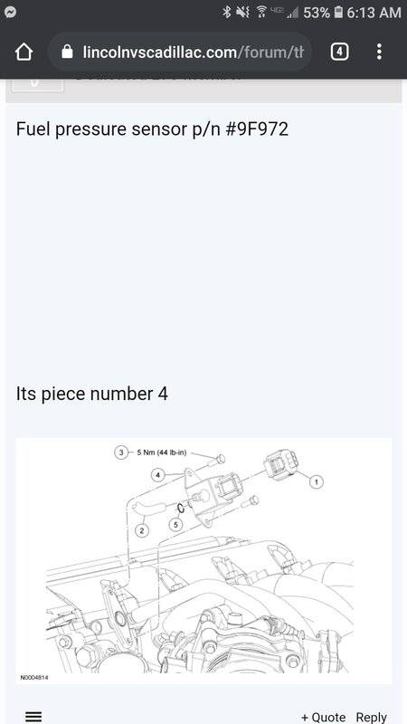

          Well I guess I didn't explain it right maybe, like it has power most times but when I accelerate it does so normally more so when first started and cold, like it'll lose power randomly sometimes after it's warmed up. I'll be accelerating and then it'll just kinda stall but if I let off the throttle it will go a little, kinda like the further you push the pedal the less power it has and slower it accelerates, if you accelerate lightly it'll go a little bit. But then if I stop shut it off turn it back on it'll go good again for a while.
          The p0190 code was talking about fuel pressure sensor I think. I'll drive some more and see if that code comes back, haven't been far since fixed other stuff and reset codes, but it did stall already which is why I'm gonna try filter first.

          If you have Forscan can you post some Fuel Pressure readings from dashboard live feed ...I could do some comparison

          Forgot to mention there is a Misfire count on Forscan Dadhboard live feed as well ...You xan download the Forscan Lite on your smart phone around $5 dollars and buy a bluetooth adapter cheap from Amazon

          They didn't have it tight and they had the wrong seal on the top so it leaked gas out of the top of the tank by plastic ring, I put it in the correct seal and tightened it correctly.
          Yeah I have forscan but not sure how to use it right. Was looking for the misfire account cuz I read about it in a different post but I was unable to find it yet. Need to spend more time on it. Got wrong Bluetooth adapter, but I have a plug in one for my laptop as well. My Bluetooth adapter works with torque lite but under the fuel pressure section it says no data, I'm gonna have to figure out how to use forscan I guess. Thanks

          It should look like this

          NM = Number of Misfires

          This is what it should look like when the car is accelerating

          Code p0191 showed up now also,
          The dip is where was accelerating, it definitely went lower pressure than yours, I saw down to 17 or so, it didn't run or shift correctly on this run, when I accelerated to the floor and the RPMS went up but it never did shift, kind of didn't have enough power and just kept the RPMs higher but wouldn't shift right, only a short run though, it shifts if I give less throttle.
