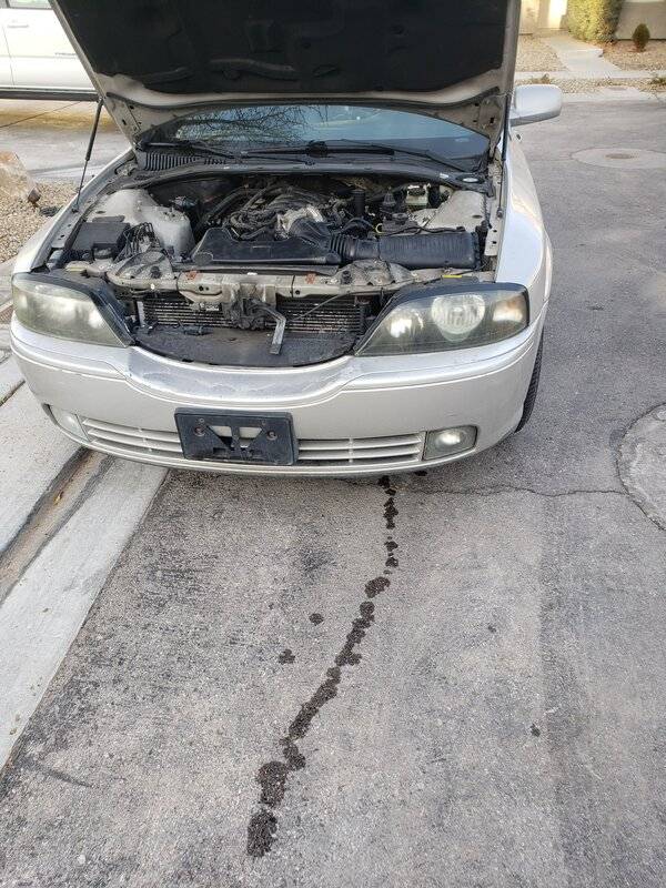

Going system is all brand new, still leaks, love this car, lol
Whole thermostat housing and downpipe, I did get a new bottle but I haven't installed it yet cuz it's not where it's leaking im pretty sure, it's leaking from the thermostat housing that stupid little downpipe with no clamp I think. Total shit design. Or maybe the block is cracked. Coming off of the middle of the engine in the back, they say it runs down from the front thermostat housing under the intake manifold.

I've been driving it about a month an a half and put prolly 500-600 into it so far, I just carry a few gallons of water in the back seat and pop my cap and relieve the pressure when I get where I'm going and then I don't lose much coolant. Perfect for around town but she ain't no good for a road trip. if I don't take the pressure off she'll puke out a quarter to a half a gallon, doesn't seem to have as much pressure as it used to a month ago though and it's got a lot of new parts on it now. starting to piss me off though, I might just sell it to some other sucker and buy something else that's easier to work on, everyone is cram packed so tight in there. I'm going to have to go buy some tools I don't have to get the covers off my driver's side spark plugs, need a flexible knuckle or bendable gear wrench to get in there, my trucks gonna be fixed before this thing is at this rate, haha

It's just so hard to see where it's even coming from, it's under the throttle body there somewhere though I'm pretty sure.

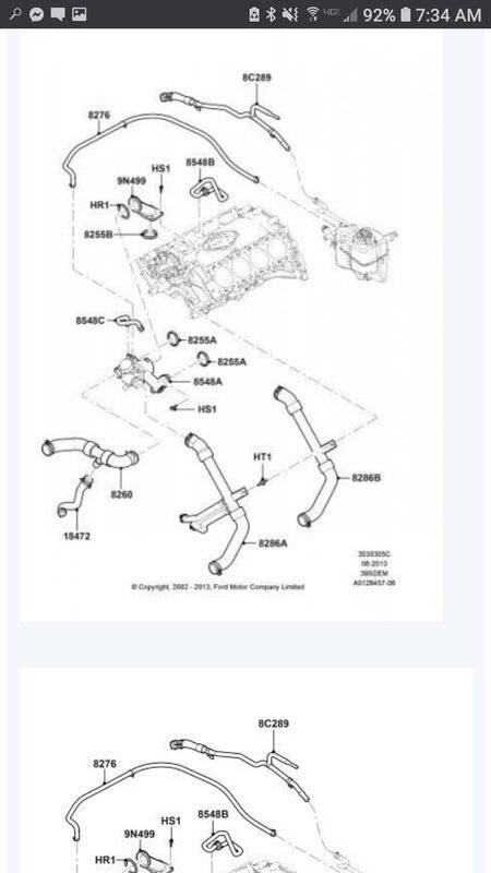

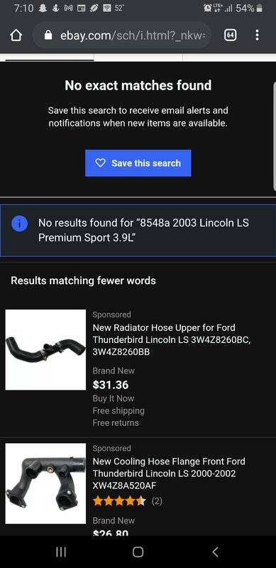

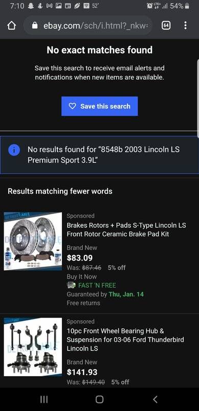

You happen to know the real part number or description of that hose? 8548 a or b don't find anything and telling AutoZone it connects to the throttle body and block doesn't help them find it either, thanks.
You might find it on ebay

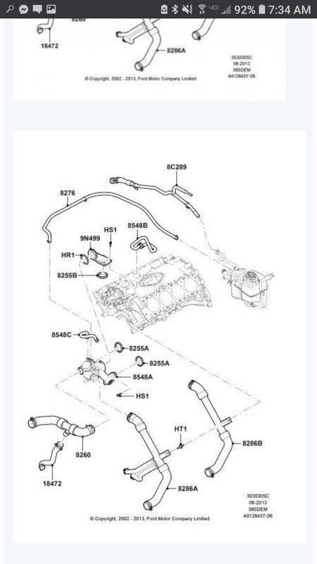

" The difficult part (for me) in dealing with Tasca is they don't or did not list the right part numbers. FordPartsGiant was about 10% higher in price, but listed the parts numbers.
Upper radiator hose. 8260 - 2W9Z-8260-GB
Lower radiator hose. There is a long plastic section in the middle. (w/ Oil Cooler): 8286A (KM-4677) - 3W4Z-8286-CB
Hose Under Intake Manifold: 8548B - 4Z-9F814-AC
Hose: 8548C
Hose HVAC Heater Hose (Upper Hose to DCCV): 18472 (KH-166)
Thermostat housing. This is the part with the thermostat twisted in, the fill cap,... Also called Water Outlet: 8592 (RH-134) - 4Z-8592-AA
Thermostat: 8575 (RT-1163)
Engine Fill Cap: 8A511
Plastic Elbow (underneath intake manifold): 9N499
Main Plastic Body: Attaches to the Plastic Elbow (backside) and, the T-Stat Housing attaches to it (frontside): 8548A - 4Z-8548-AD
Top O-ring for the 9N499 to 8548A HR1 - 707299-S300
Bottom O-ring for the 9N499 to engine block 8255B - 4Z-8255-CA
The 2 O-rings from 8548A to front face of engine block 8255A - 96JV-8255-CB
Large O-ring from 8548A to 8592 8590 - 2W9Z-8590-AB
Intake Manifold Gasket 9439 - 9Z-9439-AA
Degas bottle. (Need hoses) 8A080
Belt Tensioner 8676
Serpentine Drive Belt 8620 "

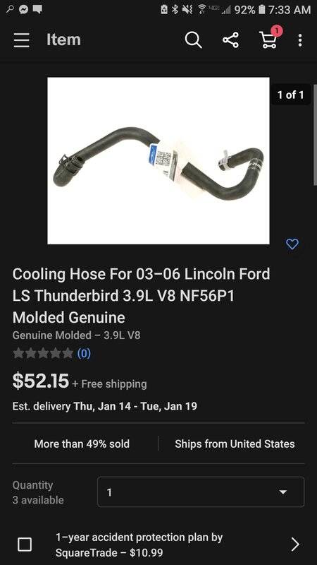

I'm not 100% sure that hose is correct on ebay but it looks like the one you're looking for I think

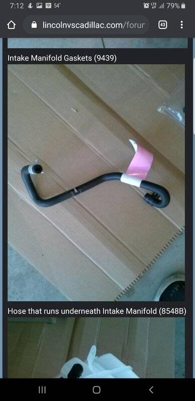

There's a good thread on here (created by SoulSoak) - search for it - it has every part number, price, location, and pics of how to change them for all of the cooling components maybe with the exception of the radiator.

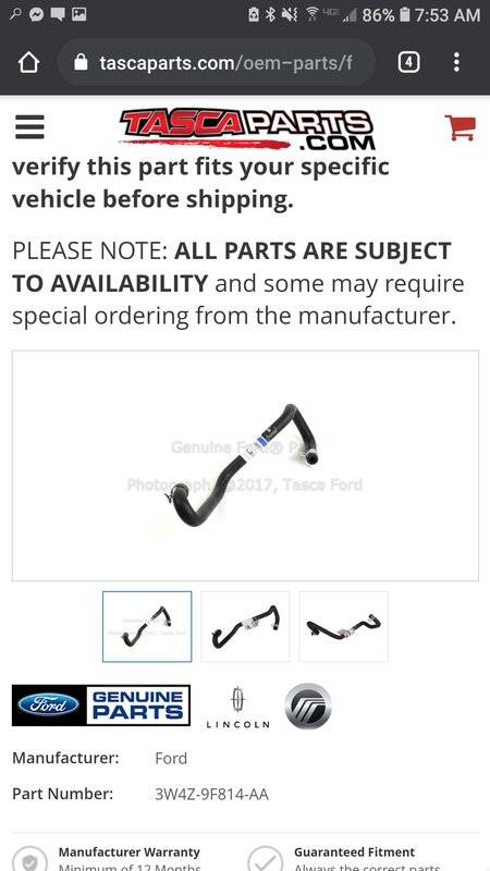

4Z-9F814-AC still doesn't find on Rock Auto but it brings it right up on Google anyway with pictures and everything, thanks.
Hopefully AutoZone can find it now cause I'm actually trying to source it locally instead of wait for shipping because I lose about a half a gallon or more in about 8 miles of in town driving, got a feeling I'm going to need a few more of those parts on that list too so thanks a million. Lots easier to find when you have the right numbers, or whole number if that's the case it looks like here
Actually I think this is the right correct number from Ford, in your last picture, finds even more results, thanks.
3W4Z-9F814-AA
Actually that number still won't find it in a parts store, but it finds a bunch of online sources, maybe online is the only option. Thanks again.
