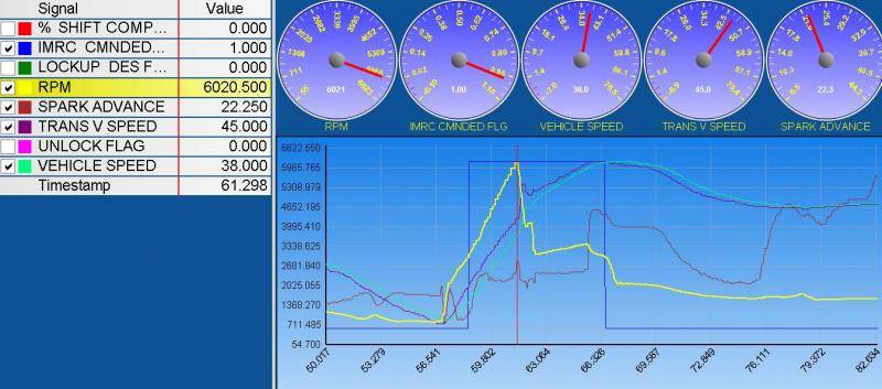

You can see from my logging below, the WOT shift to 2nd (rpm yellow peak) spins the tires (the speed and rpm trace jump up a bit) and I don't think I need the shift any harder. I will try it eventually though.:D
