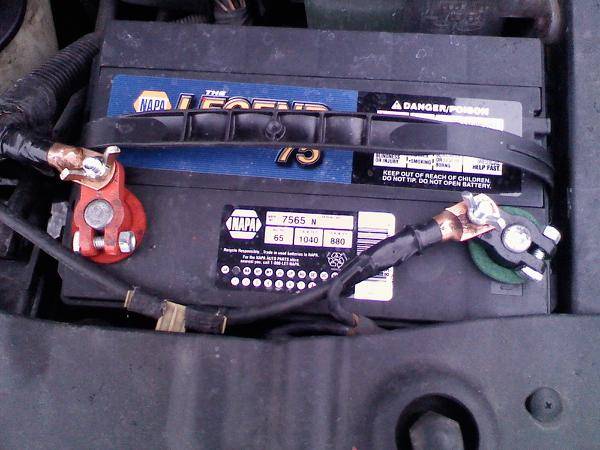

The positive battery cable underside is jacked up and was not allowing connection. Despite that inspection of it and removing battery clamps and putting back on several times. My bro has experience with re-doing them and putting in eyelets, we will solder them on tomorrow.

So it was the connection at the battery terminal. w00t
those freaking crappy clamps... it isn't the first time..and it wont be the last.
I take them off my cars literally upon delivery...and replace with larger better contacting lugs.
If you look at those band clamps they aren't even solid, they have gaps in them that allow corrosion and do not provide a good contact with the battery post.
we are going to eyelet it as son as weather allows - you and many others above are correct, and I am held with negligence...my apologizies...

not pretty - but Im sure LBD won;'t be having that problem again!!! My bro in law and his bro, with a little help (very little!) from me, really hooked it up!!! Whatcha think: they soldered the ends on really tight and swapped out the clamps for pinholes. They are both truck drivers and run a farm and redo all their battery connects like this. Despite the lack of length on the posi cable, they were still able to get amount for the solder. Gotta love good ole country boys!!!
