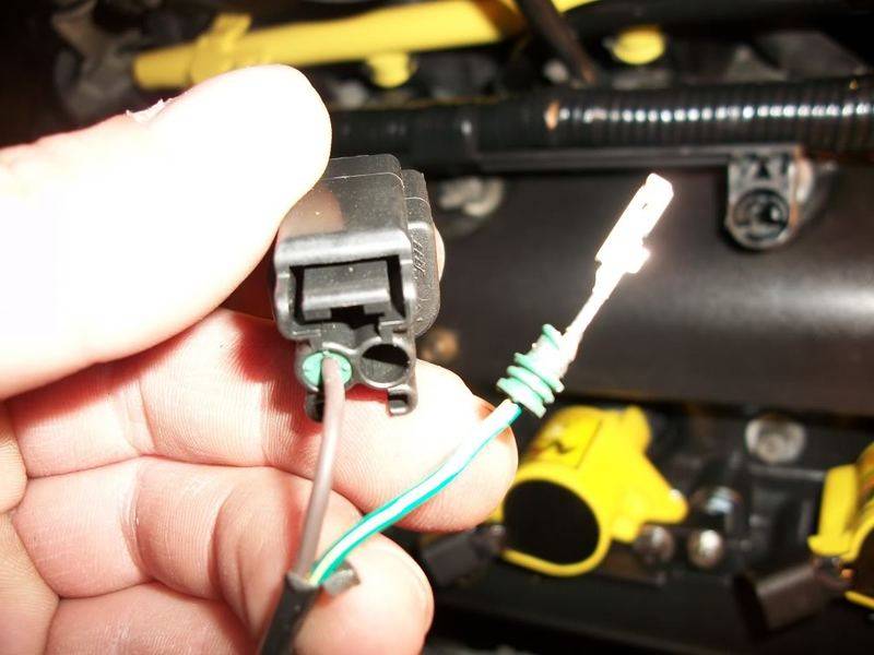

MMAFIGHTER's sig is correct. In order for these COP's to work you must switch the wires on all 8 COP connectors. Here's the thread about how to do that. http://www.lincolnvscadillac.com/showthread.php?t=73132&highlight=coils However...in the thread he pryed up a few times on the red retainer clip, I broke my first one that way. If you pry up one click and grab the middle part of the red retainer clip with some needle nose pliers and pull it out, you are less likely to break it.

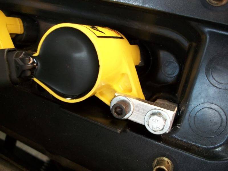

I have had my Accel's for a month or so and they are doing great so far. I have tried several brackets for mounting the COP's and have finally perfected the brackets (patent pending...j/k) with some 1/2" aluminum I had left over from work. I have tried the Accel boot in several different positions to get the best fit in the plug well and had the best fit being the way they came out of the box.
So i cant seem to find the second "clip" that's preventing me from pulling out the little connectors/cables or w.e they are called.
Help...please....

Finally got these working. Thanks MMAfighter for the help, and the other guys who had write ups. Now shes running great. In fact she's running so good, that i call her the mustang gt killer :D... just wishful thinking lol

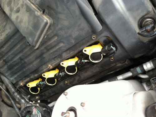

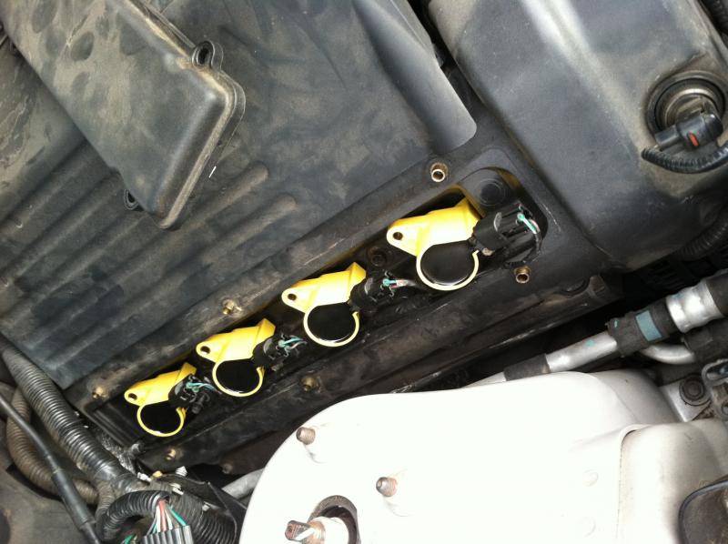

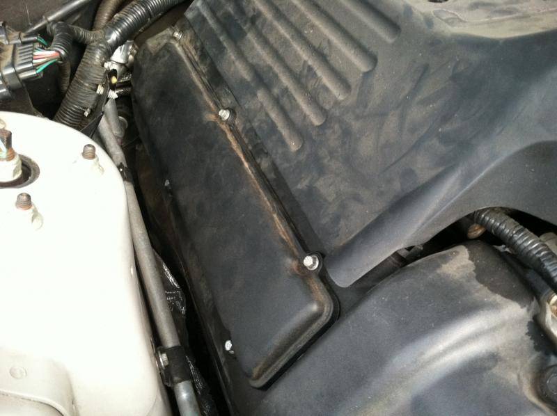

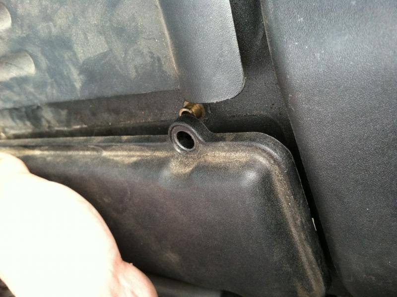

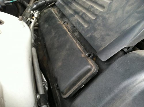

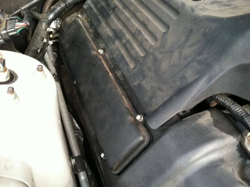

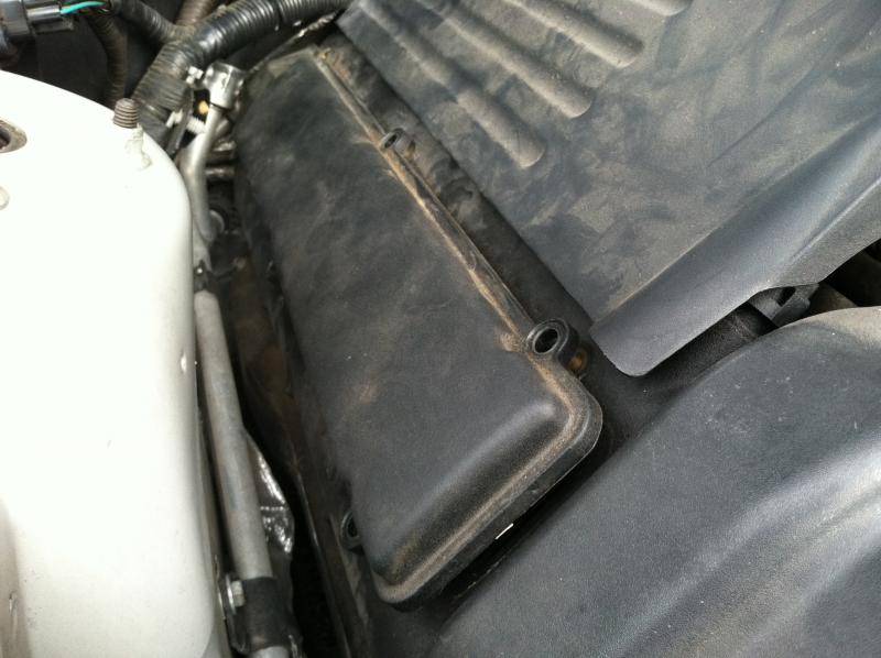

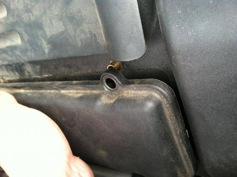

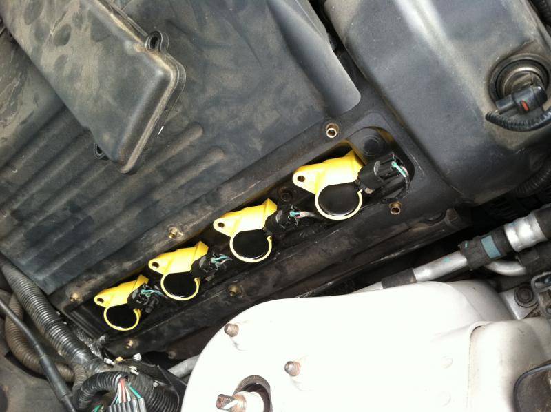

I just installed these today and I was able to use the stock covers. I placed the covers over the coils to see what the difference was and they where only about 1/8-1/4" away from seating correctly. So I pushed down on the cover and it sat flat like it should. There wasn't much resistance. All bolts screwed in without issue. Ill run it as is for a week or two and then I'll inspect everything. Thoughts?IMG_3891.jpgIMG_3892.jpgIMG_3893.jpgIMG_3894.jpg
Did you modify the connectors in any way?
Nope. I used the stock coil boots though, which are a bit shorter than the accel boots. I placed the coil plug in the same orientation as the stock coils (toward the front of the car) to keep the harness in its original location. I didn't use anything to bolt the coils down. With the cover on, there's nowhere for them to go. Not to mention the cover is pressing down on them slightly. I drove it around last night and all day today without issue.
Like I said, I didnt have to force the cover on. I simply pressed down on it slightly. The cover ends up pressing the coil so that the plug is parallel to the cam cover like the stock coil plug. Since the boot and spring are flexible, there should be no problems. The actual coils are the same size as stock. The only reason why there is interference with the cover is because the accel plug is at an angle. From what I had read on here, the threads made it seem like the reason the cover wouldnt work was because the coils themselves were larger, in addition to the angled plug of course. Has no one else even attempted to reuse the coil cover?
nope, one member cut into the coils and used epoxy to "straightening" out the connector so its no longer at an angle
most people were just not comfortable with the extra force being applied to the coils connector...
I read through a lot of threads before doing the swap. I didn't want to modify the connector. I was planning on bolting it down like some of the other members have done and leaving the coils exposed. That was until I realized how little effort it took to just put the cover on.

Did you swap the wires in the plug??
