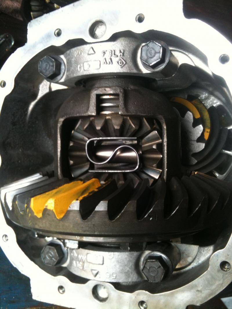

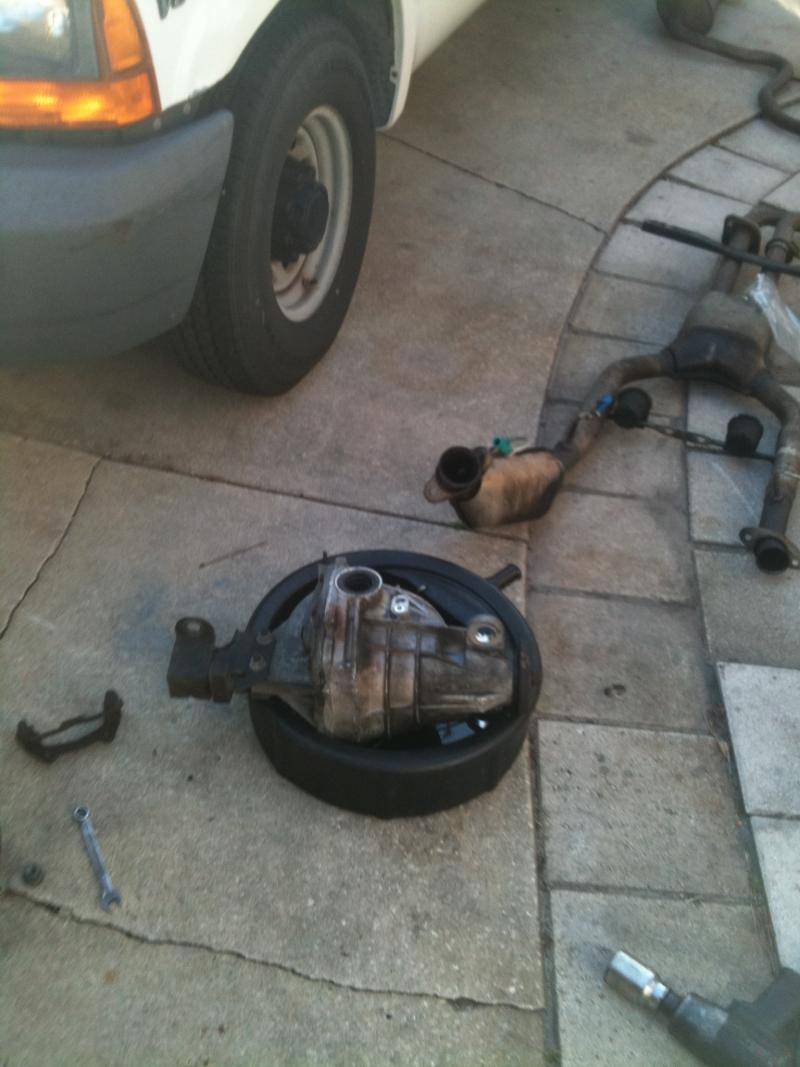

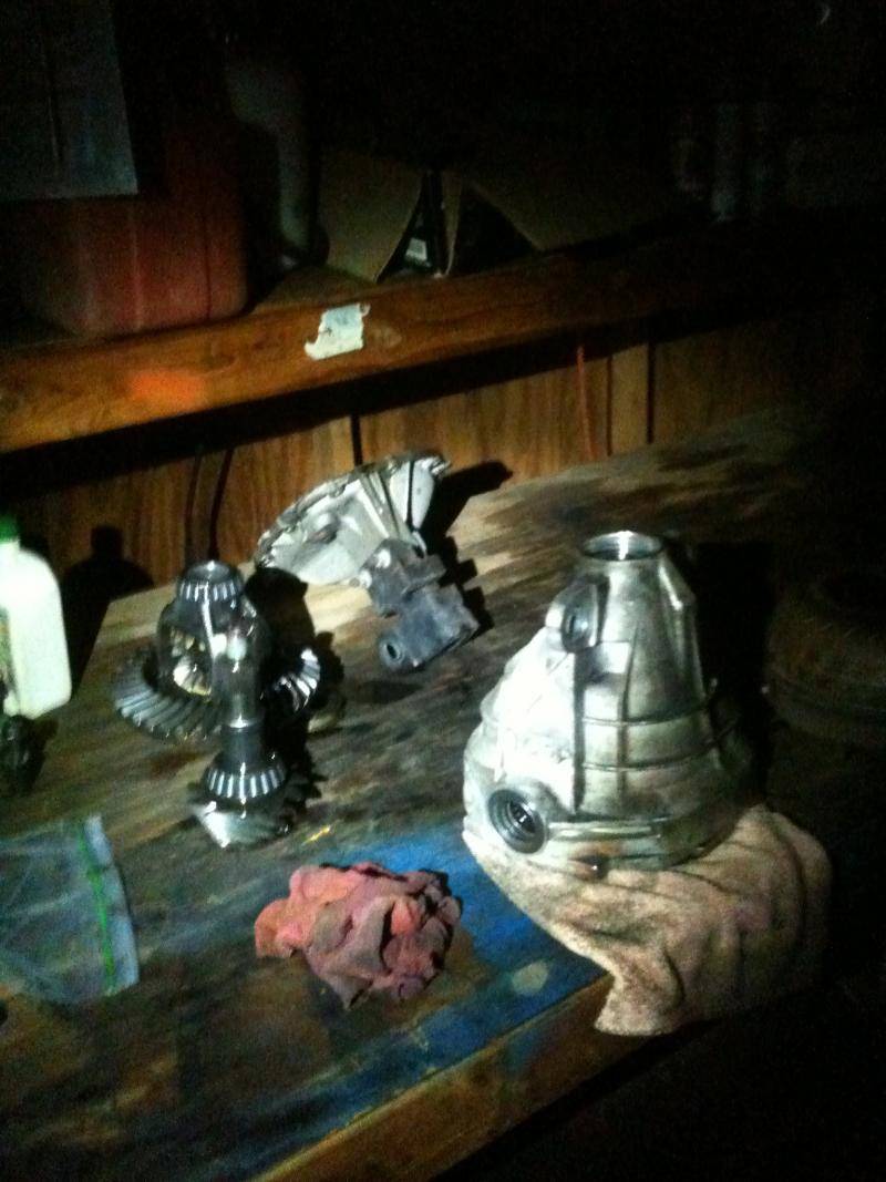

not today had class then had to get caught up on class work.... did find a bad bearing in the diff, it is blue from heat!!!! it was low on fluid after i bought it :( now i have to get to work
Yeah they do that sometimes. I gave sapperfire my old pumpkin so he could just put one together to slap in his 93 but after pulling it apart both sides bearings were severly over heated and even dammaged the housing. :eek:

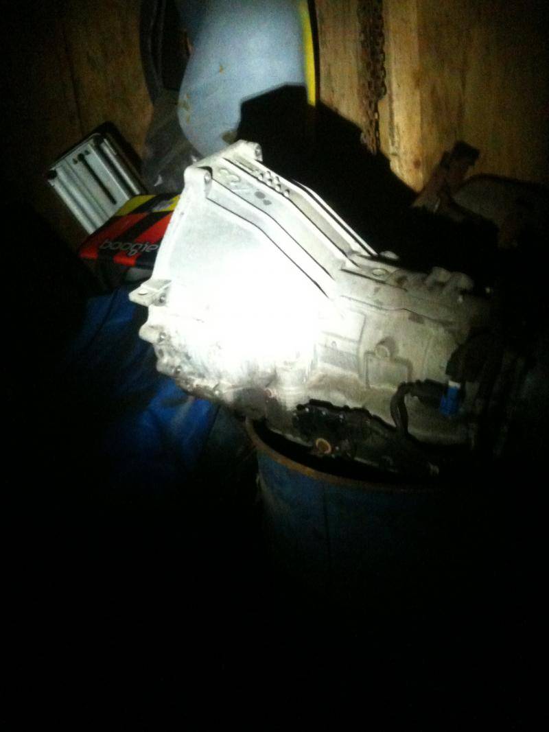

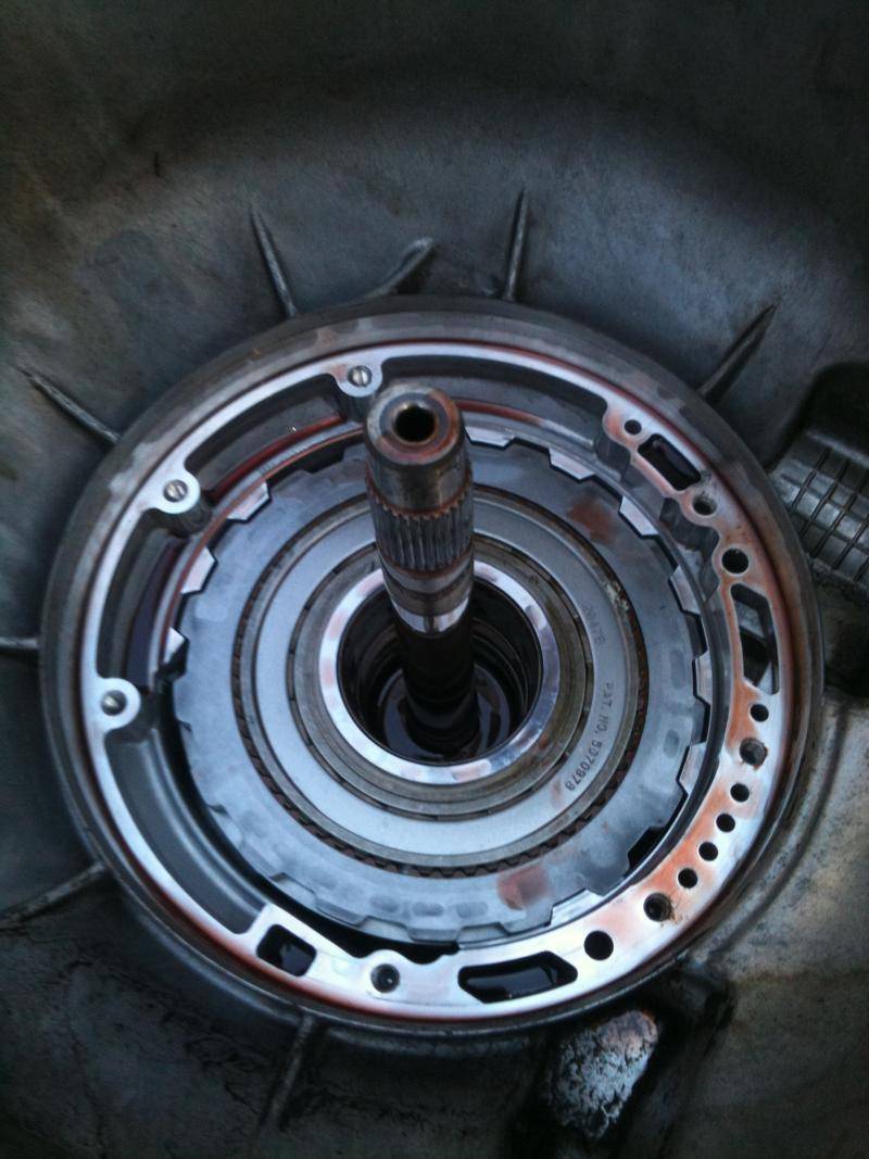

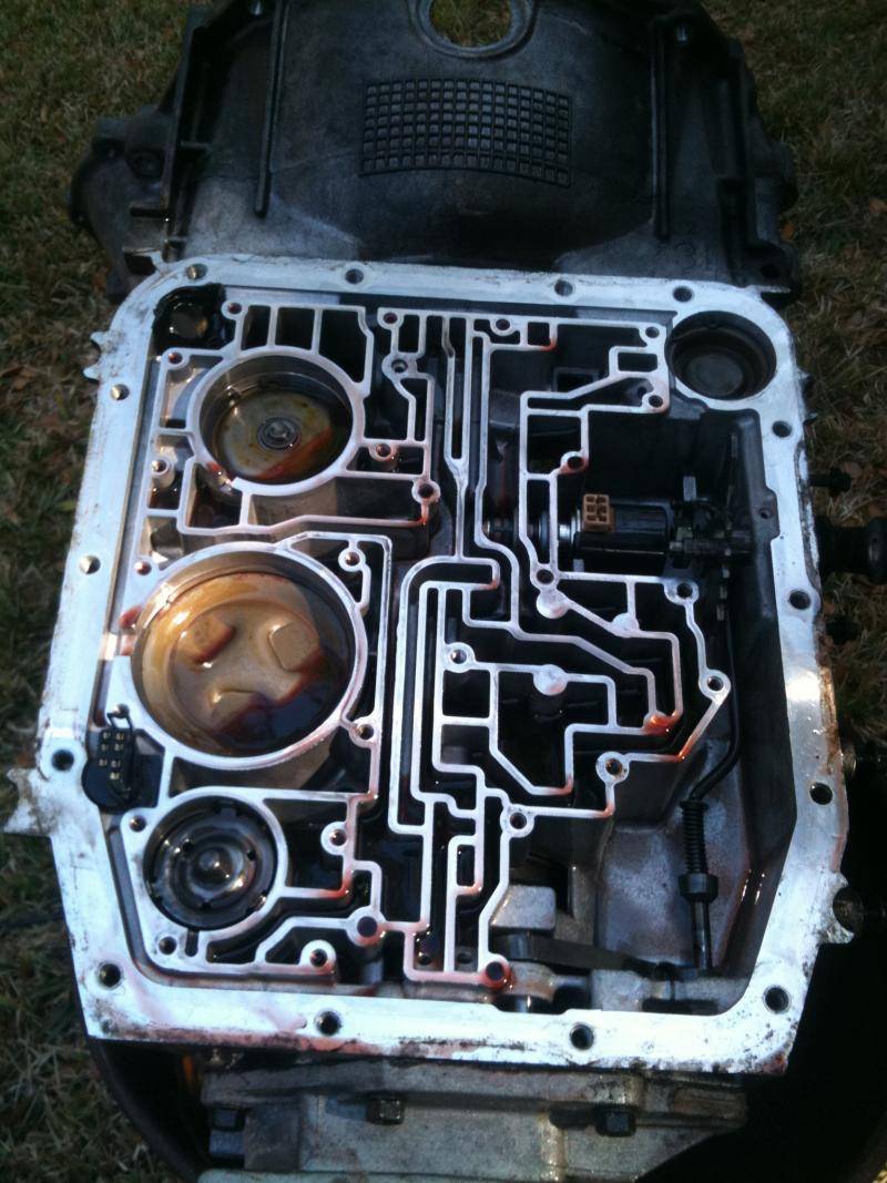

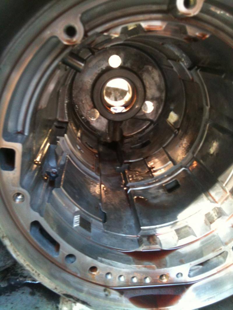

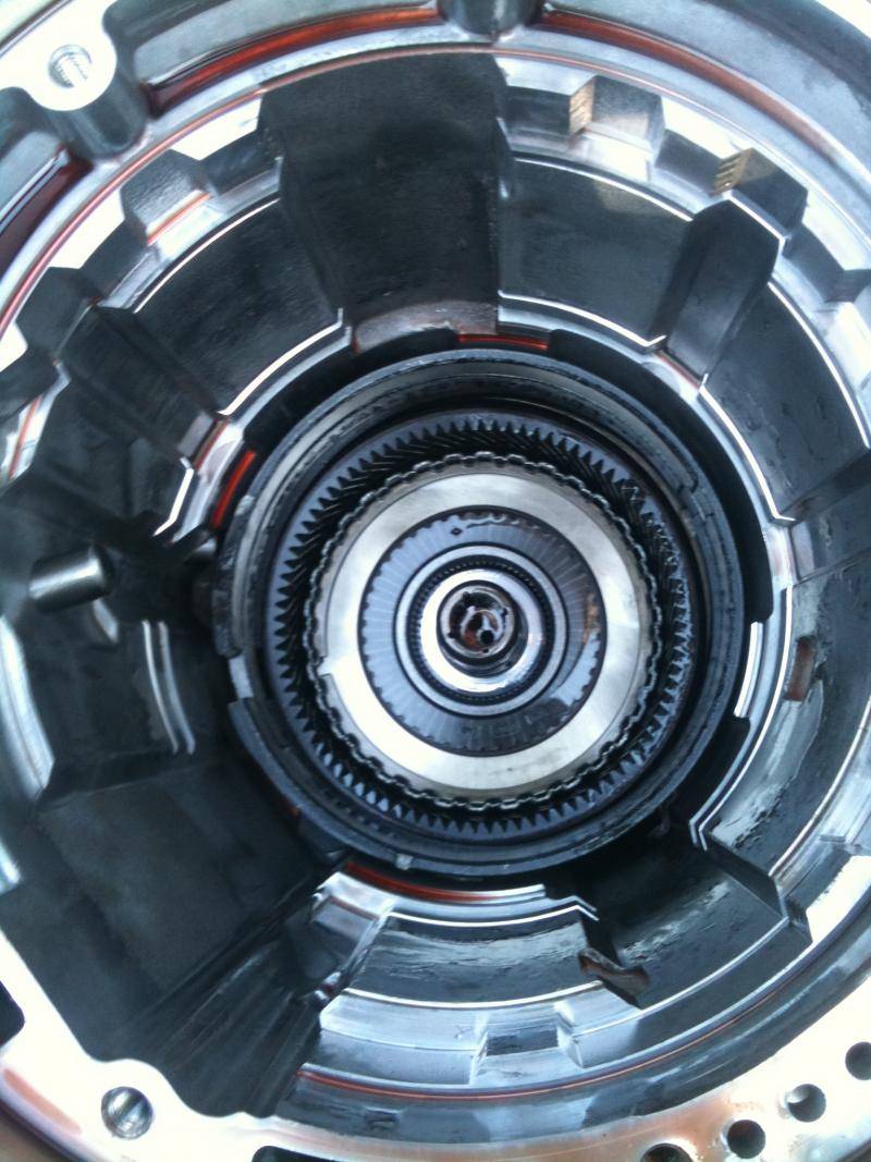

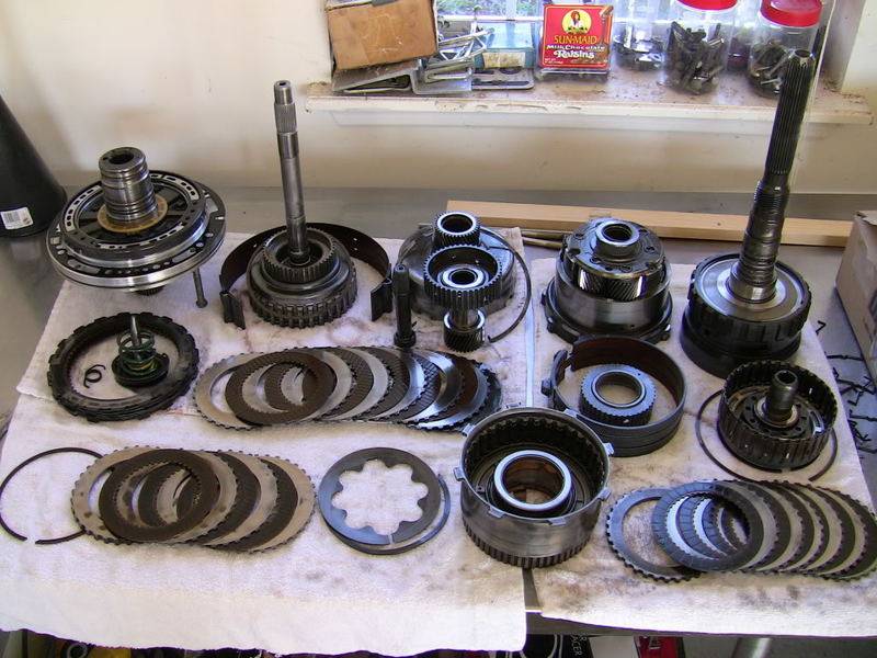

today i got the differential back together, dismantled the transmission and found some parts that are bad. it only took me about an hour to get it apart. tomorrow i am going to a transmission parts place.
Take a picture of all of the guts in that trans, the snap rings and all... Nits an intimidating picture.

WE are really just saying that unless you plan on rebuilding more than just one transmission that it is not worth spending all the money on all the special tools all the time it will take to make sure you get it right. I have my car completely ripped apart, my tranny was completly toast, so i decided to rip it apart regardless knowing i am not going to get it fixed, i didn't get very far before i need a special tool.

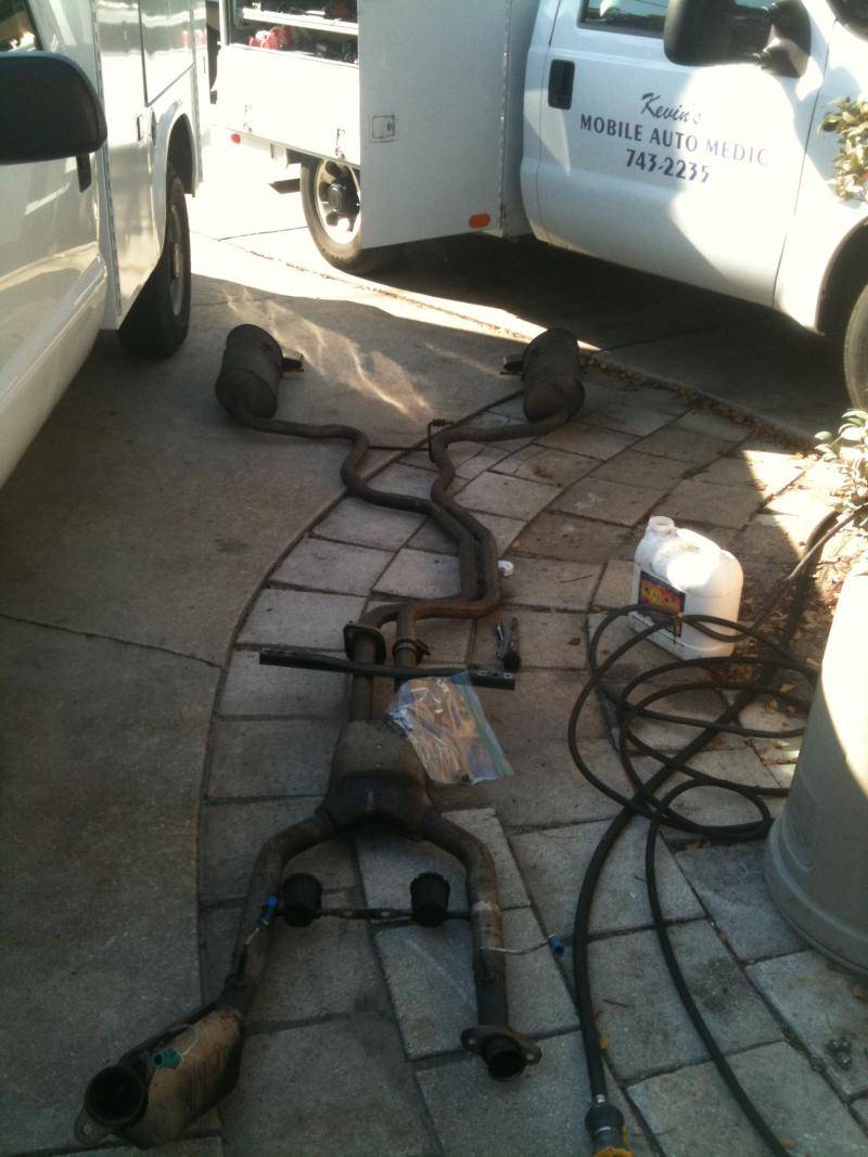

As far as getting it out. first off i would run the car till there is little to no gas in the tank. Go underneath the car there are what i believe ( it has been awhile) 13 mm maybe 14 mm bolt that hold two straps that hold the gas tank up. I would suggest dropping the passenger side down, then unhook the gas lines and the fuel pump connector. you may need the ford gas line tool, not 100 percent sure about that. after the gas tank is out you might as well replace the pump seeing as you have the tank off.
after the tank it out your next step will be to remove the exhaust, i have no clue what size the bolts are seeing as i cut mine off because i had no use for it.
after the exhaust is out you will need to take off the bolts on the drive shaft, i know it is a special torque bolt, but a 12 point socket, i think 12 or 13mm will work. after you pull the shaft out then you can work on the trans bolts, i think there is a plate that you take off to get to the tc bolts, they are a pain in the ass, no lie. After all this there are special tricks at getting bolt off, hoever i am no the one to tell you seeing how i dropped the whole k-member to do this

Well he's already dropped the transmission and got it dismantled. No special tools so far, but did have to modify some tools. It worked and didn't break anything, so no harm no foul. Everythings going good the car should be back together soon.
ok she is all dun. in the end i now have a built 4r70w with the j-mod up to the 3rd stage, 1-2 accumulator spring removed (a bit harsh might put it back in)track lock is now installed as-well as my 93 driveshaft. i had it in and out a total of 4 times. the first one it made a whining noise in revers 1st 2nd but was silent in 3rd and 4th. we took it back out checked everything, nothing wrong.did the same one more time same result. my dad and i took it to a guy here in jacksonville he disassembled it and found no problems, but he did warranty out the torque converter. she is quiet . my dad and i had it all put back together and it worked, he and i will fix another one. the only thing that we did not do is try the torque converter. i am happy with what i saved on doing this my self and would do it again. but i will probably put the 1-2 spring back in. i am glad to have my car back. AND NO I HAVE NOT BIN WORKING ON IT THIS WHOLE TIME LOL.
