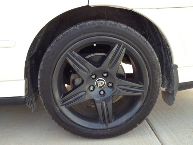

    Don't get caught up in the four piston hype. These brakes are a huge improvement over stock for a marginal increase in price!
    We are talking 500$ for a 14" front brake kit! Woot! Woot!:D

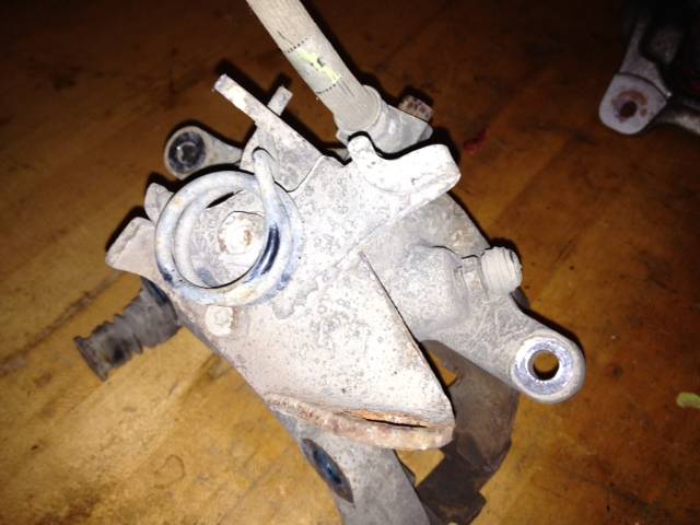

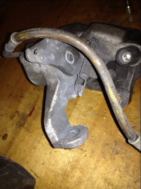

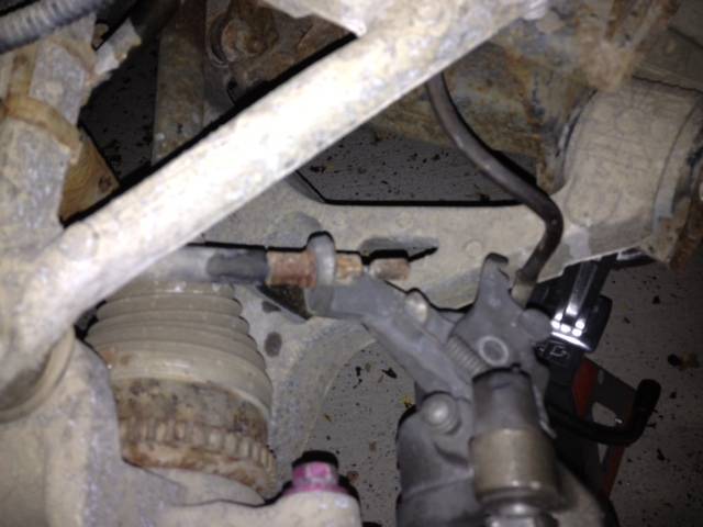

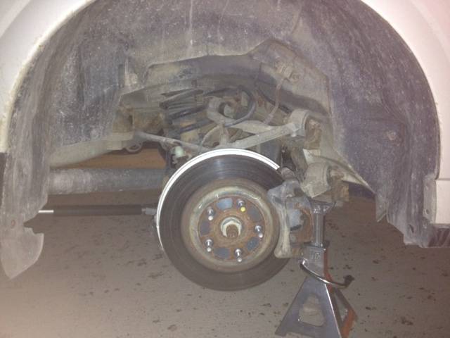

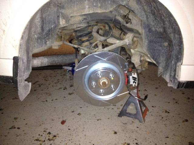

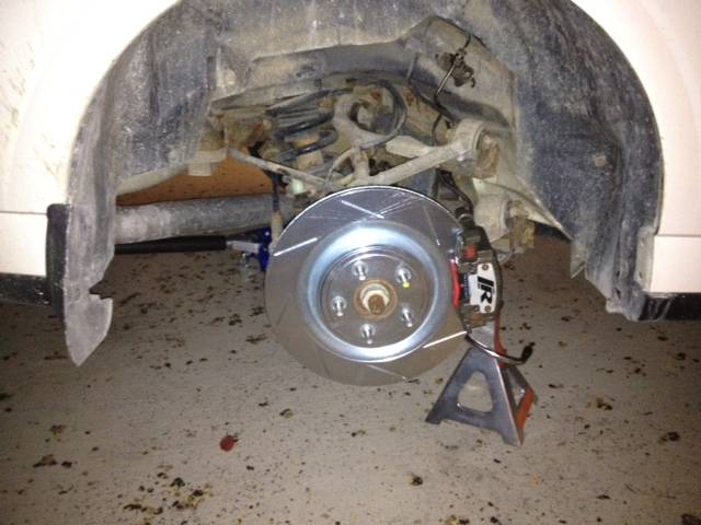

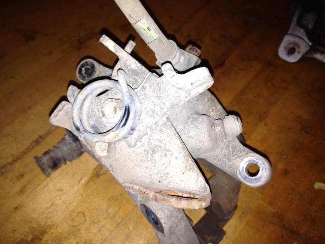

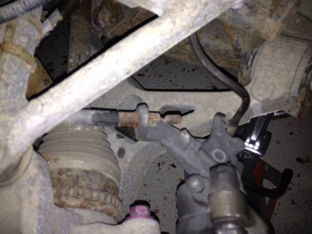

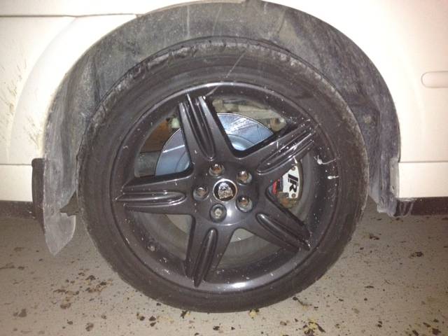

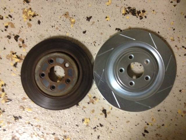

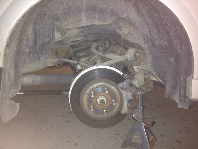

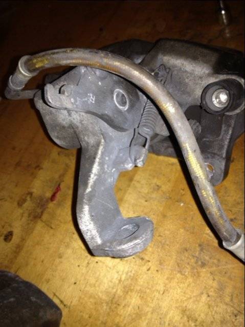

    Rears
    Looks like that back is an easy fit also.
    Stock LS is 11.34" while STR is 12.8"
    Lincoln ls E-Brake is different.
    You will have to get a clevis or make one. You should use about 1/2" clevis to fill this gap. (The cable moves out a bit.)
    The appearance is much better. I took pictures of different sides.
    The rear calipers are single piston 45mm bore (v) the LS' 43mm bore. There is no noticeable impact on the braking proportioning.
