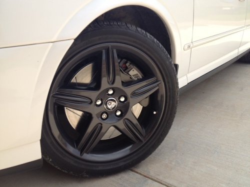

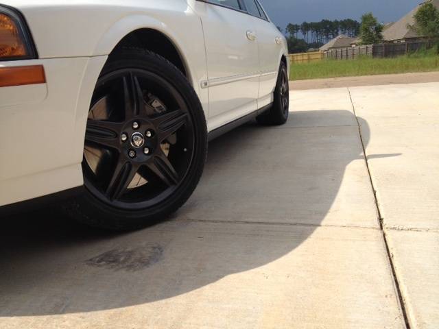

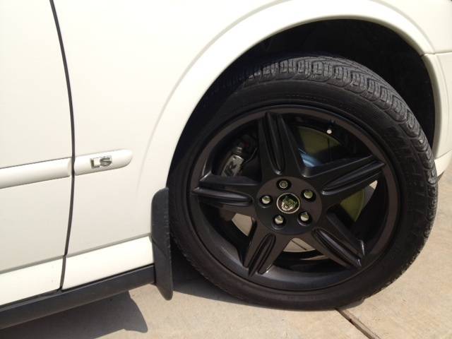

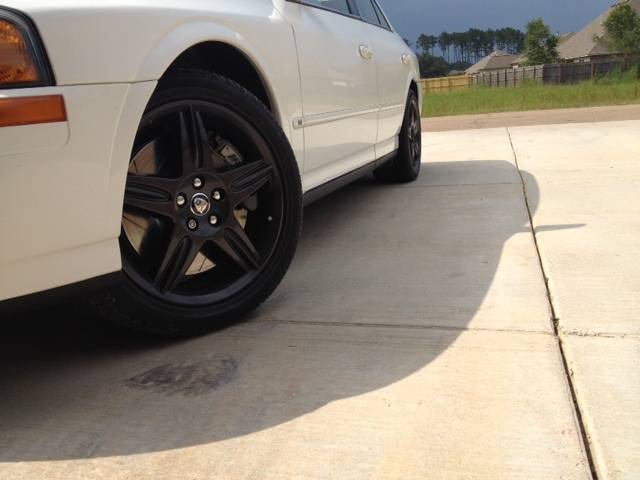

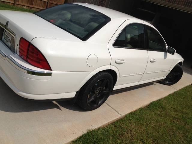

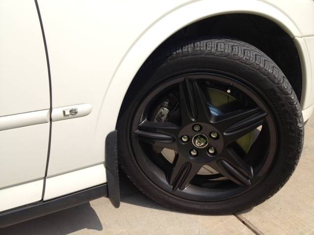

awesome! Again thanks so much for this, Dwiggy.
I know you don't seem like the "take many pics" kinda guy, but please more pics!

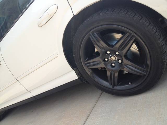

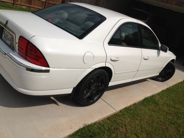

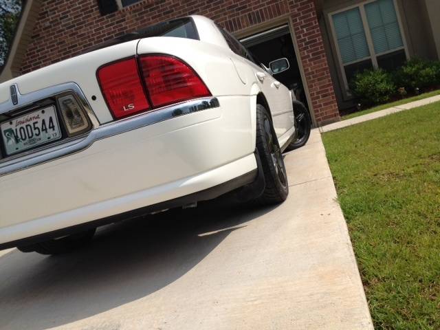

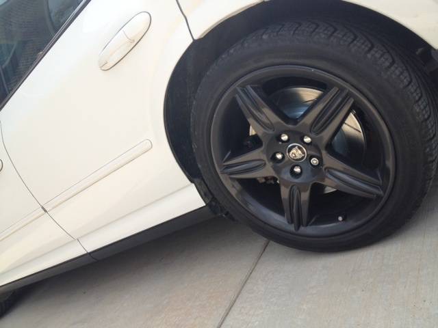

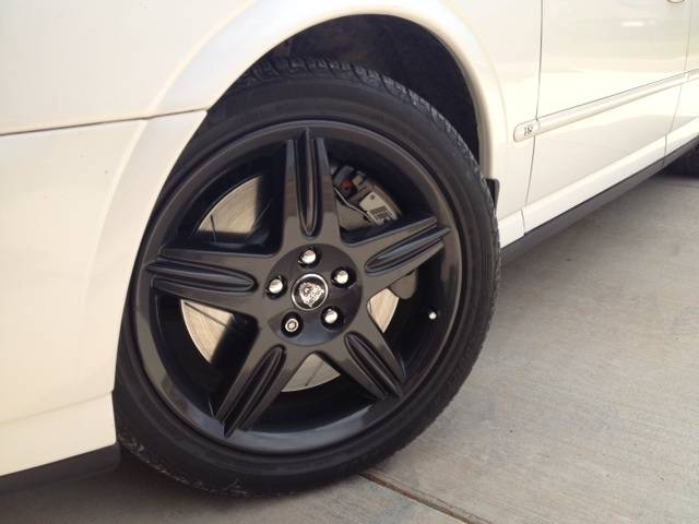

Some Pics...
awesome! ...please more pics!
I'm not a great photographer...

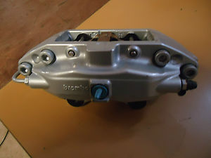

A couple of pirated rear caliper pictures:

After driving a few miles I had a small screeching noise which required me to flatten the backing plates more. They were touching the rotors slightly. This is a very easy job.
Now, I'm just being extraneous here. The Gen I STR wheels are really close to the front calipers. They don't touch but if you have Gen I STR wheels be aware that they are extremely close.
