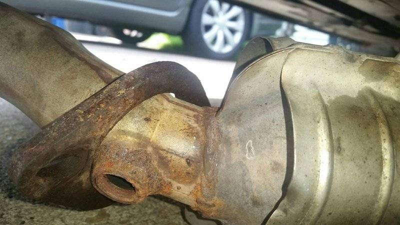

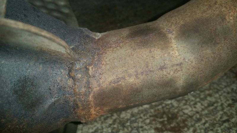

However, that was another plan; Hi-flo cats. However, I'm still stuck on which to buy or if I should go aftermarket OEM or just OEM from the jump. I don't know the right size or if they will actually fit. I was confused on if the cat was curved given the curve of the under-body or if it were straight.
Another reason I removed it.
How do I look at them when they are welded onto the extended pipe? Shouldn't I have to cut them off and re-weld them?
Should maybe check with Member Hite, he is currently running some aftermarket high flow CAT, can't recall now which brand but he swears by them.

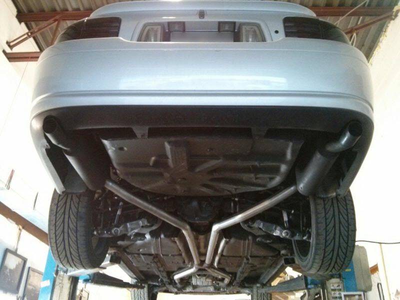

Did my videos convince you to go 'one in the tunnel' ?
I originally wanted to go with a tunnel mount single exhaust after hearing Nick's and Tommy's but had originally planned on lowering it and one of them was saying that it did scrape kinda often so I ended up just going with a pair of rear mounted muffs and ditching the resonators just like I had on my 1st gen. but since I never lowered it and one of the rear muffs rusted out and broke off, I figured it was time to revisit that plan, I was a little concerned at how loud Nick said his was especially with not having and cats to help quiet it down a little... but after hearing yours with the slightly longer muffler, I decided it would probably be about perfect for what I'm looking for.
and if so when you figure completion? Reason I ask is because I'm struggling to complete my edit version of my 04 LSE exhaust tone vid as of late ... I'd cry if you beat me to it. LOL
its looking like its probably going to be a few more weeks at least, A local shop wants a little over $400 to bend and weld all of the piping, and while that ain't too bad, a close friend of mine has his own garage. and said it would probably only be around $100-$150 for us to do it there, and as a plus, I would get to help with the welding and get a little more practice with a tig. down side is that there is a pony getting a whole lot of boost piping that needs to get welded up so he can get that car out of there to make room for mine... dont worry, you should definitely beat me too it, cause even I after its done, its gonna take a few weeks for the muffler to break in (maybe even more if I dont start driving it more)
I'm still very much enjoying this single dual in/out Magnaflow setup, sounds real nice, much better then my double Bassani mufflers at the back like on the other LS.
I don't know if it just the longer pipe after the muffler that helps refine the sound, but I've always preferred the sound of cars with the muffler in the middle as opposed to right at the end of the system
I've also noted that when on it ... it does seem to make crossing pedestrians pick up their pace a bit, some even run that last little stretch to the curb.
yep, normally down town around campus, people are freaking retarded and will just walk out to cross the street everywhere with out ever looking, I always make sure to use SST and down shift to keep the revs up and surprisingly, most people get their faces out of their phones and actually look up and don't try to cross in front of me! (which alone is worth the price of admission)

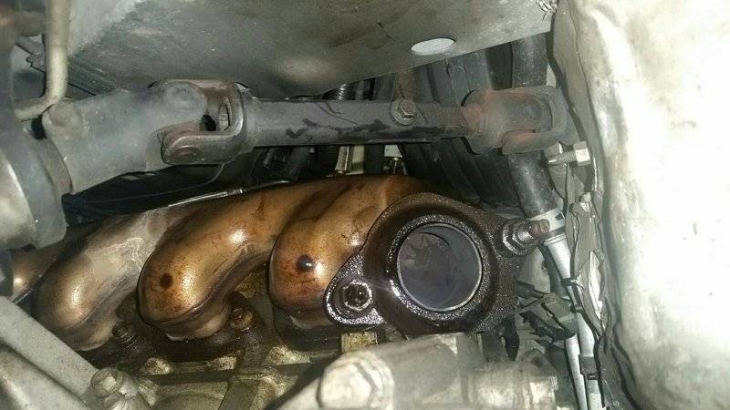

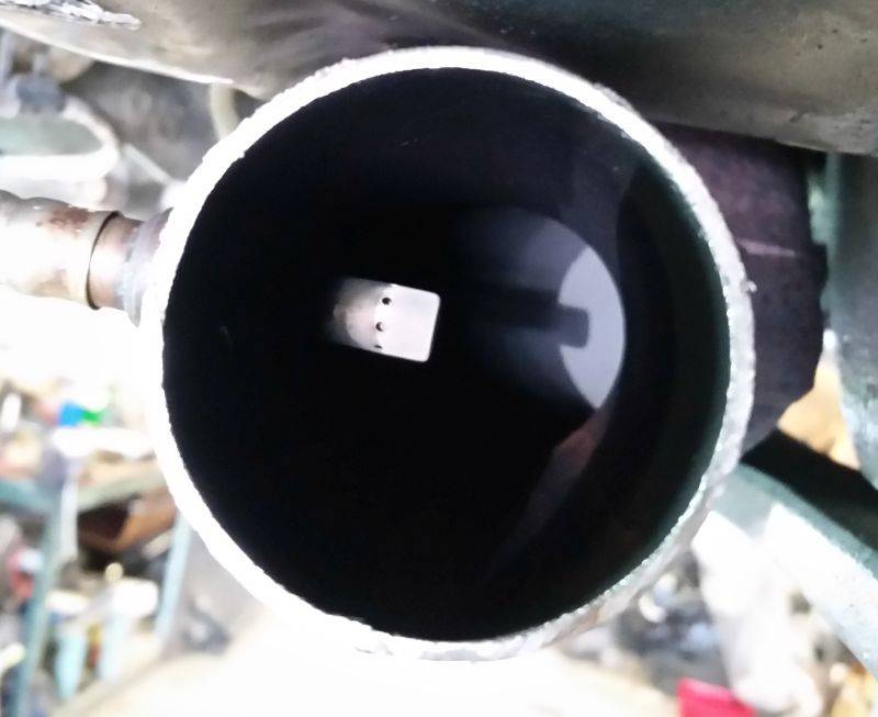

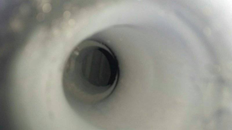

So... is the cat actually empty? I can reach to the back of it and feel the contact from the pole. I know they usually have wire, mesh, and etc in them. So the fact that it pings when I tap it is confusing me...
I'm thinking I'm wrong because I'd be able to hear an exhaust note. ...right??
It's not hitting the metal ridges either. .

Should see a mesh screen, somewhat silver in color.

This is on my 01 LS V8 when I had the whole system redone. I had some concerns my CATs where clogged, you can see in the first picture, the piping was cut off just after the downstream O2 sensor, If you look closely (although a bit blurry) you can see the silver/grayish mesh screen. It's those that either melt or get clogged up.
Turns out that day, after inspection, I decided right there on the spot we were not going to gut the CATs after all. Although the guy doing the work was willing to go along with it, he strongly suggested against it and after blowing out the CATs, said there is nothing wrong with them, they are in good shape.
Pics below for your interests,
Had the exhaust redone today. Turned into an all day experience.
As the whole previous system was cut off and the inside of both CAT where blown out, car lowered onto the ground and a good few hard revs blew the remainder out, both screens inside each CAT were determined to be in perfect condition after all, nothing was clogged up, burned or deteriorated, a good blow out and it was decided to NOT gut them after all.
Nice symmetrical new system put back in place
Much cleaner job, just the tips turned out a little on the small side for me, will need to have them redone a bit.
At least the large chrome cannon tips are off.
Runs a bit more quieter then before.
