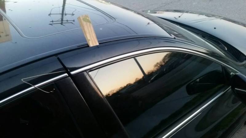

At 07:47am .. I thought of something smart...after being arrested and handcuffed by the cops for breaking into my own car after reports from someone driving by. With proof from the DMV might I add...
Aanndd a little thinking and common sense.
Plastic on metal.. no
Plastic on metal covered with rubber.. yes
and that right there is why I wont own a ford with out a key pad on the door!
then again, being able to unlock my car from my cell phone is also very helpful.
since it was as you were leaving for work, I take it you don't have a second key? I would make sure to get one as soon as possible, even if you don't program it to start the car (which is kinda silly not too) at least then it can be used to unlock the door/trunk in just such a case.

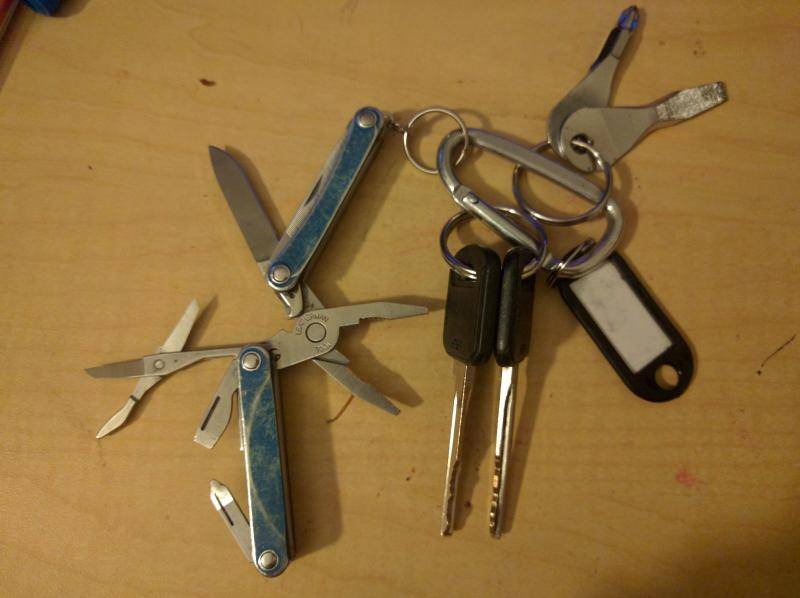

I'd find a cozy spot in the frame under the car with something removable by hand rather than behind a place. At least, that's what I did. The chin spoiler also makes for a nice spot once parked, though that spot is retired now. I also carry a "utility" keychain at all times with those $2 basic keys for both my cars. I'm eventually going to buy one of those stick-on keypads (works like a fob, just with a code and sticks to your car) and stick it under the wiper or something. My Taurus has the keypad and I use it every workday

I've gotten transponder eBay keys and had them cut for "free" at the hardware store after buying and cutting a basic key with some polite smooth talking. About 75% success rate. One kid told me he wouldn't even cut me a basic key because the wrong key could set off my alarm...
with new ford cars that use 80 bit keys, the alarm needs to see the ignition turned on AND sees the correct transponder to shut off the alarm, but still using the key in the door cylinder should still disarm the alarm... regardless this is of no concern fro an LS that uses the 40 bit keys. the transponder does not need to be programmed to disarm the alarm, a correctly cut key in the drivers door cylinder with disarm the factory alarm.
I've used them on the Mustang and the 04 LS with no problems getting in the door. don-ohio :)^)

There is some sequence of events which can lead to the car locking itself after you get out with the car running. Judging by Kid's picture showing the radio and AC are on, I'm guessing that's what happened, as opposed to intentionally locking the car. After 3 years at a dealership and getting into the habit of opening a window before closing a running car (though never actually seeing a car lock itself), it finally paid off about a year after getting my LS. I was shuffling cars on my driveway, stopped the LS in the street, and after I got out and closed the door, it locked itself. My best guess is that it was the autolock when the car is in drive and you let off the brake. I probably rode the brake the whole way and let off as I stepped out.
Just another reason to have a cheap chipless key with you...
I use it to run the car sometimes when I want to leave it running while unattended. You can trick PATS by holding your chip key to the ignition while turning the chipless key. The car runs but you can lock it with the fob. And if someone is ballsy enough to smash your window and run off with your car, you can find some solace in the fact they won't be able to restart the car once they turn it off. It'll give you a few giggles while you cry over the fact your car is gone and insurance won't cover your negligence. I've been thinking about a brake-interrupt circuit on the run circuit, manually engaged with a switch, controlling a normally-closed relay in the Run circuit. You hit the brake, car turns off, chipless key won't restart it.
