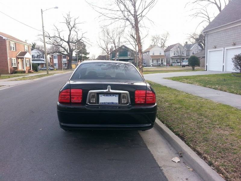

Talked to the Black. They initially wanted 1500. I talked them down since I saw they had about 4 other cars... Brought it down to 700.. two weeks later 600....3 days later it was mine. At 140k, All black, Chrome wheels, near perfect condition leather, etc etc. Whew, I had to.

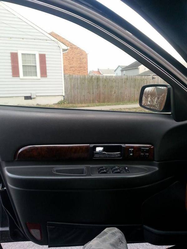

- The door handle on the drivers side is broken, needs replacing.. Reaching out the window to get out

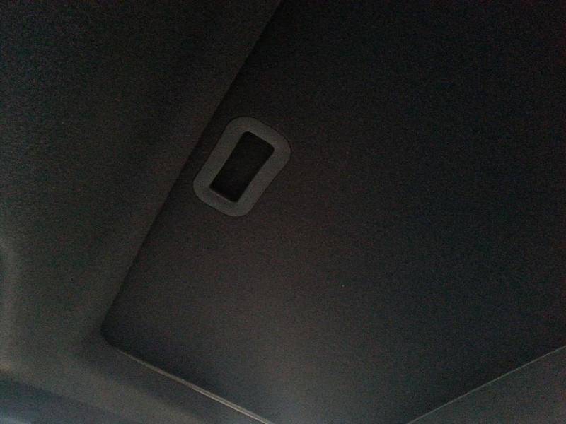

- The trunk says that it is open even when closed

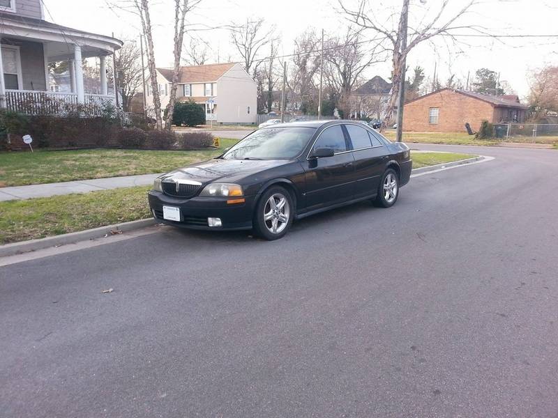

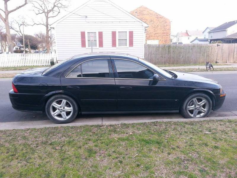

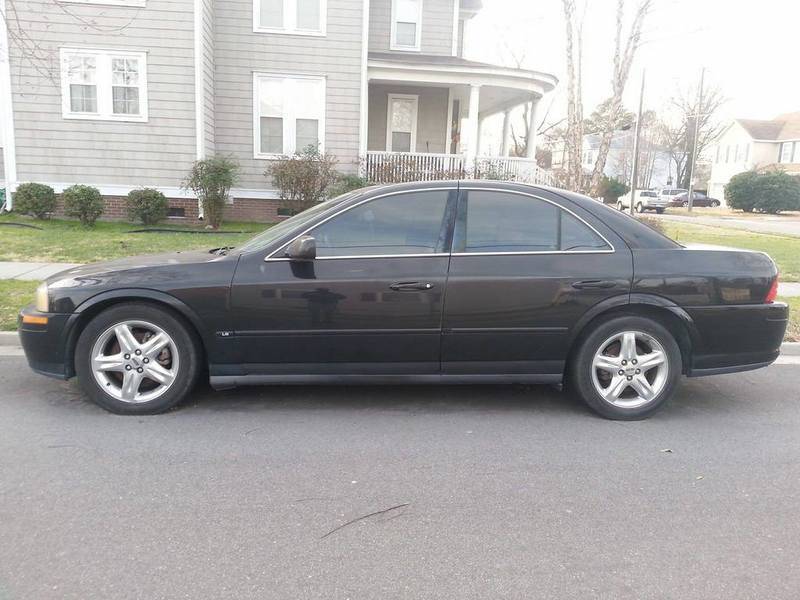

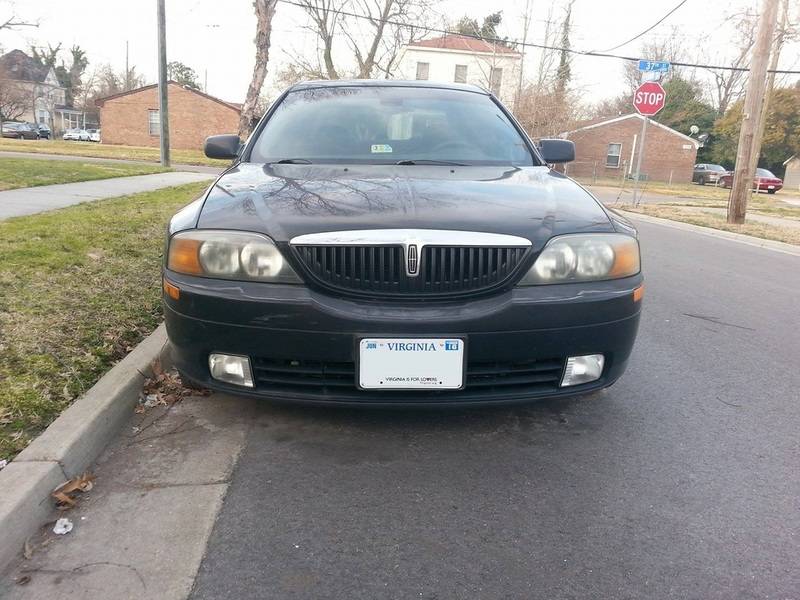

Here are some pictures. I'll see if this video uploads as well.

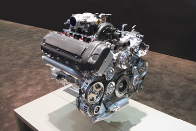

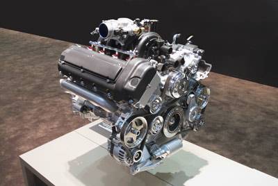

Can somebody find a picture of the engine and show me where the fuel rail is so I can test the pressure? I cannot find it anywhere

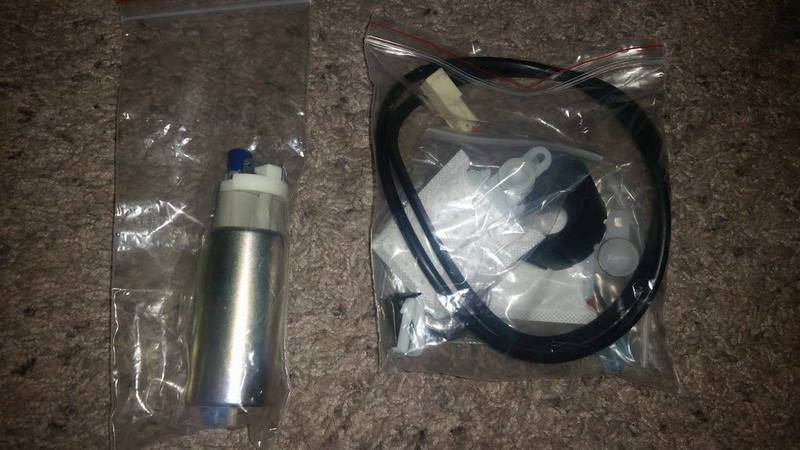

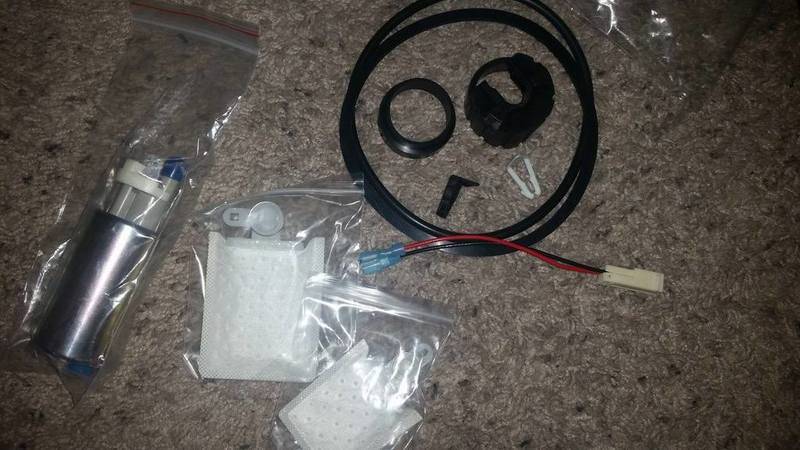

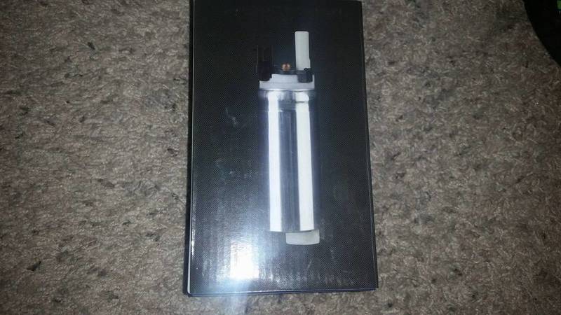

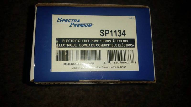

Well, I went ahead and bought the pump itself not the entire assembly. So I'll be tackling this job bright and early in the morning.
I know I should replace the filter. I'll replace the filter if the car runs steadily. I'm just strapped for cash.
SO, HOPEFULLY I can update by the afternoon tomorrow with some sort of result! I'll upload pictures of my purchase.

The fuel rails I'm used to are Aluminum. I haven't found an Aluminum line on the engine yet. I've found the Regulator valve and such which i believe houses the pressure point, but I'm not quite sure.
step one: remove plastic engine cover
step two: look for them.
thats really it, just like every single V8 I've ever owned, the fuel injectors are at the base of the intake manifold, just above each valve cover, evenly spaced out above each cylinder, the fuel rail connects to each injector.
you can clearly see them in this picture, it is the only horizontal silver/metal tube in the picture(in that area). I though some (all?) LS's were painted black
if you still cant find the fuel rail, then make sure that you have a V8 because the V6 has both rails running next to each other right down the center under the upper intake...
EDIT: look at these ebay adds for intake manifolds, you can clearly see the (black) fuel rails on the pictures
