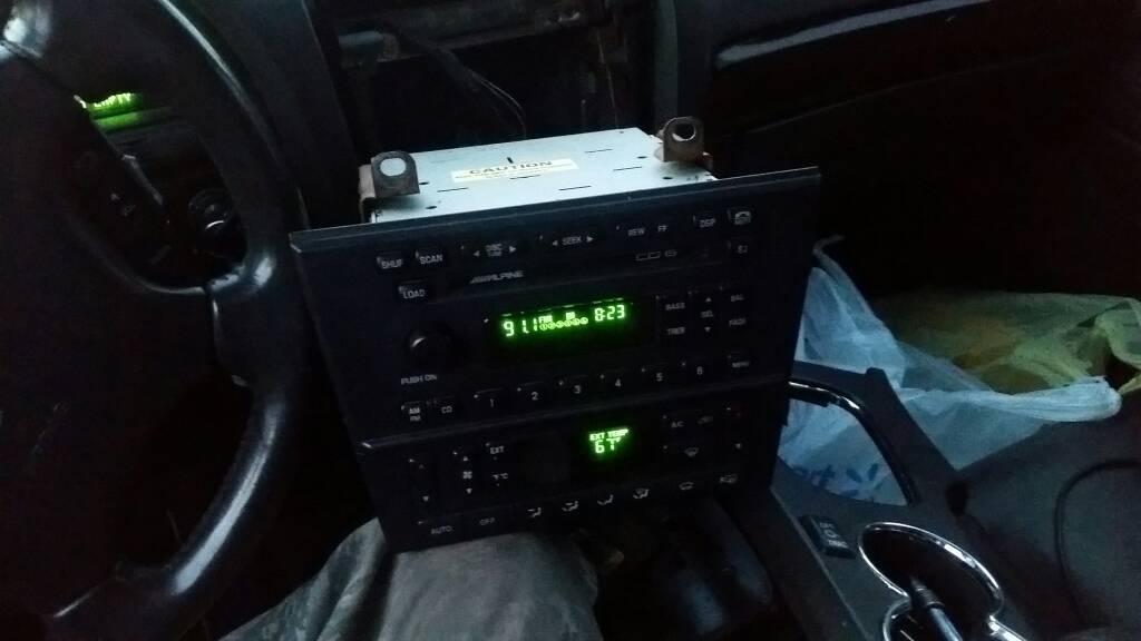

Finally did that fuel filter...and now I'm trying to figure this out...
However, the last owner took the cds out before my eyes when I bought the car that day. So I'm mot understanding the issue here. Its completely empty. I can even slide one inside...
