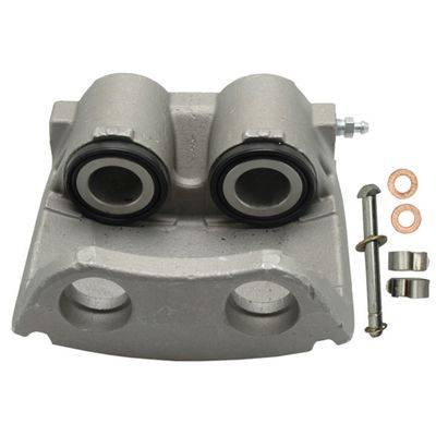

I found this bracket on another car parts website, I see there are four holes in this bracket, and the oem caliper bracket has two. How would these mount on the Mark hub?
the 4 holes i probably just so that bracket can be used for more than one car
and that bracket looks nothing like a stock one it doesn't look like it would work
with cobra calipers
why are you looking for brackets normally the calipers come with them

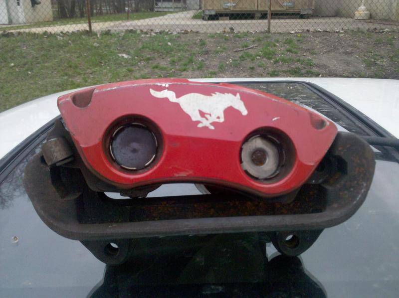

pic of factory
the brackets that the cobra uses for the caliper will bolt to the mark front spindle, all you need are the cobra brackets and calipers.
And just so wveryone is on the same page, by bracket Jamie is not saying some extra part needed to bolt it up. The "bracket" is part of the calipers assembly when you buy them new.
Dont screw with a $60 reman unit. Thats $120 and then what Cobra calipers do you have for the core? None. Then you gotta find the bracket.
Cobra calipers show up on Ebay all the time for $300ish. They bolt right up, two 15mm bolts.
