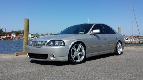

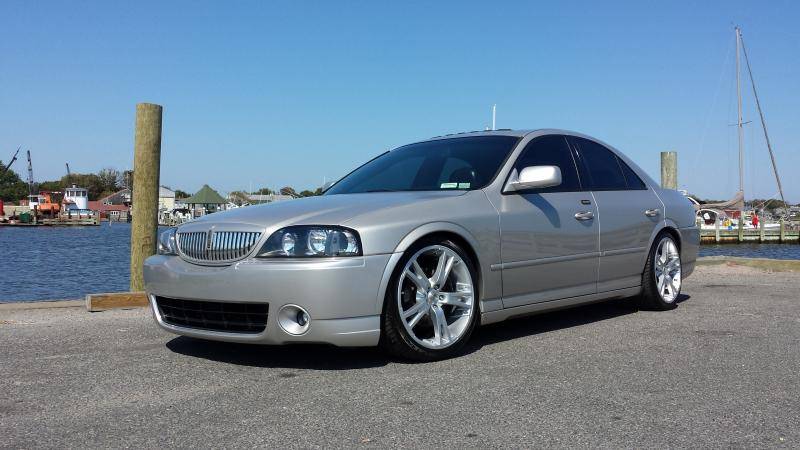

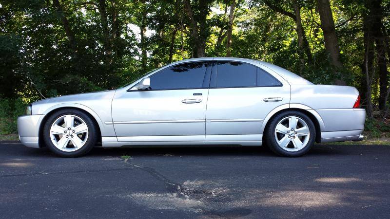

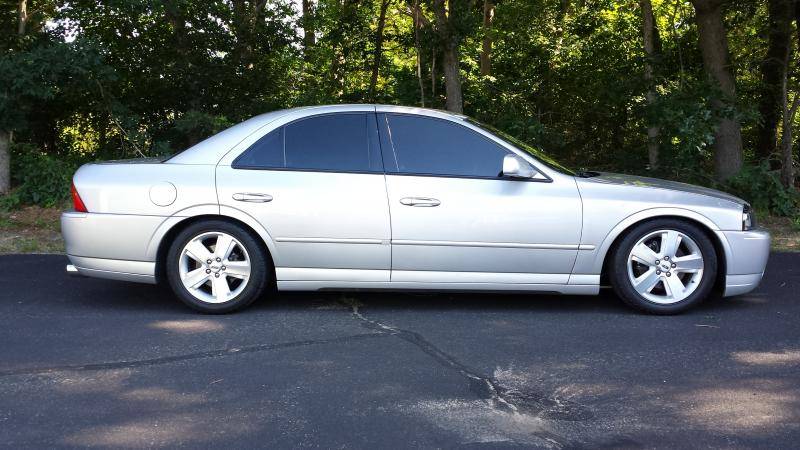

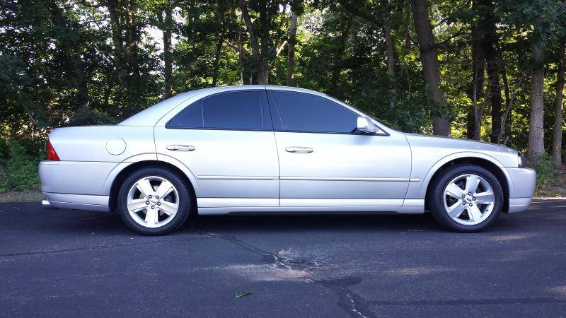

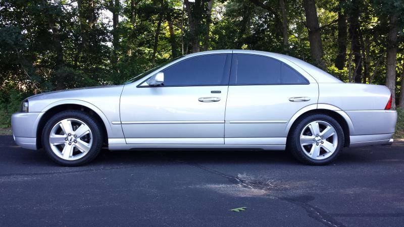

    Recently had the car lowered on Eibach's pro kit. I read a lot about coilovers/springs & I basically went with springs because of the $$. I only have 42k miles on the car, so to swap out the struts before necessary is a waste IMO. The coilovers were gonna run me a lil over $1500 installed...and the springs were gonna cost $540 (alignment included) - so i decided to save the $900 for now.
    I had the shop cut 1/2 a coil off the front springs - the rear of my car was already a 1/2" lower than the front because of the music and 2nd battery I have in the trunk. In the rear I used spring helpers in between the coil of the springs (the same ones that QuickLS used) to help prevent the car from rubbing over dips (hopefully anyway).
    Based on what I read, I expected the drop to be about 1.25" in the rear and 1.5" in the front. The end result was about 1/2-3/4" lower than expected. I have about 1.5" in the rear and a 2" drop in the front. I still have to take final measurements.
    Anyway Ill upload more pics when the 19's are on. Here are a few for now.
    Before
    After
    Before
    After

    Looks great! I agree with not swapping out for new shocks with that low miles, money saved for now.
    Looking forward to see some pics when it has had a chance to settle a bit and the 19's on. Hopefully no rubbing!

    Thanks guys. Ive been driving carefully. The 19's are going on this weekend and I am anxious to see how she finally sits. Hite you might recognize them :) - Mille Miglia EV-R 19". The exact ones NYC LS8 had. :D
    I purposely went over the biggest speed bump I know of, and bumped slightly on the frame behind the front wheels - didnt scrape the front though and thats what worried me the most - so I went slower the second time and didnt bump. I can pull into my driveway, but i have to back into my gf's driveway - no biggie. Im pretty sure the car has fully settled in the past 3 weeks, so im ready for the 19's. I will post pictures next week.

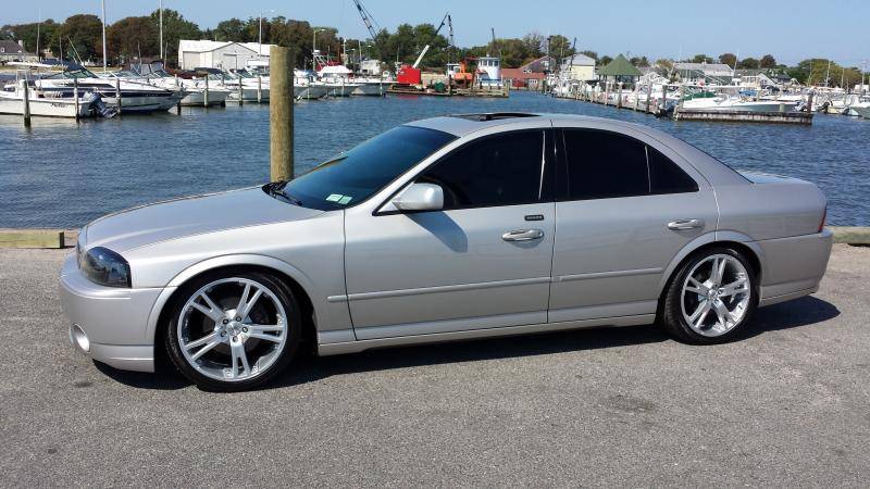

    love the stance. when the a.ss drops about 1/2" in drive its almost perfectly level...maybe a slight rake. :cool:
    I wouldnt want to go any lower. entering and exiting parking-lots has become a process. :confused:

      also Long Island: that wheel with that amount of wheel gap looks perfect, you couldn't ask for a better fit.

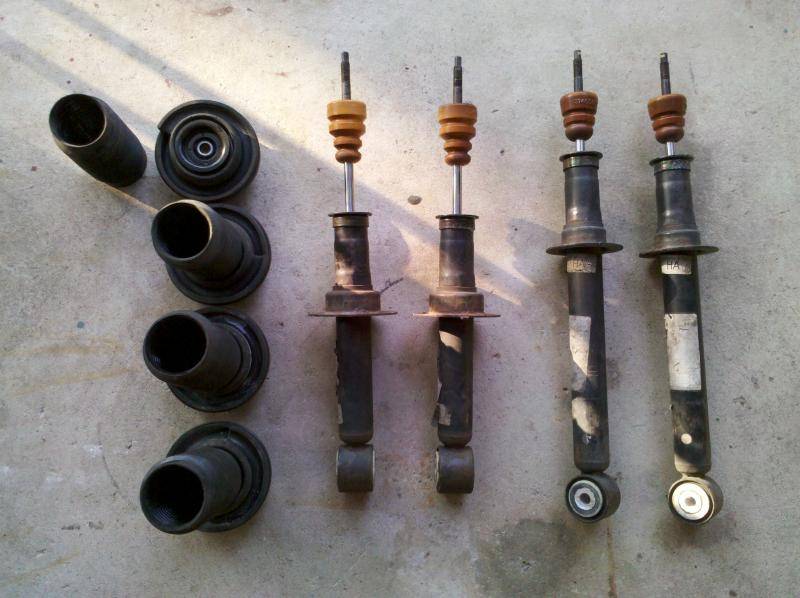

            our stock struts actually come with a "bump stop". They had to trim about a 1/4" off of mine to allow for proper travel distance without constantly bottoming out. Good idea, but the LS already has them ;)

            Well, the LS doesn't have struts but I know what you mean. If they had to trim them by that much then a stiffer damper is needed with stiffer rebound. The springs you have are the stiffer they have right?

            im pretty sure they are struts... last time I checked they only list "struts" for the LS... but they kinda look like strut-shocks IMO lol
            I appreciate the concern, but the part that was trimmed was fairly insignificant.
            They trimmed the bottom nub off the orange rubber "bump-stops" ^ (see the pic of my old 02 struts). The eibach springs prevent the strut-shocks from compressing as much as factory springs so I should never really "bottom-out".

            Most call them struts, but they are coil over shocks. I have a car with struts, there is a big difference. Struts is a cheaper suspension set up.

            With struts, you don't have an upper control arm. The strut takes on that function, but it is usually not as precise as having an upper control arm.
            On the LS, the shock and the spring are just doing what shocks and springs normally do, it does not matter that they are together instead of completely separate.
