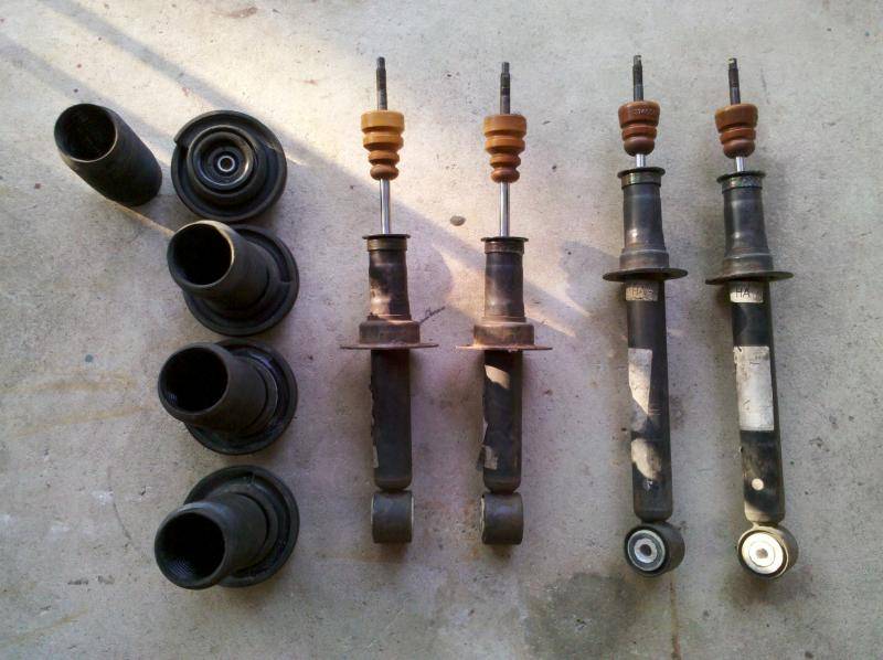

^ Ty for the clarification. I know this comes up often lol. They kinda look like shocks, but they are listed as struts? :confused:
.. so they are "strucks"?? lol ..I guess the difference is internal?
Struts also have rhe double duty of keeping the alignment with the steering and every thing. Aside from cars with coilovers like ours, you could drive a car without shocks it would just be really bouncy. If you try to drive a car without struts you'd have little control because the bottom mount of the struts actually locates the suspension components. ie the strut moves with the steering. There may be a few exceptions.
im pretty sure they are struts... last time I checked they only list "struts" for the LS... but they kinda look like strut-shocks IMO lol
I appreciate the concern, but the part that was trimmed was fairly insignificant.
They trimmed the bottom nub off the orange rubber "bump-stops" ^ (see the pic of my old 02 struts). The eibach springs prevent the strut-shocks from compressing as much as factory springs so I should never really "bottom-out".
