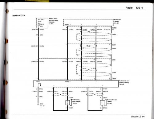

I guess you miss my point, the wire harness at the trunk has both left and right wires, the 8 pin prevents you from running 2 audio signals in the rear or front....
This is simply not true. It's a mono amp. The wire harness in the trunk does not have left and right wires.
There are two speaker outputs of course since there are two subs back there. However, there is only one channel input, not two.

we are completely looking at different wiring diagram here. the connectors are different
https://www.facebook.com/photo.php?...899049.-2207520000.1394592144.&type=3&theater
No. You posted the same diagram that I did. (Gen I vs Gen II, but the connector, connections, and amp are the same.)
It clearly shows one mono differential signal input to the amplifier. Like mine, it shows two speaker outputs from the amplifier, but also like mine, it shows only one audio input.
In both cases, pin 8 is the negative (ground) audio signal input, and pin 7 is the positive audio signal input. Pins 1, 2, 3, and 4 are outputs to the speakers. Please tell me what four pins you believe to be left and right audio inputs to the sub amp.

did you even look at those two diagrams before you posted that? with the exception of the actual connectors, they are 99% identical... every wire (hell even the same color wires)
I have to re-check it, I got bad information from somewhere
http://www.the12volt.com/installbay/forum_posts.asp?TID=58518
So joegr you are right, it's mono.
