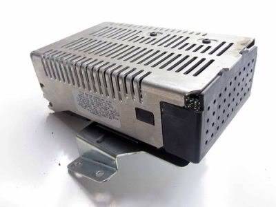

Looking for this, located under the dash I believe. Buddy of mine sent me this pic. Found one on eBay for $99, I told him I'd check with you guys first.

Nolan, that looks like the scil module. Steering column ignition lighting module. If you buy one you need to get the lock cylinder and ignition key from the same car. Otherwise the car won't start. You can get it reprogrammed from a locksmith or dealer, I think. Ask Jamie I'm sure he knows, or someone on here will.

you at least need the transponder and antenna off the same cylinder that the scil is from. but instead of disecting a cylinder, just find an scil with matching key and cylinder all from the same car or your gonna run into all kinds of trouble. i may even have a complete set up in my garage i'll check tomorrow.
