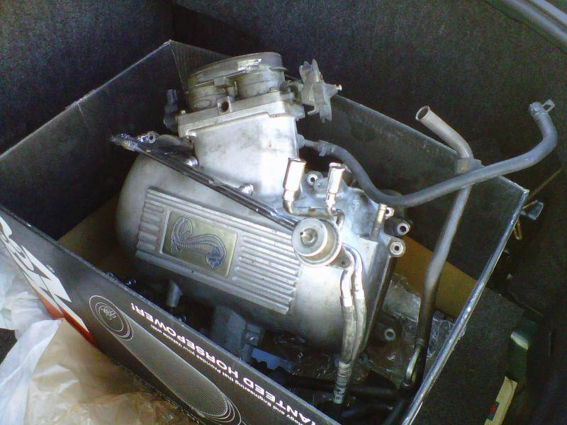

Wow what an amazing build, I had a 99 Cobra for a long time and loved it. I would love to have a nicely built Mk8

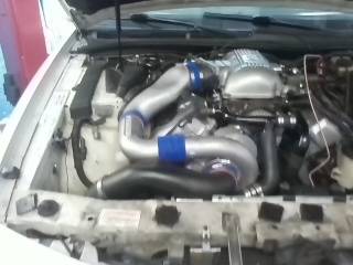

Very Nice. I've had two pearl White Marks. Great color. Thats some good stuff you got for it. I'd bet later you wish you had got a higher stall though. Good luck. Can't wait to see the out come. Might what to consider Meth injection. Increases the octane and cools the intake temp.
Ill tell ya right now dont exceede 8 psi on stock internals and no intercooling.
Remember that Mark VIIIs have larger crank pullys then Cobras do so the boost will be SUBSTANTIALLY higher.
I had the pulley setup on my car to make 8-9 PSI and you should have seen my face when it pumped out almost 18psi! :eek:
Stock Cobra crank pulley or the SFI ATI one from Summit is what I have.
i know 8psi is all i'm comfortable with as for a higher stall i might just do that, don and laser i love your cars, you guys are my inspiration behind this project

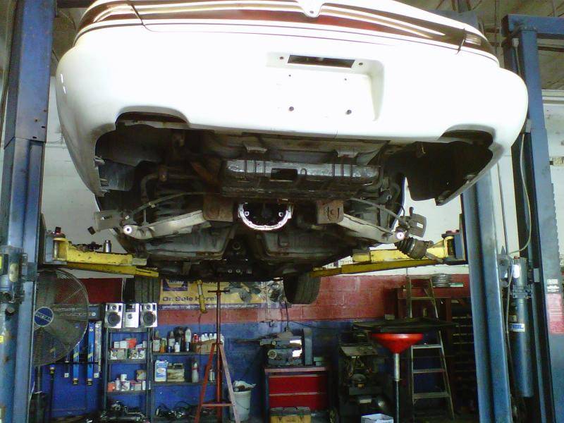

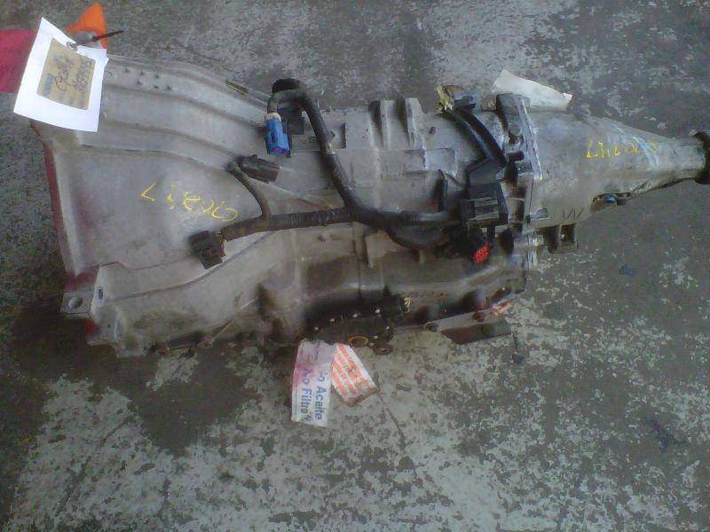

the Transmission came out of a 98 lsc with 20k on it delivered to my shop for $300.

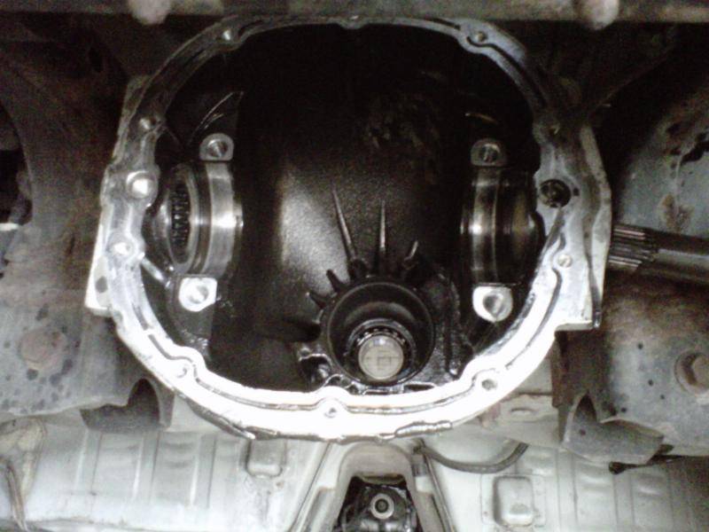

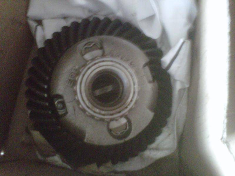

gear & trac-loc went in great.

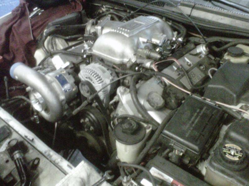

I will be using a local guy here in south floridan to write the tune. He will be deleting the EGR as well.

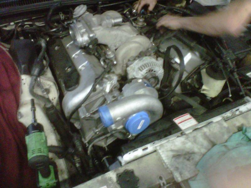

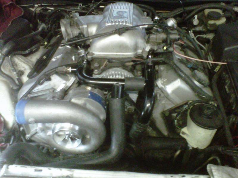

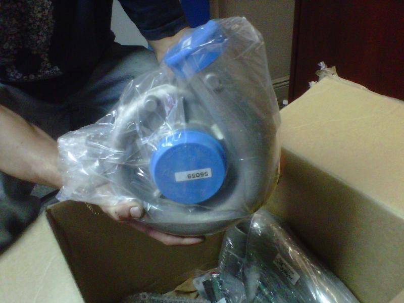

Planning on 8lbs of boost, and the crossover tube came with the vortech kit.
