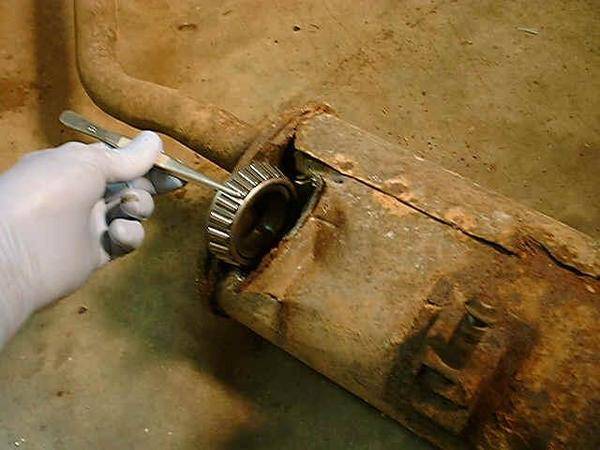

Dr. SVO phd performing a muffler bearing replacement procedure:
lol lol lol lol
i used to sell cars and i made $50 from my mngr. by telling someone that the car had just gone through a 120pt inspection and the muffeler bearings,flux capasitor,and the chrome tensioner valve were all good. we used to screw with people all the time. love that pic i spit coke on my screen and allmost pissed myself.
