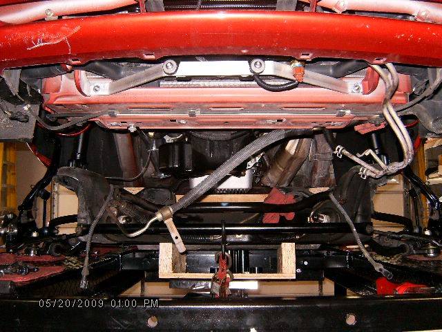

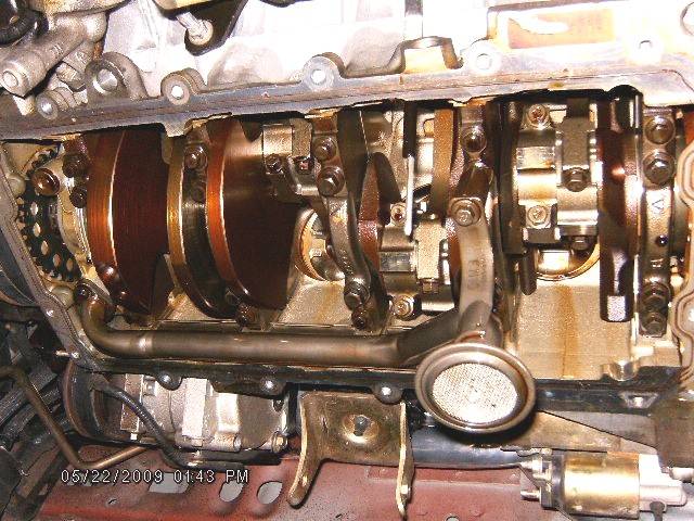

When I did the Kooks headers, motor mounts, oil pan gasket, oil filter relocation, ADDCO sway bar, etc., I lowered the K-Member enough to get to all of it easily.
It wasn't necessary to disconnect any of the power steering lines, so I don't consider that as removing the K-Member from the car.
So with something everyone kept saying is not a big deal, and is quite easy to do, seems to be a whole different story when a price tag is put on it?
It isn't difficult, IF you have the right tools, but it does seem to take forever.
I've done it both ways:
On my SC, in my driveway, on jack stands, on my back, using an engine hoist to support the engine (which BTW, means that the engine hoist legs are under the car with you and in the way :eek:)....
... and on the LSC, in my garage, on my lift, with an OTC Stinger engine support bar. ;)
MUCH easier the last time.
