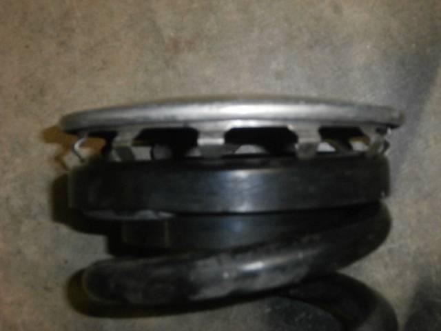

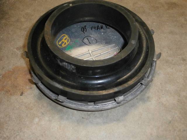

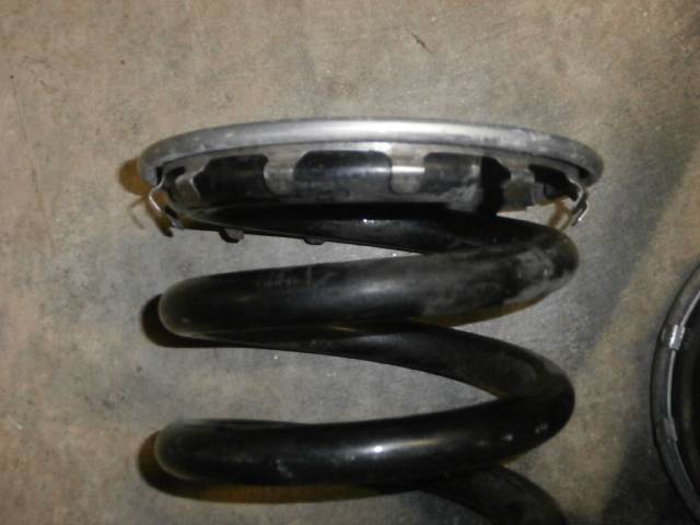

today I got the perches (Snowflake rim center caps)
they fit around the coil perfectly with no isolator
with the iso on it's no go- but with retaining tabs bent back it's pretty snug -not perfect, maybe it'll work
finally put it back on the ground with new/used 1.5'' lowered coils and a new sway bar...I like the look, but it's definitely lowered...my jack got stuck under the front drv side after putting all the tires down :(

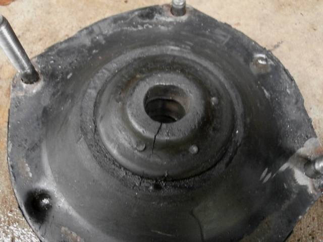

thanks for selling me the cracked strut mount that had to be replaced
am I still bitter? fk yeah...nobody likes buying used junk
sniper knew what he had and was selling after he swapped the springs

I probably could have made you perches on the same machine I made those fwd srb spacers on with whatever dimensions you needed and sent them for just shipping. My logic is if I make you a set then I can make myself a set also. :)
Anyone have a print on the rear perches? I'd like to program the cnc at work and whip up a set to see how they come out. Whoever send's me a print with all dimensions will get a set for free as soon as I can get time and a working program. Like to have a set for the future if ever needed.
Of course they will have to be made out of steel.
Doug (DLF) was making/selling perches...so i guess there's a void to be filled.....if you reach out to his widow, she may have the spec sheet(s)
Found his thread on his perches but was no dimensions with it besides the 1/4" base.

But just so I'm clear on this. His upper and lower rear perches also require upper and lower isolators, correct?
Yes sir..isolators required, maybe if I find a set of vogtland 1.6" drop springs ill swap mine out and while I have the rear springs out ill measure them up for you. May want to get the ok from his wife to make copies of his perches..just to be respectful.
I don't think that will be a problem. I'm not looking to mass produce them, just to make a set to keep around in case I ever need them. Rear bag's have over 200k on them and not sure which way I'm going to go when they go out.
if I find a set of vogtland 1.6" drop springs ill swap mine out .
if I had it to do over, I'd get 1" Vog drops...they're available new on the auction site for around $200...the 1.5" Eibach drops I have on this white car are, imo, too low, considering how 'hilly' it is where I live, and the bump on the top of my driveway
