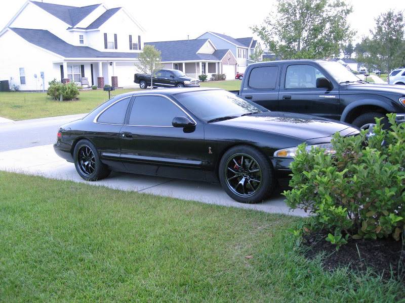

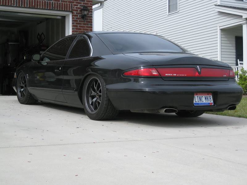

I've got 18" by 10" wide FR500's in the back with 285 tires. I had to roll the fender lips and had to trim the top bumper mount just like LaserSVT did, but now it's good and looks great. Sometimes on really big dips when I'm driving fast and turning at the same time, I can hear it rub a little, but not bad.
Here's a couple pics with the Ray switch activated and one at normal height.
The tires are just about perfectly flush at normal height, and then when I drop the car, they sink inward due to the geometry of the suspension.
Oh, and they are 05+ mustang offset at 40mm.

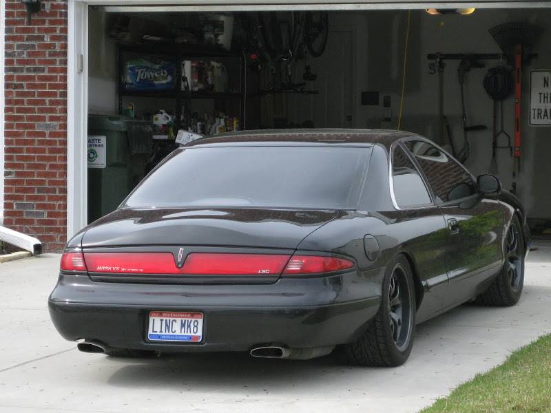

The 18X9/10 bullit wheel set I put on a MarkVIII with Air susp. sensor lowered had no rub at all with Cooper A/S 245-45-18/275-40-18 rubber. He lowered the car to the point where he didnt have to trim or roll and I thought it looked perfect. Deff not as low as Bill's car in his sig pic though.
It depends on how you want the car to sit and if its on air or a coil conversion. Too many variables to go through really because there are so many ways to skin that cat its silly. So decide if you want to trim and roll, the answer to that would open things up alot.

I can actually drive my car when its that low but not over a rough surface. :lol:
Thats just for shows or pictures, its normally almost 1.5" higher. :)
