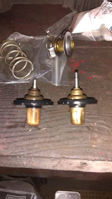

    Finally got to the thermostat... so the LS is back on the road after sitting for a couple months. If anyone remembers... mine was sticking on the way open... causing a rise-drop-rise situation on the way to full operating temps.
    I took a couple pics. One of the old and new thermostat. At ambient temp it's easy to see why the old thermostat, (left), wasn't functioning properly. It was weak... after 81k miles. IMG_20190527_132301833.jpg
    and... for those who think re-using the o-rings is acceptable... think again.
    Used o-ring on left... new o-ring on right. There is actually 1/8" difference in height between them. Sure... the old one will still seal. :rolleyes:
