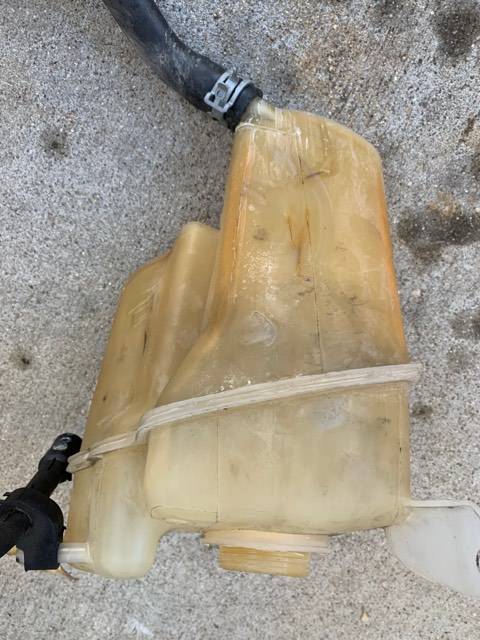

Here's a picture of my "old" degas bottle. Sure looks a lot older than 3 years...
How did it end up looking so rough???My 2001 Lincoln LS's original MotorCraft looked better than that?
That is the question I want an answer to. My parents had this car since it had 89 miles on it. I have the receipt for all the work on it from the local dealership. My guess is that they didn’t have a new one and installed a used one. The old hose clamp was on the pipe that connects the lower bottle hose.
I agree it had to be used ...no way in hell that degas reservoir was brand new out the box
In your case the old clamp on the hose is definently suspect to say the least ...but I purchased a aftermarket degas bottle brand new .....just wanted to check out the quality compared to MotorCraft ....the aftermarket hose clamp on the product I bought was so cheap it literally broke in half, after I tried to squeeze it open...so I can see why someone would want to reuse the Ford/ Lincoln clamp ...but yeah ...your parents got ripped off ....not to get off subject but many ppl on the Forum say that AMMCO does the same thing with your transmission ...junk yard pulled transmissions
The Ford degas bottles that I purchased, came with the lower hose already on, using the OEM style clamps.
Exactly .....The MotorCraft degas hose clamps should've been new on his degas hose but like he said ... The mechanic reused the old one ... Shifty
