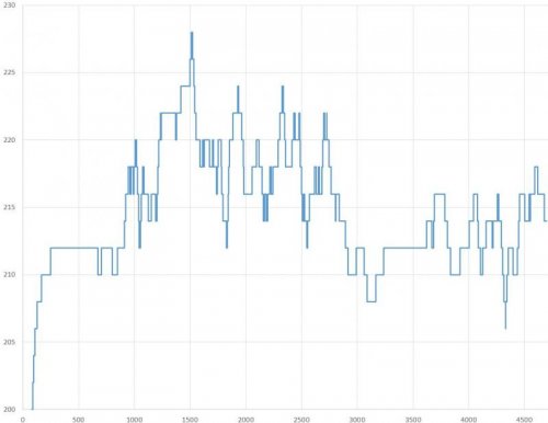

        So, I popped the intake tube off and the plastic that goes across the hood latch and blasted water through all the radiators. There were two or three leaves but nothing major. I used a piece of cardboard to clear what I could so I could see to the bottom unobstructed- at least in the area directly in front of the fan blades. Whatever the front-most radiator is for, its fins are pretty mangled from pebbles blasting it over the last 250K. I'm sure its limiting air flow to the other exchangers.
        Today wasn't quite as warm and humid, but still pretty warm... 80*F. At least 50% RH. The car ran a nominal 212*F after blasting the radiator(s). After my third of three highway merges on my ride to work, it peaked at 218 for a minute or two, then cam back down. The final test was idling at the stop light, then going wot through first gear as I did last time, then pulling off into the parking lot (A/C on the whole time). The engine fan was running on low, and it sped up ever so slightly, then went right back down low. Engine temp stayed right at 212.
        Maybe a lot of dirt came off that I couldn't see, but it seemed to make a pretty good difference. It seems that 212 is still a touch on the high side but I suspect I can get it to drop more by giving the front exchanger some love and straightening the fins. Looks like a little paint overspray from the bumper work I did too on the main radiator. If I get that off, I might get those last 10 degrees.

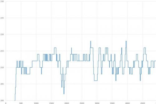

          In the last few weeks I've been running Torque all the time to watch the temperature of my 02 V8. Highway cruising on cool nights are usually 208-217. Traffic on a hot day on a highway with traffic lights or hard acceleration can be anywhere from 212-228 :(. Coasting (especially with engine braking) produces the lowest temps, about 202-206. AFAIK, I have all original parts (73k miles), with the exception of the thermostat, which came from the junkyard engine (85k miles). I plan on beginning to order the parts soon.
          It seems strange that the temperature cycles in a constant range over normal temperature. Shouldn't the fan just run a little harder? Or does the fan have some max duration/speed limit in play until it really gets hot?
          I highly doubt it. The CHT reading to numeric temperature conversion should all be done in the PCM. The dongle and app just read the number the PCM spits out

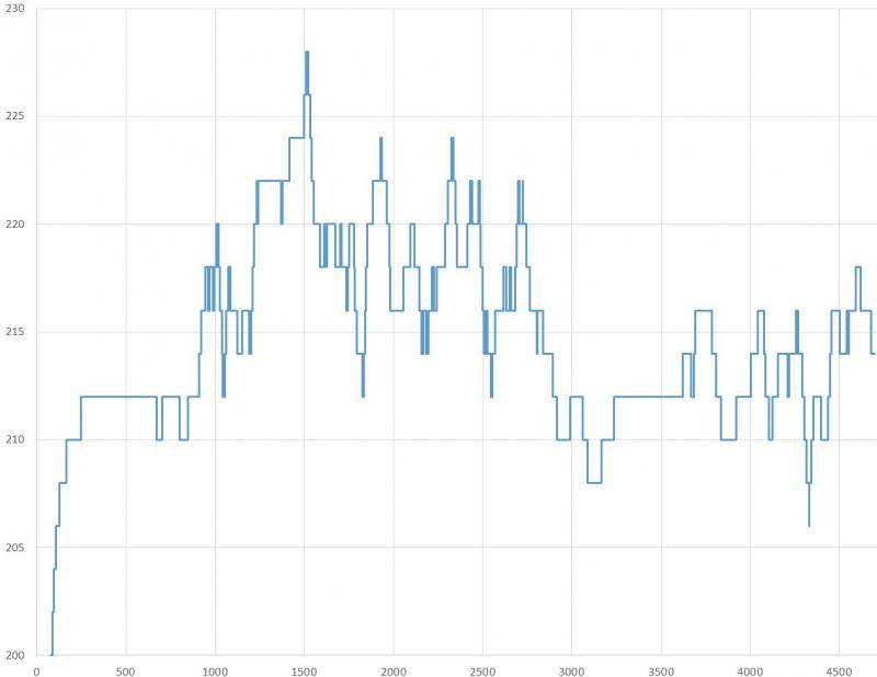

            Wanted to update this with a few data logs. I logged other stuff too, but found no correlation between the other pids. Just the generality that my coolant temps would creep up at highway speeds, and at idle would be at 212. The coolant cooled quickly when coasting at highway speed, especially if I downshifted to 3rd to slow the vehicle for traffic. I would see 205ish in that case. It got messy showing all of it at once so I just showed the coolant temp log. The second pic is the ride to work on a mild day, and the first is the ride home on a 95 degree high humidity day.

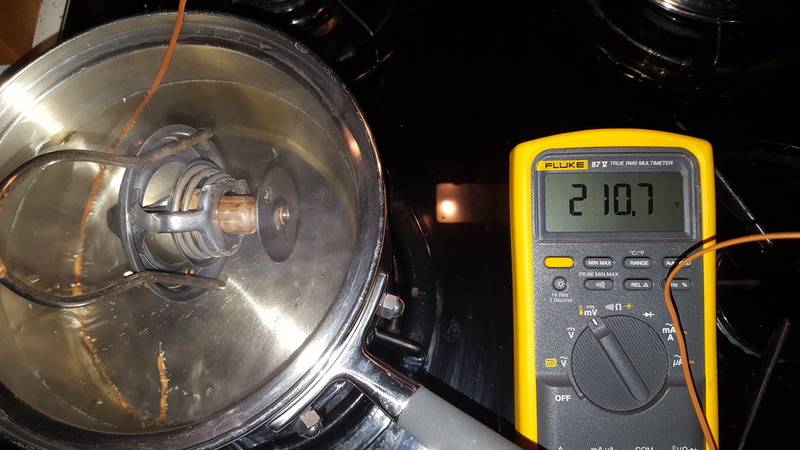

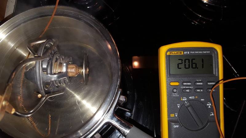

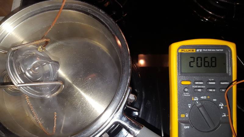

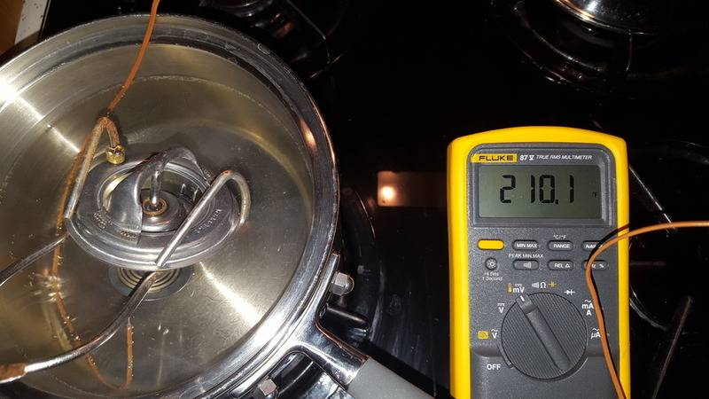

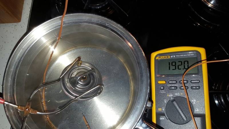

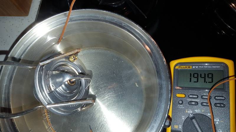

            Minor update, got a replacement thermostat. Here is some data on it...
            Ford XW4Z8575CA. Rock auto claims 190F in the description. Part is made by Waxstat. Does not come with the seal/o-ring.
            It says 84C right on it. If this is a temp, it translates to 183F
            I placed the part in water on the stove and slowly (slower than an engine heats coolant) heat up the water and took pictures along the way to show how far it was open.
            As for how %open translates to flow across radiator I can't say exactly, but I would guess flow is pretty good at 205F.

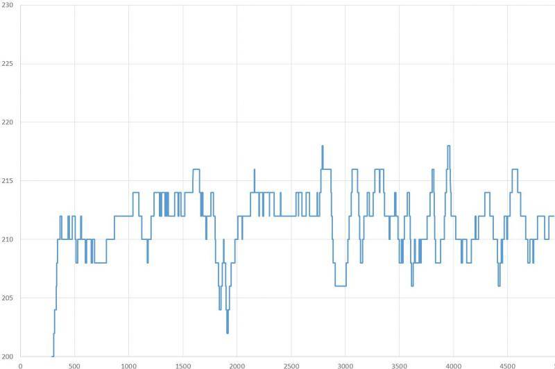

          • 02LincLS

            Looking at some data logs (without the A/C running). The fan is completely off before 185. The fan duty cycle pid is 10.53% and variable fanspeed is at 9.68%, though there is no fan motion. I was driving while I did this but didn't log speed. The fan seemed to do what it wanted unless you were going over 45mph.
            Above 185, the duty cycle starts to climb while the variable speed stays put to a certain point.
            Temp----------------Fan duty cycle
            190F----------------10.9%
            195F----------------11.2%
            200F----------------11.5%
            205F----------------11.8%
            210F----------------12.2%
            215F----------------12.4%
            220F----------------12.8%
            At 225F, the variable speed kicks in, causing the duty cycle to also change.
            Temp----------Fan Duty Cycle------------Variable Speed
            225F----------13.0-19.4-----------------9.68-19.4
            228F----------30.5-35.5-----------------35.5-41.9
            I think this puts the panic mode around 235 where fans will start screaming full.
            Having the A/C compressor run does bump up the duty cycle and variable speed. There's some fluctuation for different reasons, but a decent general blanket statement would be that running the compressor adds about 30% to the fan cycle/speed.
            Since I still have my issue of running "hot" on the highway, running the A/C actually helps move more air across the radiator and it recovers faster when I slow to under 45mph.
