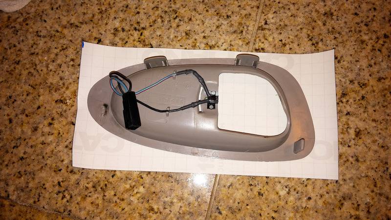

What is that wire? Do the second gen's have a light in the door handle pocket?

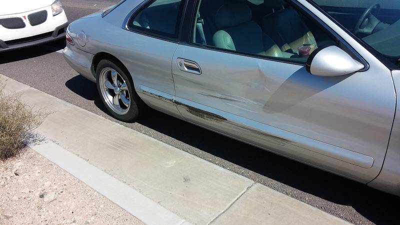

::sigh::
Drove it, and at an intersection that has 2 right turn lanes, used the left one.
The driver in the far right turn lane was headed toward the far left lane, and I couldn't get out of her way.
So do I go and plop down 50 bucks and pull the one from the 98 base in the lot (I think it has damage, but just to the surface, no dents) in anticipation of them not finding one, or will they fix this one, or will they try to re-skin it? The car in the you pull it place will only be there a few more days, if it is still there.
Will a door fit in the trunk of a Mark VIII?
::sigh::
Some of it will. Smaller end first and bring some string to tie down the lid. Oh, and a blanket or two to wrap it up in.

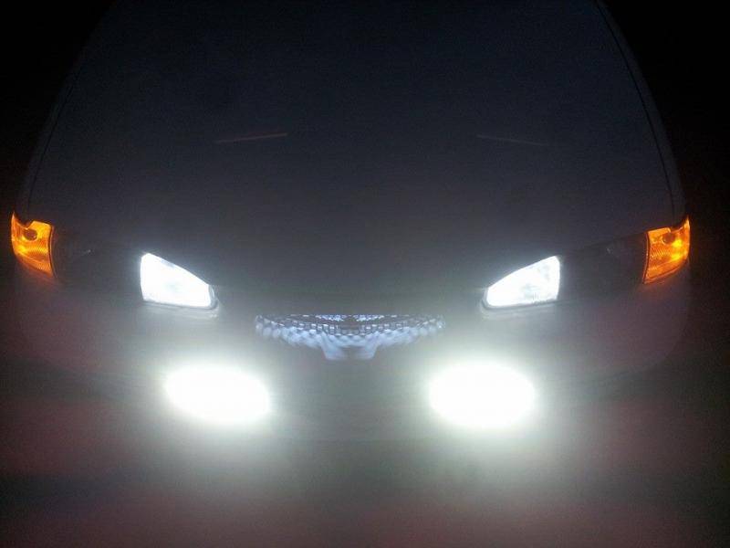

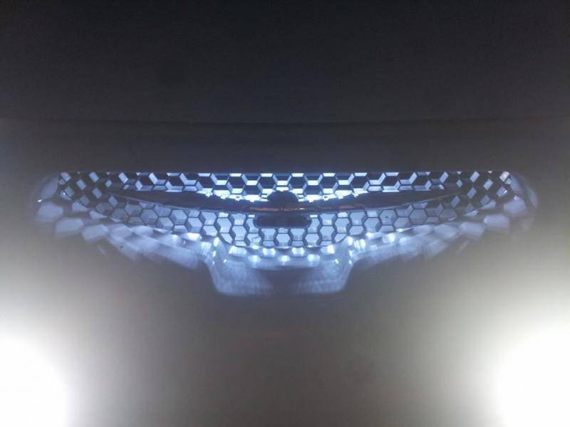

LED grille lights. I put white ones in this time because the cops said I couldn't have the blue ones. 10710605_678949688868096_3592419647871830707_n.jpg10712864_678950475534684_8876829426499280669_n.jpg10418853_678950128868052_7125782697165725921_n.jpg
