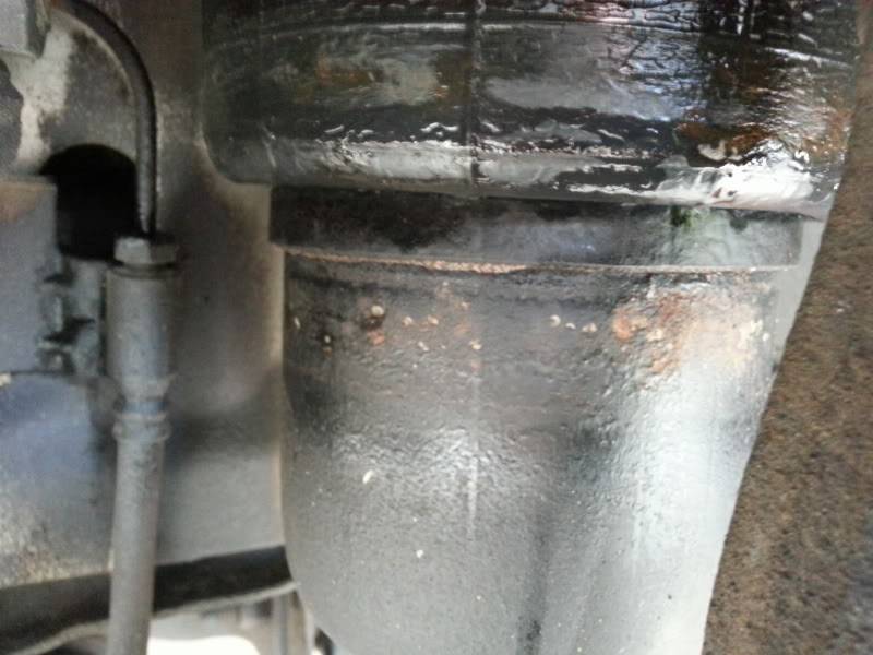

This acts as soapy water but it doesn't just drip right off, its more viscous so it stays on the bag.
Yes, I loaded the suspension on both sides with a jack stand and no bubbles.
Both shocks look like this at the bottom of the bags:
they look wet cause of the leak dector.
That bag above isn't down all the way and if it was leaking, you never would see the bubbles if it was setting at parking height. The fold can sometimes hold a crack that you can't see when the car is raised up.
This was one of the old bags that I replaced.
If this one was aired up real good, it wouldn't leak but once it settled a little, then it would be down within 2 days. You can see on yours at the bottom where the rubber is meeting the metal and the lite rust spots. The rubber can only take so much of that rubbing. If you look on mine, you can see where the rubber was wearing off onto the plastic over time. I bet the leak is in your fold somewhere.
That was after I uncompressed the shock.
I just found the problem and am kind lost as to how it happened........
Passenger side bag with the leak see if you can spot it(the leak detector kind of gives it away:
Drivers side:

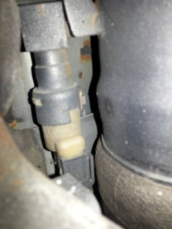

Are those connectors able to be clocked 180 out? I mean the solenoid, can it be intalled 180 degrees from where they are now to get them away from the bag. That kind of clearance does not seem right and it has been a while since I have been under my Mark.
Probably but those solenoids fit so tight that it was easier to put them in the bags when they were out of the car.
So probably.... i will not happen with the new ones:D the drivers one is still good if anyone needs one drivers bag.

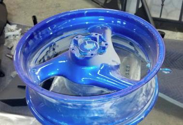

Now I'm thinking of changing rim color since I have to do 3 rims. What's everybody think on White rims on a White Mark VIII :confused:
i went to pull a part to scrounge some small stuff and noticed they had longblock on sale for $40 + a $10 core charge. i was at what i thought was the only mark at the yard which had nothing worth pulling. and my buddy comes runnin tellin me they just set one out, not expecting much i come upon a dark portofino blue/ gray int. 95 that was t-boned on the pass side and pushed into something on the drivers side. the interior is excellent and complete including cargo net and floor mats(which i might get and dye black). 98k on the odom. this car was well maintained and looks to be garage kept. motor feels good and is clean enough to eat off of along with the under carriage. so i spent all day dropping the motor(first time) and ran out of time.suspension is all new so i bought the rear shocks and rear sway bar links and got them on my 94 which made a big difference. but ill be there ready when they open tomorrow to get the motor. i might grab the grill its broke at the top but fixable and non visable
Black, gun metal or bronze would look pretty sickly on a white car.
Were Flat Black when I got em and didn't look good. So I went with Black Chrome but I'm kinda outta that Black anything point now.

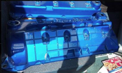

I do have a set of valve covers for the car done in Candy Blue Metallic and was thinking do the rims that color but it would wind up looking like a Street Bike possibly?
These are the Valve covers I had done at the time my Rims were done.
I saw this Motorcycle rim and thought about doing that color on my rims too but may be to ricey?
