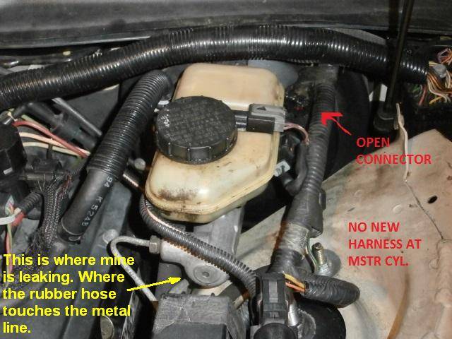

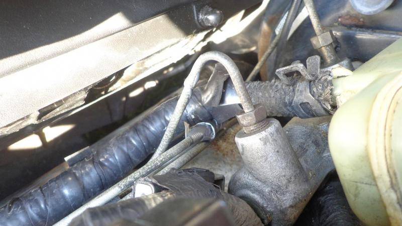

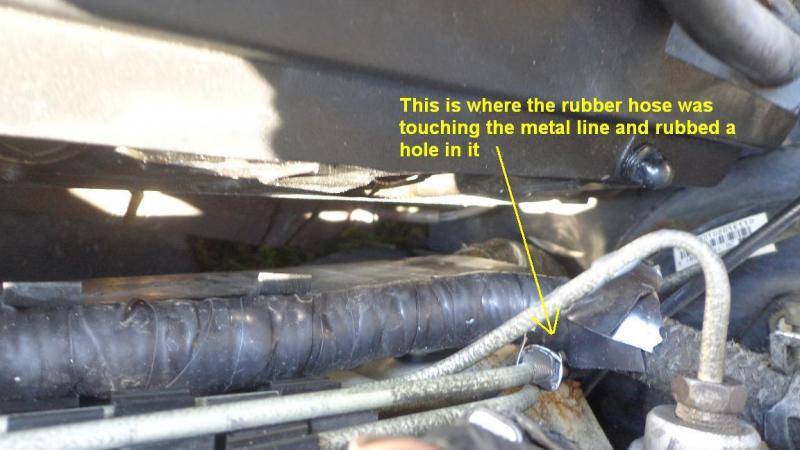

I was checking that line out on my Brown car, the car from Mich...those metal ends of the short rubber seg are rusted severely....made my stomach hurt and ruined my whole day. I still have the liner peeled back and can get better close up pix tomorrow

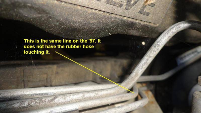

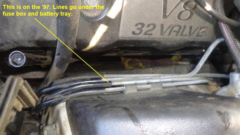

Does yours have that black rubber hose coming off the bottom of the master cylinder reservoir? That hose was touching the brake line and that's where the hole was. I noticed the '97 doesn't have that rubber hose. Looks like one of those situations where there were problems with the design and it was remedied with the GEN2 :rolleyes:
I had these pix laying around, can't really see underneath tho;
Are you meaning, where there is a rubber section in that line under the master, is leaking where its crimped together? Or is that section of line "touching" another piece of the vehicle?
If it just the hose that's leaking.. easy fix

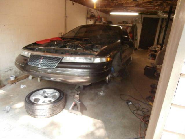

my brown car doesn't have the hood, wiper assembly, or cowls....is it safe to drive it like that?
as long as it doesn't rain!
i drove like that for a while. i was having egr issues. much easier to get to the egr with the hood off.

I put the cowls on but nothing else, 7 screws....as much as a pita as that IAC was, the EGR looks worse...can't wait to see how my mpg changes now that my bank 1 imrc vac pod works...fixin to take the cowls off and give the engine a good cleaning, new windshield next w/e

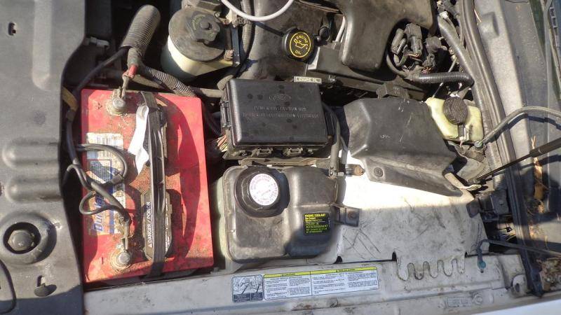

is there an cabin air filter on the pass side that can be removed, cleaned or replaced?
No, that is the air inlet for the car HVAC. Make sure the seal is good to the cowl or you wi get a water leak inside the car when it rains.

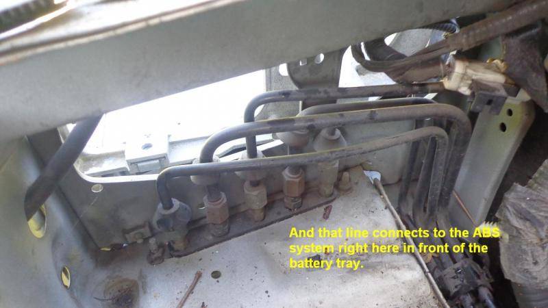

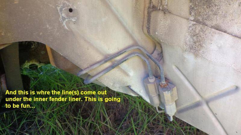

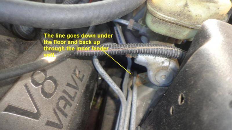

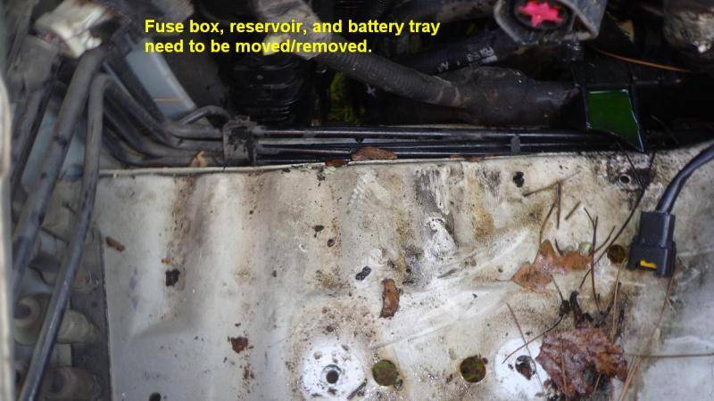

Okie dokie...here's some pics: (not in order)
DSC00709.jpgDSC00710.jpgDSC00711.jpgDSC00712.jpgDSC00713.jpgDSC00714.jpgDSC00715.jpgDSC00716.jpgDSC00717.jpg
I thought at first it was the rubber hose leaking. But unfortunately, it was the metal line that the rubber hose was touching. It's hard to believe that a rubber hose could rub a hole in a metal brake line. But it happened. Now the problem is going to be removing and replacing that line without bending or crimping or breaking it at some point. It has more than ten bends in it :(
