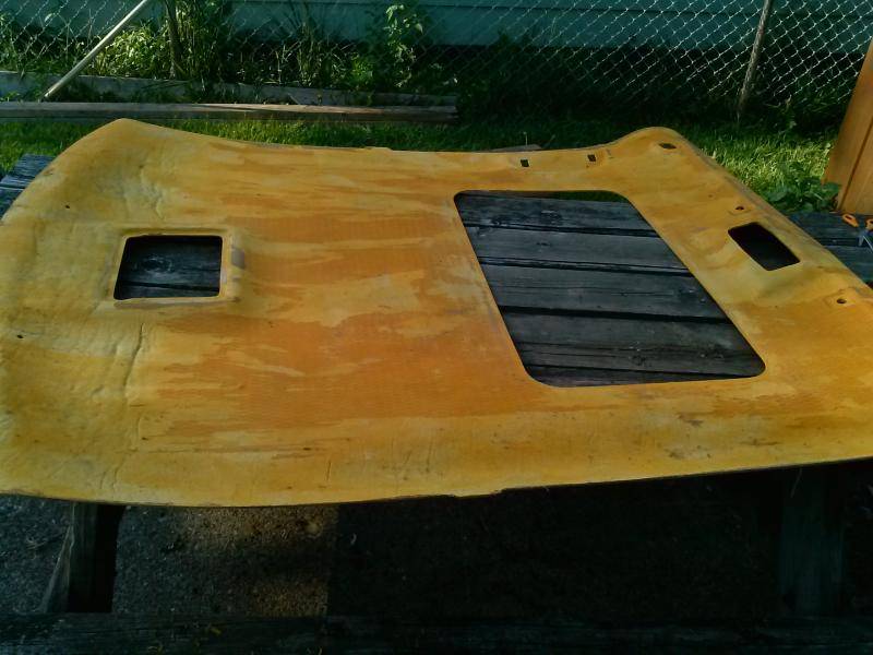

#2 once the headliner is out lay it on a flat clean surface and start stripping all the old headliner and foam backing. This is very time consuming I used a plasic bondo scraper, and gently used a wire brush (do not scrub hard) also gloves are recommended I found this the hard way with a thousand little pokes from fiberglass off the fiberboard. it should look something like this when preeped CAM00348.jpg

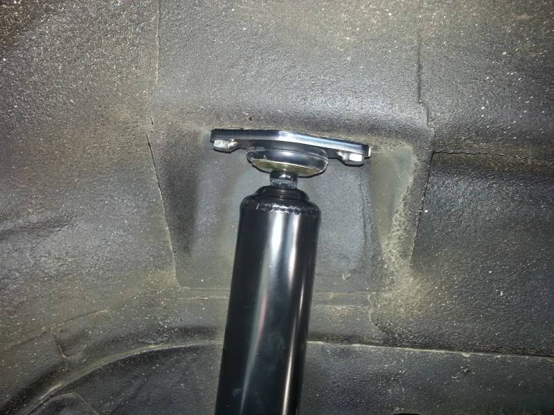

I like mine. Had them on for three years now. The stock shocks I had before these were knocking in the back and about to drive me insane. They found bumps and rattled when I never even seen a bump. Been quiet now for a long time since the Sensatrac's. Hard to beat that price on them. My mounts were $50 shipped, maybe $40... Can't remember.

I would have to agree. Might not be the best shock in the world but it sure felt like it to me and still does lol. Some of the guys and girl on here might corner hard but I pretty much keep it on the norm. I do need to change bushings though. Had them for a year or so now but just haven't wanted to mess with it. The ones that come with the Sensatrac's will start making a creaking sound when it vents to park height so, be ready for that. Not bad but can get annoying sometimes.

Hey Evan, did you order those shock mounts through american air? I need a set for my car, noticed the original ones were starting to deteriorate when I swapped to coils last fall.
