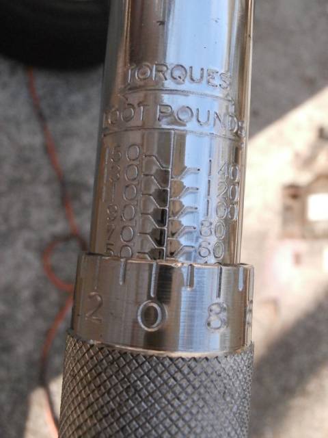

looked at the wrong line and overtightened a bolt :mad:

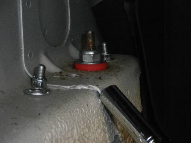

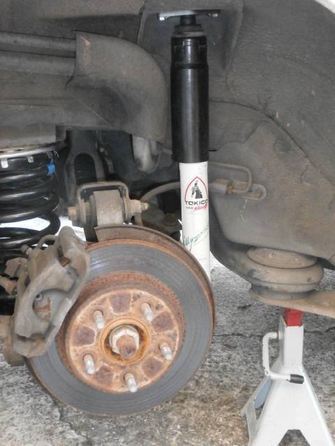

who makes those upper rear shock mounts? I called around when I did the springs in my car and intended to replace them but no parts stores carried them..I assume these are one of the many discontinued parts for our cars??
I may just have to make a few of those. You can just burn all the old.bushing out of the stock one and bevel the edge of the bushing for the top.

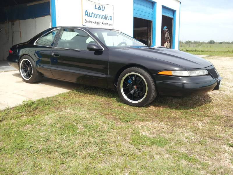

Must be a beech to remove/service first time around. Your Mark 8 is really sweet! Black rims are cool! If I ever get that far I would like to replace the stock 16's I have with 17/18 inch wheels. Still have work on the IRS that needs to be done. Nervous abt that!:)
