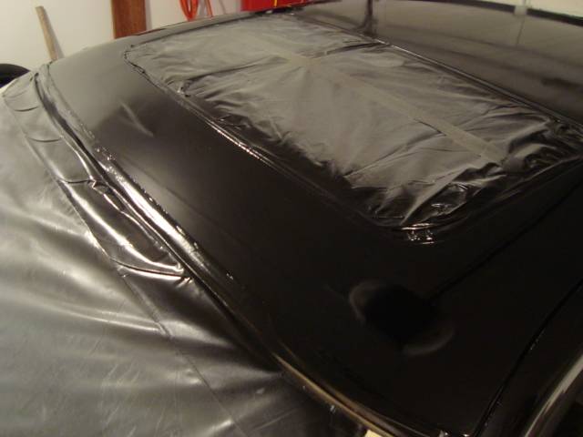

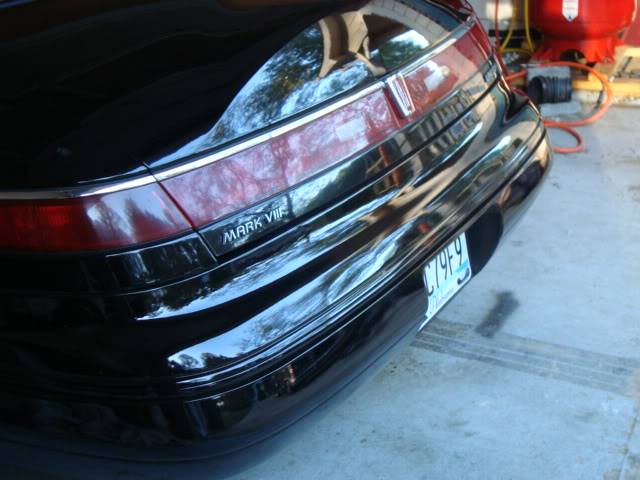

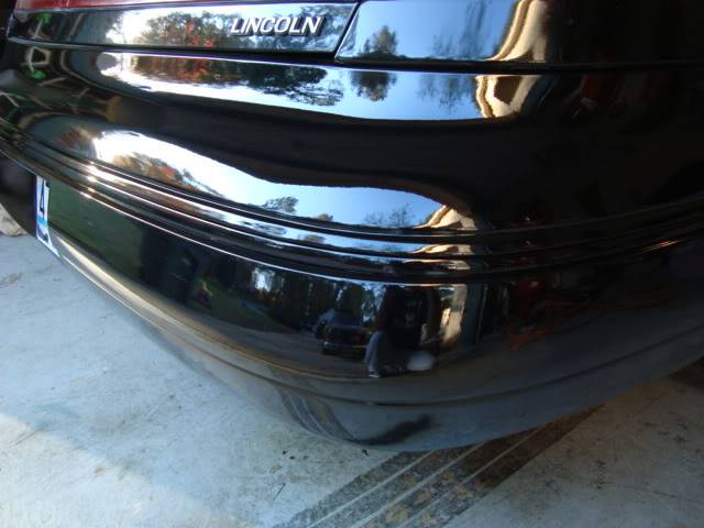

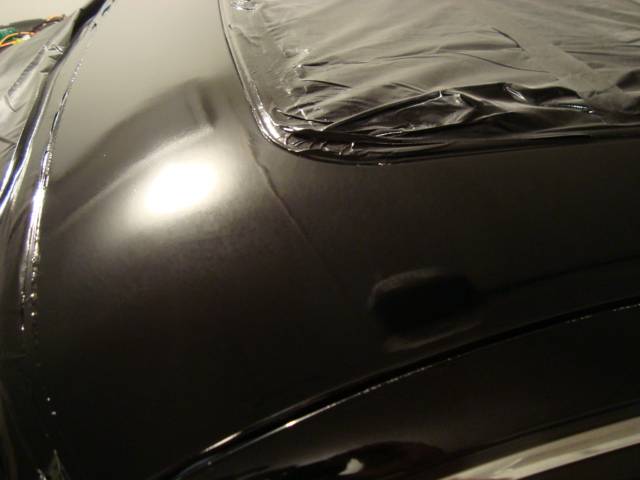

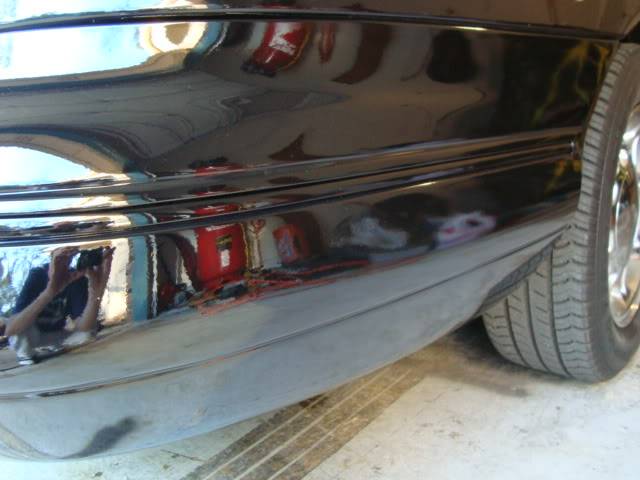

What I done to the black car took some work and I used Dupli Color acrylic enamel primer and paint and clear coat.I done all of the wet sanding, polishing but the top cost me about $30 and the bumper cover cost me around $30.
Before
During
After and this was before wet sanding the orange peel out. I actually got it way slicker than this.
This was also before a final polishing but the top came out wonderful. I had before pics but lost the card they were on and the hosting service that had the pics went out of business. It looked bad.

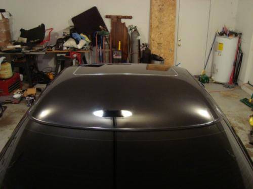

This was before the car and garage burned and none of the clutter is mine. That was my dads stuff. Anyway, the paint job turned out good for what I had in it but it was hard work. A whole lot of wet sanding went into making it slicker than what you're seeing.
