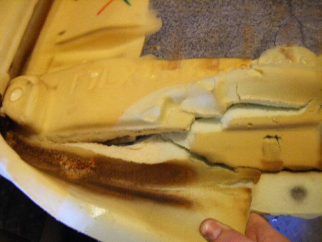

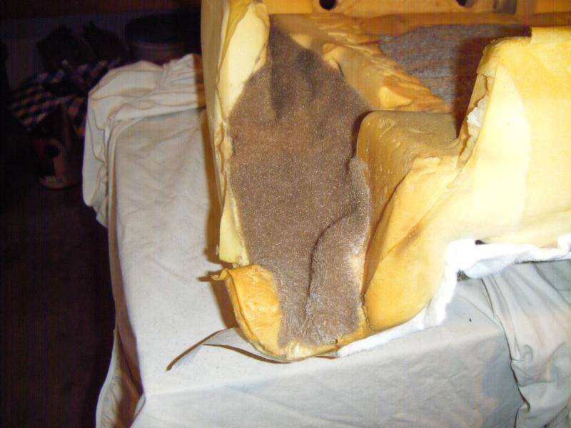

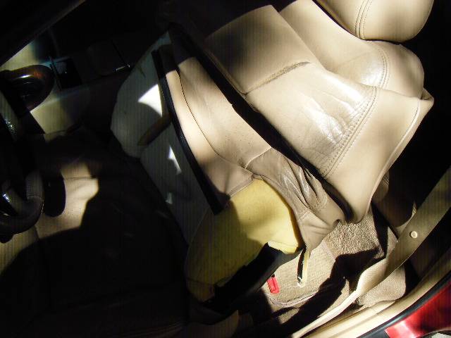

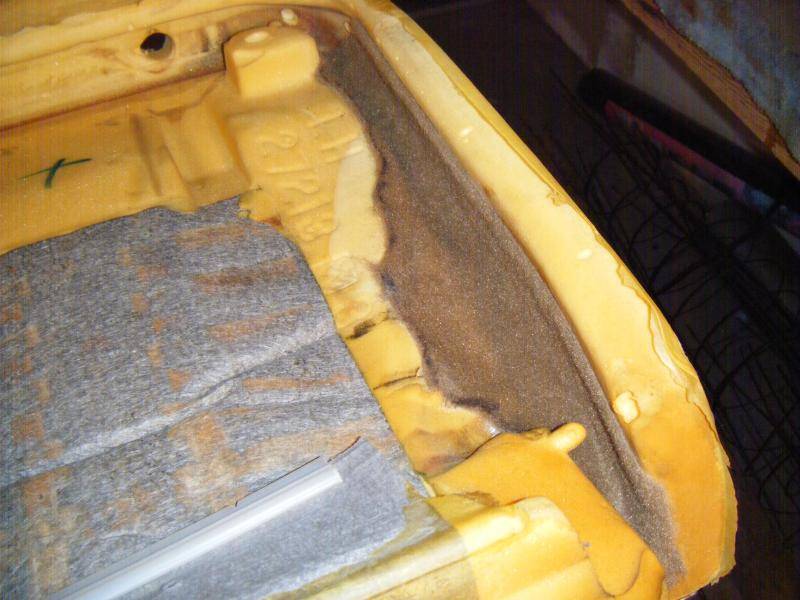

Well the back part of the seat I put in last weekend failed me. I ended up putting my old one back together. Sprayed in between all the seperated foam cracks and let it firm up overnight, then layed some material down to reinforce the backside to prevent anymore cracking.
The last pic is the one I put in last week. Should've known better.

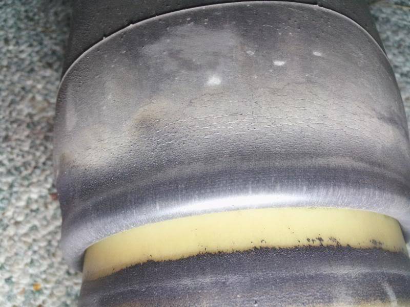

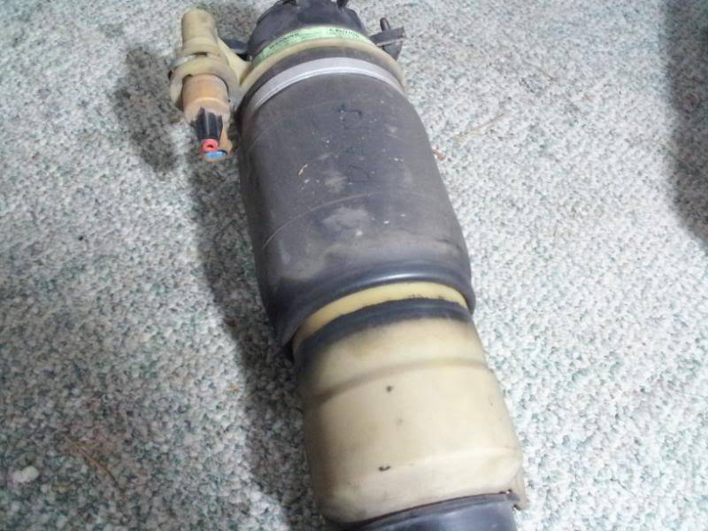

I'm sure these could be had for cheaper from someone else. I haven't really done much searching for rears. If nothing is wrong with your compressor, then deduct that from the total cost but if the front is dipping now, it's only going to get worse with time, especially when it gets cold out. It will slam within hours. Here is what the front bag looks like on the bottom, where the fold is, after 14 to 16 years. <---Get that??? Get new ones and that's what you're looking at with new air ride again. Many years, drop free!
Get new ones and this is how it will be.
