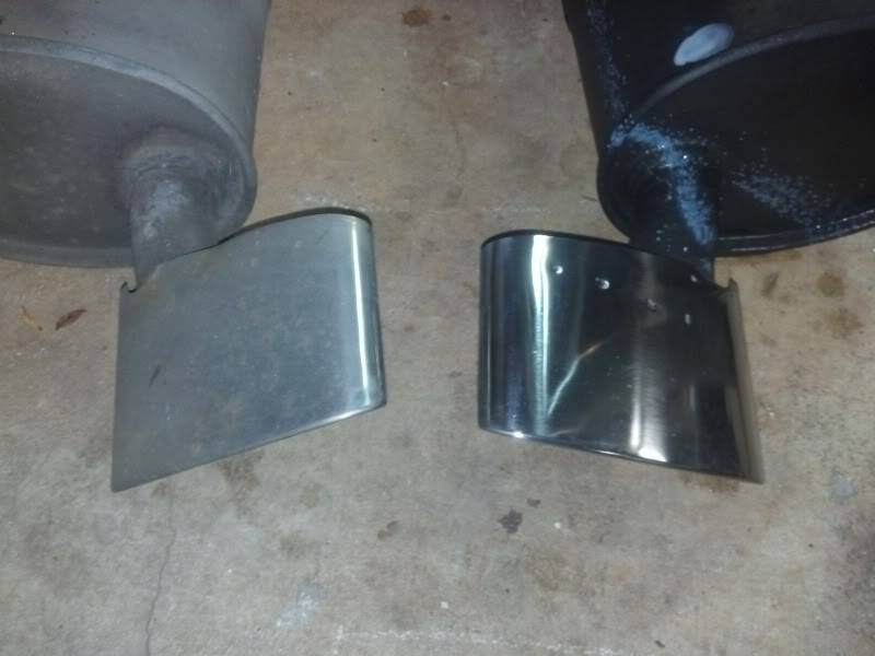

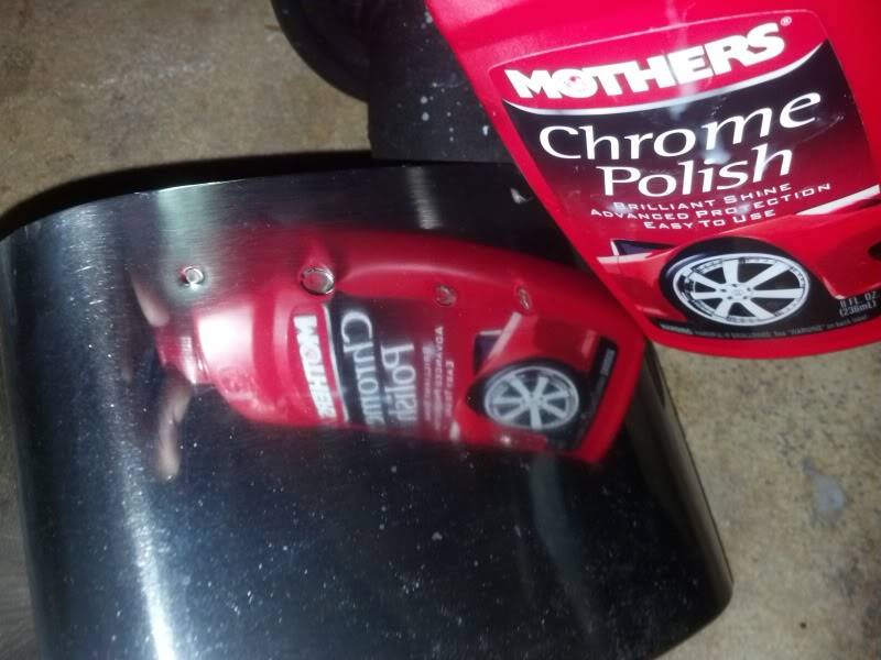

Looks good. I polished mine before I put them back on last year. They shine up nice.
Did you paint the muffler as well? Something I wish I had done.
