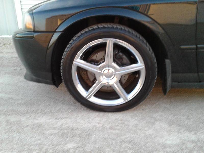

Those look pretty good!!!! :) :cool: :burnout:
Me thinks you may be slightly biased! But that's ok man. Thanx for deal.

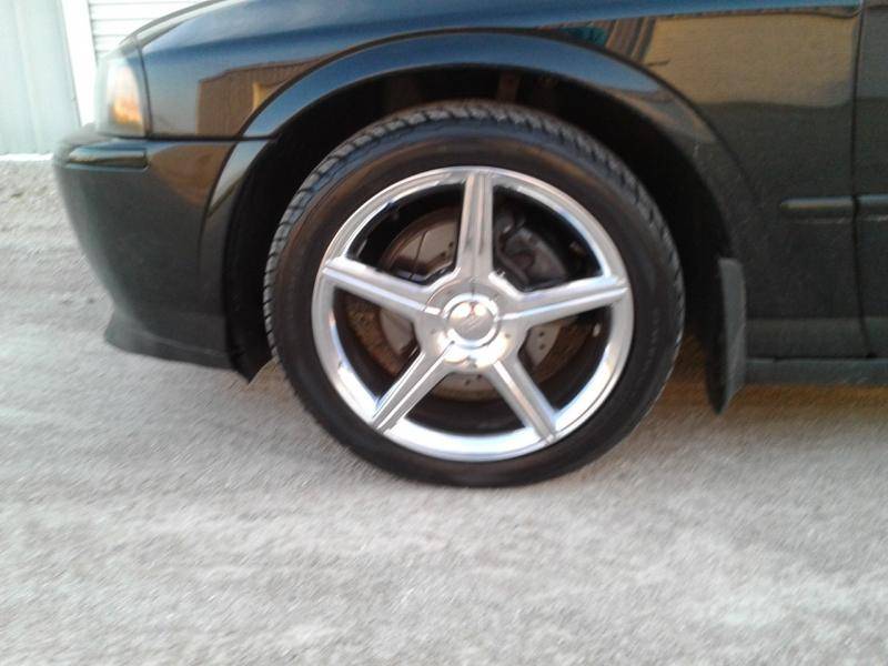

Now, the damn rotors look WAY too small!

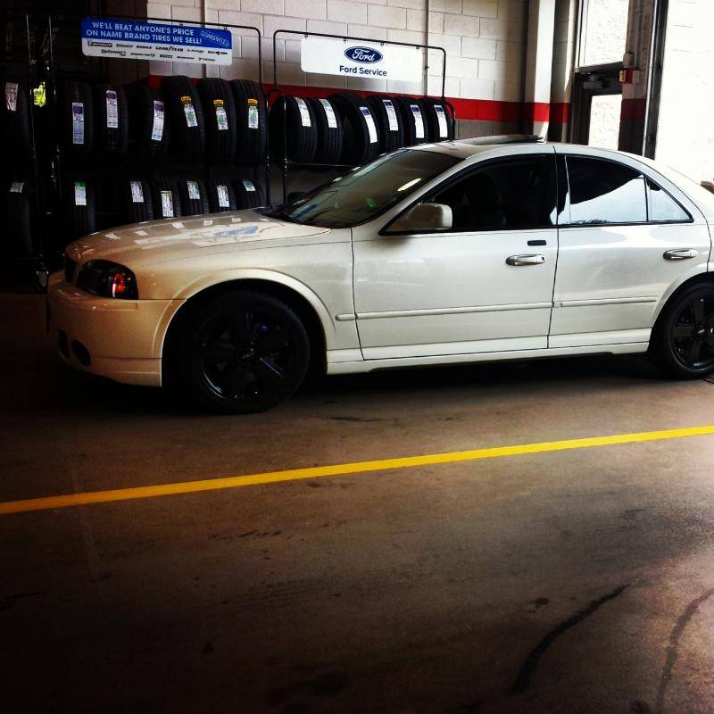

Stupid question. These tires are about 7/16" bigger in diameter than stock. Would you think that would cause the ETC failsafe mode?
what size tires ? and time for that jaguar caliper bracket upgrade
Dealership said I had to use 245/40-18's. I wanted to use 235/45-18's which would have been almost identical to O.D. of original tire.
I wouldn't think 7/16" on the diameter would make much of a difference.
IMHO, 245/45 is a much better size, though 235/45/18 is actually closer to stock.....
Yeah, I agree. The slightly larger tire looks better but I was afraid of tire size throwing something off. And since I've never had this message before, even with all my other issues, it makes me think it could be the tires. Since it just popped up pulling out of the dealership right after the tires were mounted.
Getting a slightly smaller diameter makes your car quicker on acceleration.
In my experience, the ETC Failsafe error is at least one bad coil; usually #4. I didn't want to play chase-the-bad-coil so replaced them all, along with the plugs.

LS4me, an unplugged sensor will cause the Failsafe mode message also! not sure which sensor had to be unplugged to put wheels and tires on.
Kinda what I thought also. An attempt to make some more money? They didn't try to sell me anything or make any excuses. He came out, handed me my keys and said you're all set. I asked him what it was and he said the tech left a sensor unplugged.

Wheels and tires look awesome. Ride is a little stiffer than the stock tires and rims, which I'm ok with. Don't mind the bumps and stuff as long as the ride is stiff but quiet. Probably put the KKM back on today or tomorrow then go to exhaust shop to check into upgade on that!
