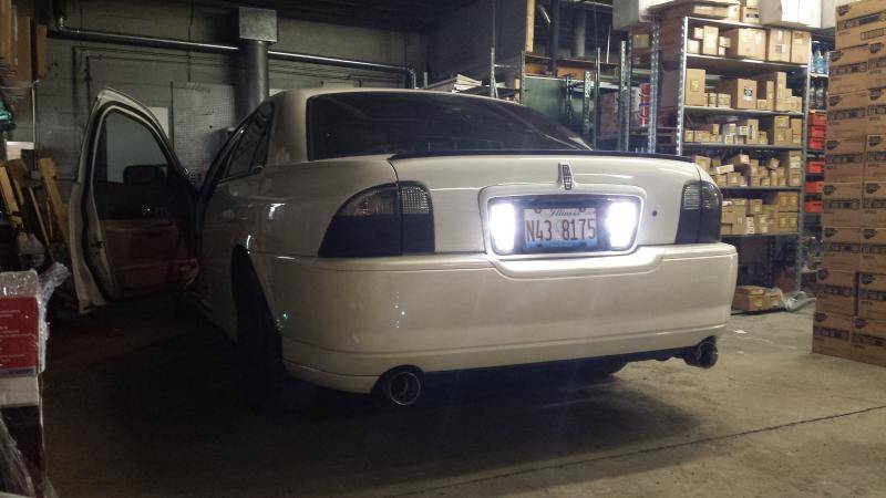

going to install my reverse lights today

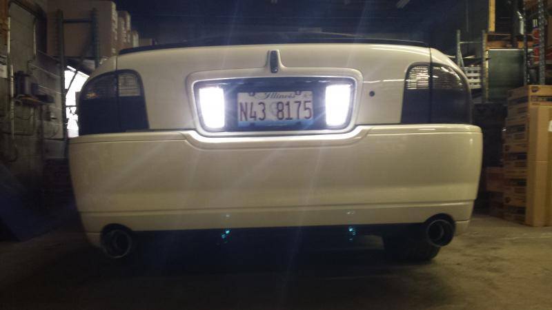

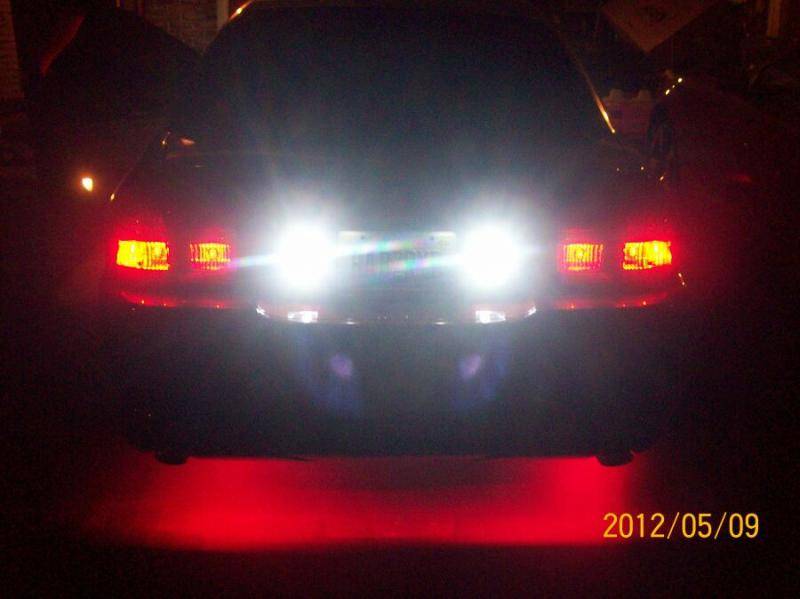

Ghost, did you have to solder in resistors on your reverse lights to get them to 'turn off' and not generate codes or were those plug and play? Looks like they are very bright!

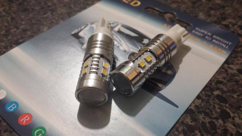

I had to pull my LED back up bulbs back out cause they stayed lightly dimmed but
no bulb out error, would like to revisit and get past this "resistor needed" problem.

I assume that the dim light when it should be off bothered you?
They would turn off completely about twenty to thirty minutes after you last did anything to the car. They aren't running the battery down. There's less power being wasted in them than in the regular bulbs. (They just won't glow at that amount of power.) The load resistor will actually increase the amount of battery power being wasted, but it will deprive the LEDs of enough power to glow.
no sir , i just plugged then in , they do not stay lit , no codes or anything , they are very bright for 10 watts

Just get bulbs from v-leds.com and you will be fine no message not dim no nothing
The glowing LED problem is residual power in the circuit. Think about a laptop computer with a transformer in the power cable. When you unplug the computer first, then the wall power, the LED on the transformer stays on. If you then plug the power line back into the computer, the light goes out almost immediately but if you just leave it it'll take forever to lose power. It occurs to me that the glowing LED problem may be just a similar loading of power on the wiring. Yes, it would not be as much power as a transformer/rectifier but is apparently enough to keep an LED glowing.
Anyone who does know basic electronics feel free to correct me on this because while I work on high tech telecom gear I don't ever mess with componentry. I've not had any basic electronics training or any need to use it since 1989 :D . Anyway, my thinking is that a strong resistor (like 5K - 10K) can be wired from the power wire to ground, attached between the switch and the LED. When power is on, power would take the path of least resistance so would flow through the LED to ground. There would be a very small amount of power flowing through the resistor but since it would be a strong resistor, power flow would be very low. When power is switched off, the LED would now have two paths to ground, one on either side of the LED. Even though the resistor would be very resistive to current flow, it wouldn't have a lot of current to move. This should drain the power out of the LED very quickly when switched off, ending the problem, while not putting the large drain that an in-line resistor would add.
Now I don't have this problem so I'm not going to experiment, but if anyone does want to experiment to see how this would work I would strongly recommend building a circuit to test this, not test this directly on the car. If something didn't work right you don't want to smoke your car's wiring.
The glowing LEDs are caused by the intentional "leakage" current that the REM and FEM source to the lights. This current is being sourced so that the REM and FEM can detect if there is a light connected or not. After the car goes to sleep, the REM and the FEM shut these sense currents off. The sense/leakage current is not nearly enough to cause any glow from a normal bulb, but it is enough to get some glow out of an LED.

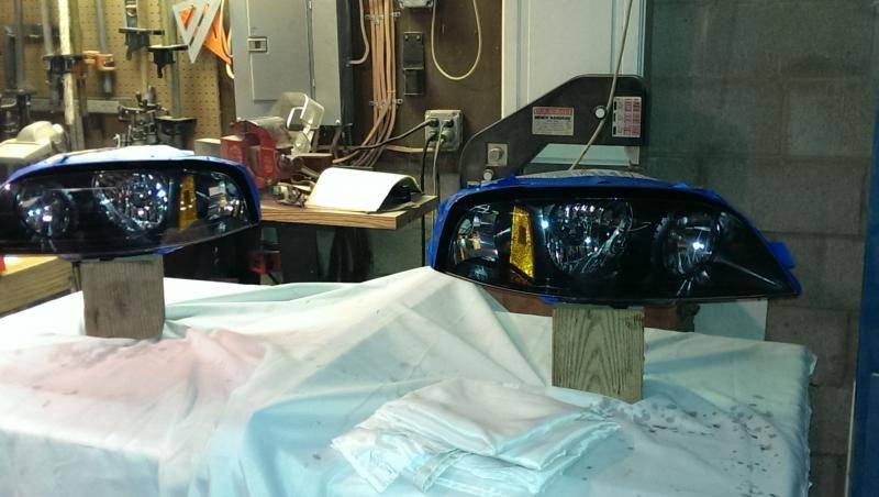

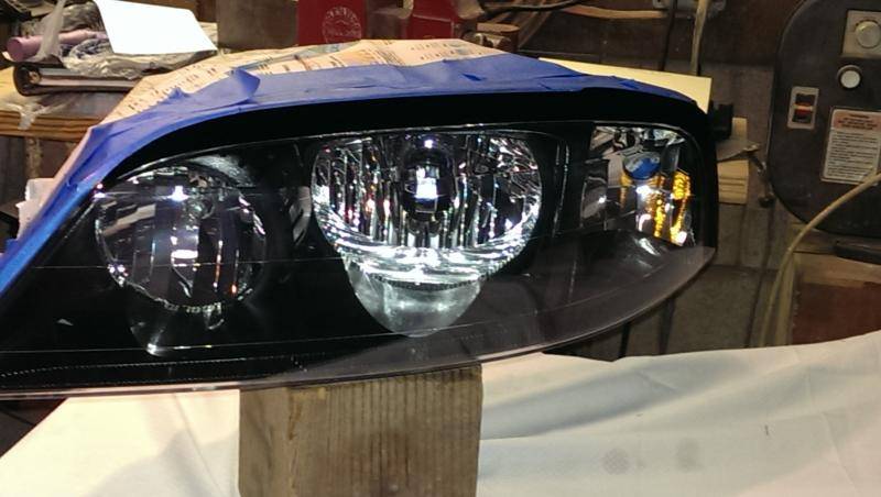

Refinished the lights.....again.
