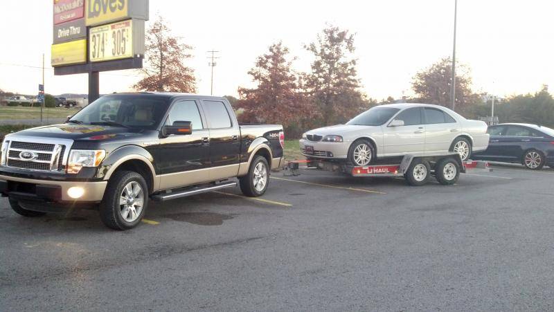

Well i finally hauled my LS to my buddys to get it fixed So i wouldnt have to pay $900+ in labor for a shop. Time for new valve cover gaskets, plugs, and alternator. Plan to have it back on the road before Christmas!
