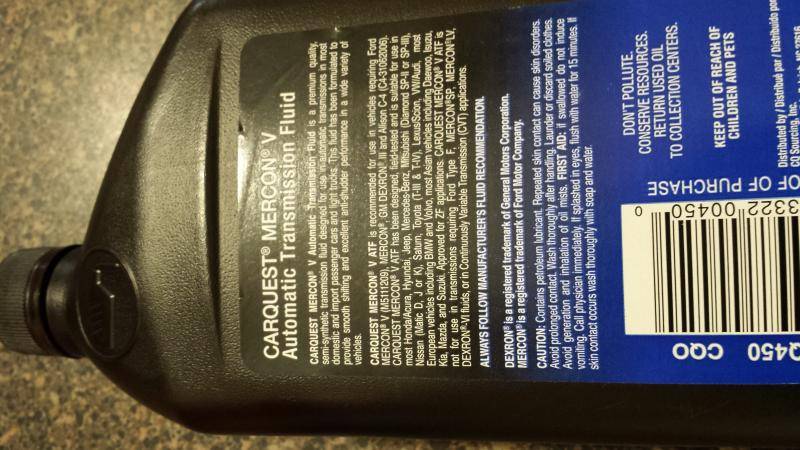

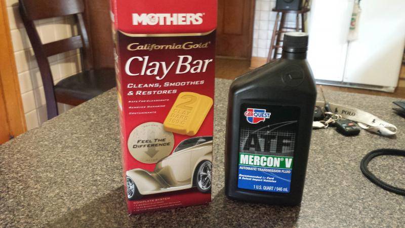

Claying it today and have to add power steering fluid to it , I got mercon v trans fluid from carquest , is it the same as motorscrafts mercon v to put into the power steering ?
