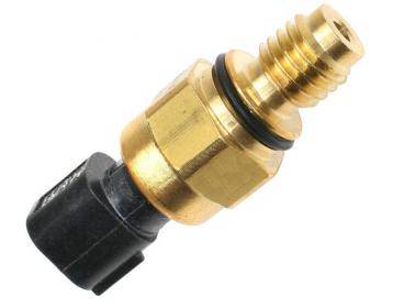

Does the part you bought resemble the 3n824 in this diagram? Because other than a different size nut, it seems pretty close
http://www.fordparts.com/Commerce/P...2&search=true&year=2002&make=Lincoln&model=LS
That link goes to the homepage for some reason. This is the part I purchased:

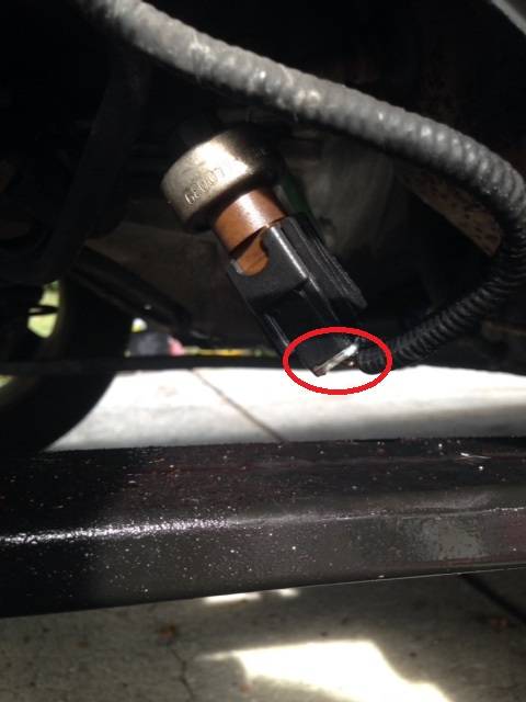

But I am also concerned that it is seeping through the plug itself. Should I also replace this plug or just try to clean it out with electrical spray cleaner?

I doubt it's leaking directly from the plug itself, most likely you'll solve the problem by means of installing this new sensor. You'll be alright. Just clean up the cable connector that plugs into it. It most likely only appears to be leaking from the bottom of the connector as it's mounted upside down and gravity allows the PS fluid to drip down along it. See the rubber seal further up long the threaded portion of the sensor? Drip ... Drip ... Drip ... all along the bottom toward the connector.
Actually, it probably is leaking through the inside of the pressure switch. (That seems to be the usual failure for them.) Anyway, the repair is the same. Replace the switch and clean up the harness connector.

It actually is leaking right through the plug itself. See the little gray piece at the end where I circled it? That piece moves about and pushes into the plug. That is where the fluid is coming through. There is none on the outside of the piece.
So you are saying I got the correct part and it just looks different from the factory switch? Sorry to be so dense. Just want to make sure before I go back and get under the car with my spine issues and sciatica. I'm still paying for doing the wheel hubs and pads on sunday.
No, that's not what I am saying at all. I was just saying that you are correct in saying that the switch is leaking on the inside and the fluid is coming out of the connector. This is not an uncommon way for that part to fail.
There were two different pressure switches used. AFAIK, it is random as to which one you will have. What is that one screwed into? Is it in the middle of the high pressure hose? Is it on the rack? Is it on the pump? You may have to buy a new high pressure hose.
I will have to look. I want to say that it was connected to the hose. But above that round aluminum part that has the part number on it it is shaped like a nut. As if it will come out to in order to be changed. It isn't apart of the hose itself.
Additionally, my car was built on 06/21/2000. Right at the last part of the 00 year production. If that means anything.
To begin with, Ford sold the hose with the pressure switch as an assembly. Now they are selling the hose and the pressure switch separately. I do not know if the size of the pressure switch fitting in the hose changed or not. I would assume that what worked on a 2001 S-Type, should work on a 2000 LS. If the electrical connector fits and it correctly screws onto the hose, you should be good. If that doesn't work out, the worst case would be to buy the new "service" hose and the new "service" pressure switch. Unfortunately, they want a lot for the new hose.
That's how it failed in my wife's '06....... I replaced the sensor with no issues; other than access.....
Near as I can tell, the P/N is/was F3TZ-3N824-A.....
I called Parks Lincoln here in Tampa, FL and they do know which one it is. The guy I talked to said that he was familiar with this issue on the LS as they just had one come through a month or so ago with the same issue. He stated that the part number in the system, he feels like, is incorrect as they had to order a different part but couldn't recall what that part number was. This is so much ridiculousness for such a stupid little part. I'm going to get back under there with a little mirror to see if I can get the rest of the part#. He did mention the same part# you show as well. Isn't yours a GEN2?
