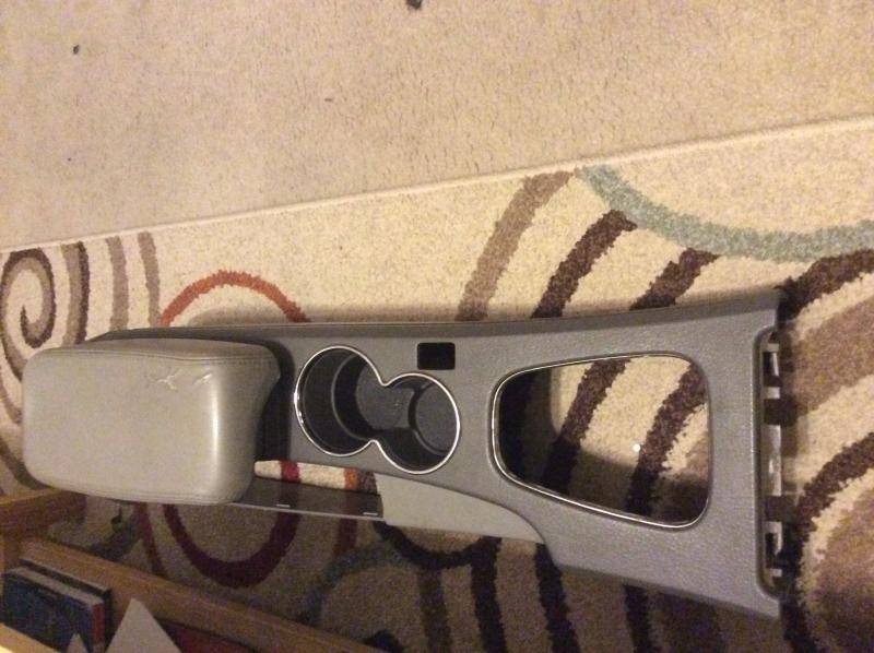

My center console latch broke a few months back. The little round shafts on each side broke off. I would guess this is a common LS problem.
I tried the usual Superglue repair last week and this lasted a day. Superglue just isn't good for repairs that put sideways stress on a part. From old modelling work I think there are a few varieties of superglue and accelerators that might work, but in general plastic and super glue is not a solid repair
So, this weekend I was putzing around in the garage looking for some other glues or what have you to try to fix the latch again, I was thinking wire or nail as a new shaft.
My eyes glanced over a box of Pop Rivets. AHA!. The metal shaft would work fine and the rivet itself on the shaft might even work well as a bearing surface. Even the rivet collar might work as a side bearing surface for the latch.
The rivets I had on hand were the usual big box store pop rivets, 1/8 inch if I recall. I used the shortest rivet size that I had. I did not measure the shaft but eyeballed it and chose a 0.078" drill bit from my kit. I also used a hex head mounted 1/16" bit to create a deep pilot hole. The next size up drill for my driver was 3/32 which is maybe too big and probably would require glue to keep the shaft from falling out. In my mind gluing the shaft defeats the possibility that I could replace the rivet in the future if it failed. Drill size is not critical, just a nice press fit is what you want, without making the plastic too thin.
I put the 0.078 inch bit in a pin vise for the final hole. IF I had a electric driver compatible drill bit of that size I would have used that, but I think this size is not common in those driver kits. The size of final bit may vary depending on what shaft size your rivets use.
I used a small electric screwdriver since it would turn slowly and allow me better control than a potentially dancing high speed bit. You could also use the appropriate size bits in a Pin Vise, but it would be slower. You could also use a regula slow speed drill if you don't have a pin vise. The pilot hole makes it safer to drill the final hole at speed.
I used the 1/16" pilot bit to drill as deep as the bit would allow. You MUST Keep the bit in line with the latch material so it stays centered. Drill both sides. MAKE SURE IT IS CENTERED WITH PLENTY OF MEAT TO SUPPORT THE SHAFT.
Then I took my 0.078 and finished the hole.
Before you insert the pop rivet shaft, I recommend shortening it a bit so that the two rivets don't interfere. Also you probably should use a Dremel tool sanding disk or stone to flatten the collar of the rivet so it doesn't interefere with the mounting slots of the latch in the console cover. Half moon grind is about right. Depending on how long the rivet is, you might also need to shorten one of the rivets to fit the shorter mounting slot in the console cover. Test fit to be sure.
The shaft of the rivet was a press fit that took some decent finger pressure to press into the hole but it was a perfect fit. It is easily removable too. Be sure to orient the flat side of the rivet so it doesn't interfere with the mounting slots of the console cover. You CAN do the grind after pressing into the latch and test fitting to the cover if you like, or twist to correct rotation.
Once it fits in the slot, just screw the covers back in place and Viola!. It should all work and as long as you didn't drill the hole out to too thin a wall, the latch should be stronger than original.
I would guess this fix cost me maybe 10 cents and required the use of a drill driver, and two bits that either mount in the drill driver or a pin vise to hold them. No glue is needed unless you were forced to use a larger bit than the shaft. All the screws are Torx head, forget size but the same. Removing the cover from the console allows easier work and trial fitting without body contortions. You will need to remove the console cover plate and the smaller latch cover plate, then the latch should just fall out. Also note the tail of the latch goes under the cover rather than over as might seem logical. If you get it wrong, you will know since the latch cover won't screw down otherwise.
A cheap easy fix. I am cheap and love cheap fixes that work, especially for the LS parts hog. You could also just use a nail or wire instead of the rivet, but the rivet with the shaft looks cooler, and the diameter of the rivet fits better.

I used a nail and super glue! Cut in two pieces and drilled about 1/2" on each side. Did it in May 2013 and still going strong.
http://www.lincolnvscadillac.com/fo...Broken-Center-Console-Latch-Gen-2-replacement

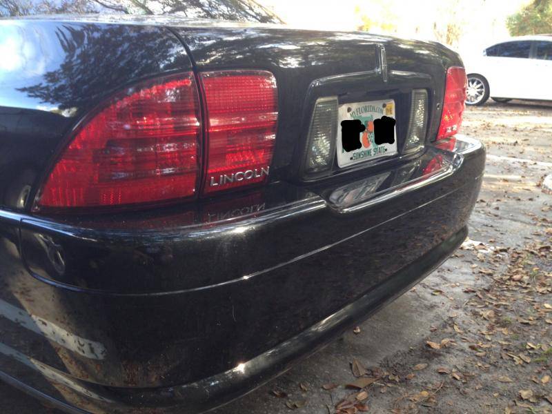

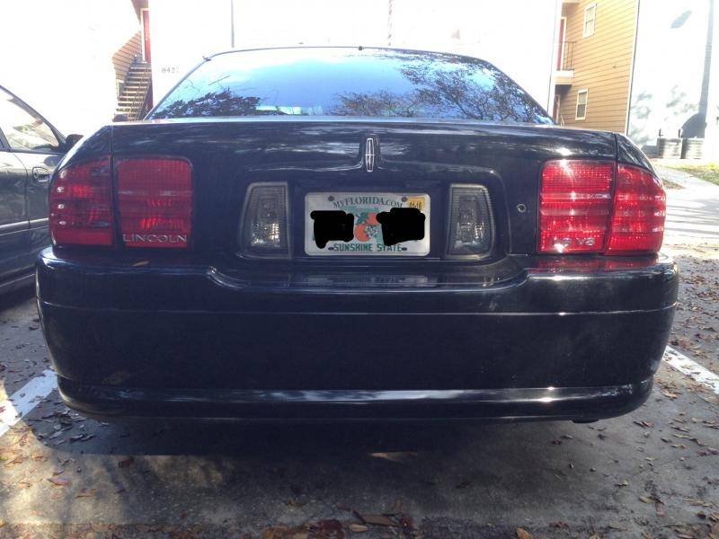

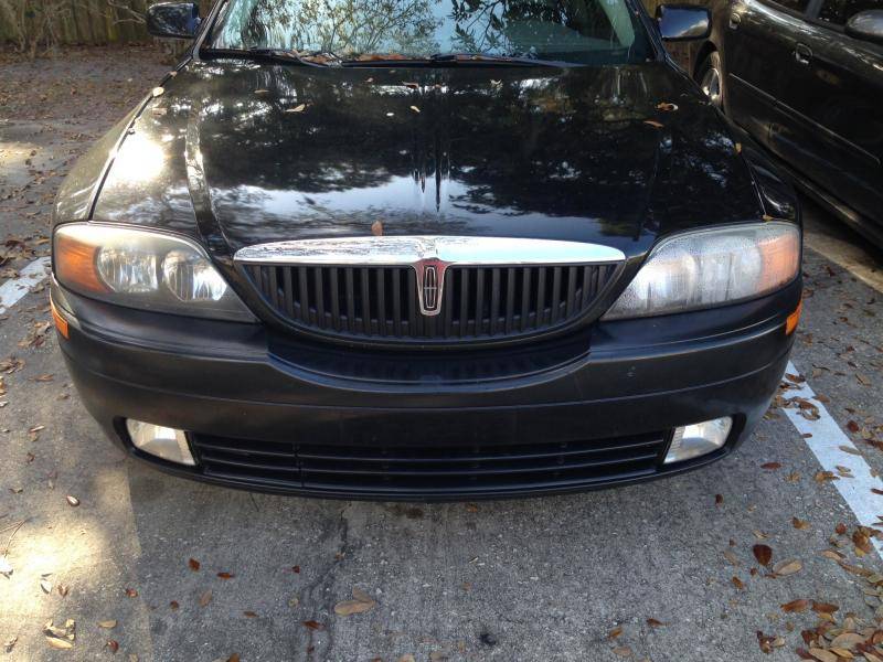

Received an installed my ebony rear surround. It does wonders to get rid of the chrome. Now I just have to find the ebony grille.

Izzy, I was wondering about that surround in your senior citizen doppelganger post. It really makes me want to stink up the house and paint mine indoors :/ If you get the grille chrome, I'd recommend getting the baleen teeth as well and either painting them black, having someone paint them, or try out some of the blackening stuff for faded trim. It makes a big difference on a black car.
I wish I could find my emblem with the blue crest, though.

The surround I have on my car is black from the factory. It was never chrome. The reverse lights are tinted a slightly darker shade as well. It looks like it is original instead of plastidip which looks like, well, plastidip. I'm going to be patient in waiting for the front grille if I can find it in ebony before going the route of having a shop paint it. I have a fear if I do it myself it will end up chipping or something and that would just piss me off. LOL.
Same here...but come this spring, I'm going to give it a go.
