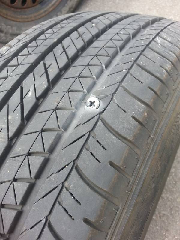

Pulled a nice size nail out of the drivers rear tire today.

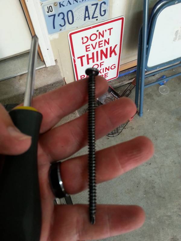

I did the same with a construction screw the day before yesterday.

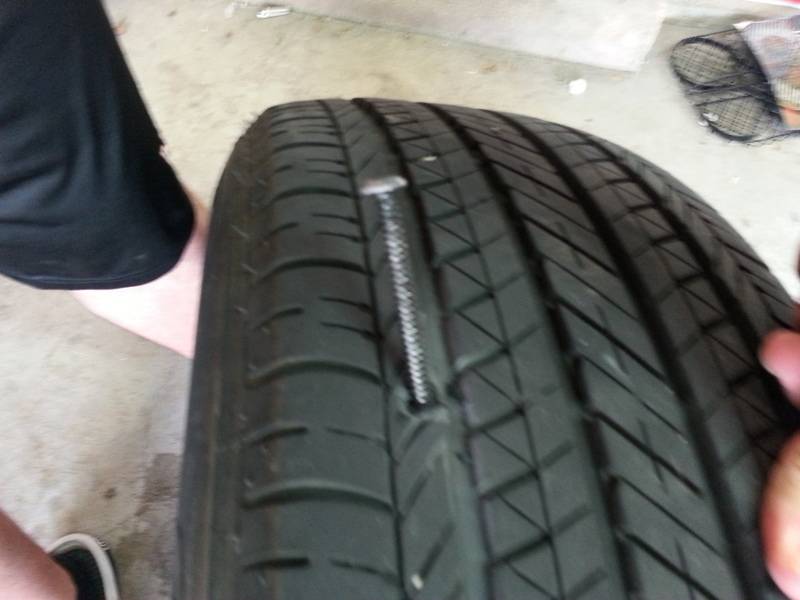

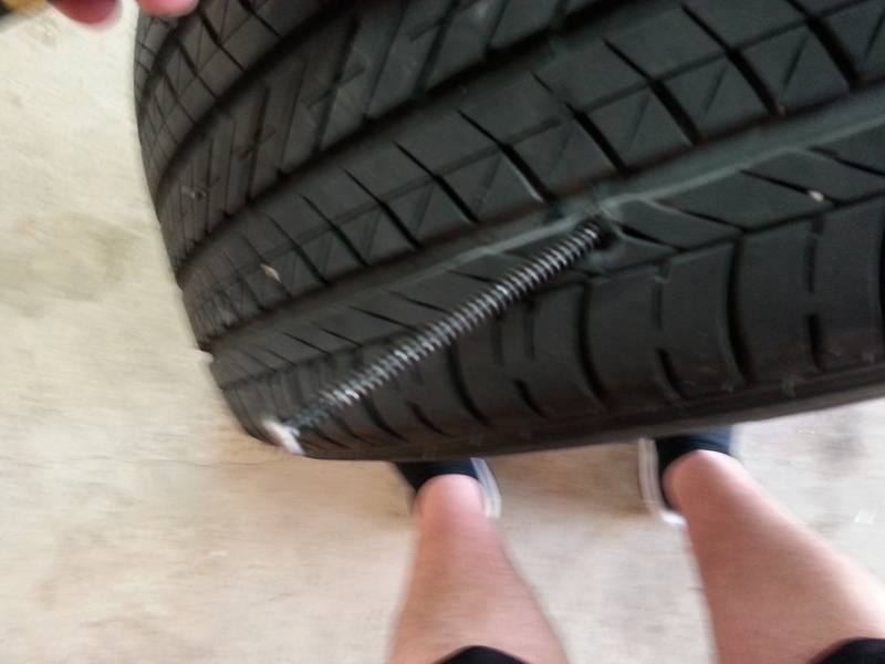

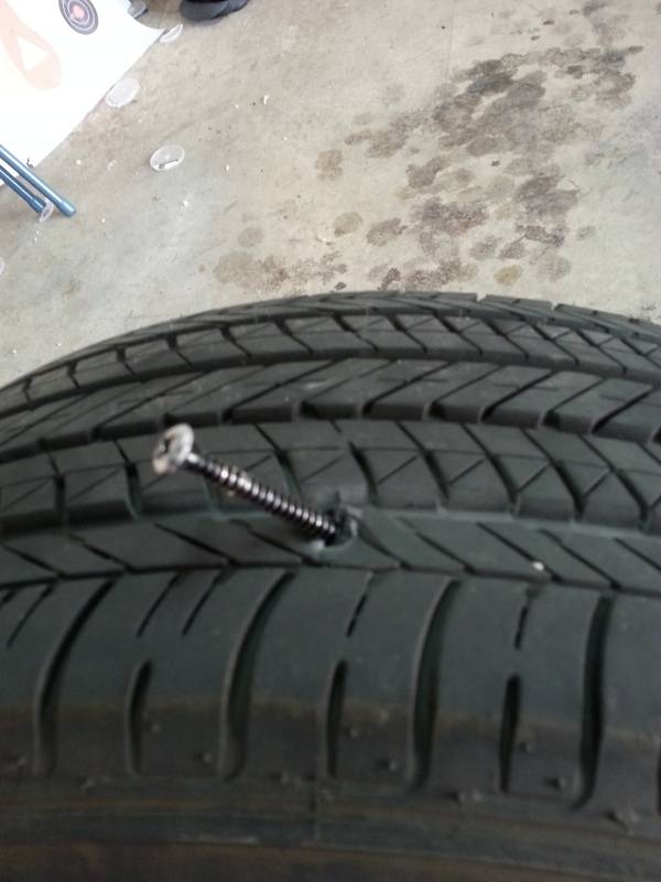

Pulled this out of my sisters Trailblazer tire the other day lol
Kept going....
and going....
and going...
LOL

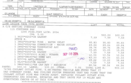

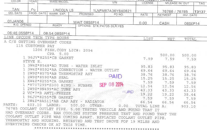

changed the coils and plugs on the drivers side. my knuckles are scrapped. drove around, no codes....now overheat again. lost engine power, was close to home, let it cool and added more motorcraft Gold. OBD says 1299 again, but I have no leaks. Will a radiator flush cure this at 76,700 mi?
Well, I'm sure it's not the same issue(s) as everyone else who's ever had this problem...
(Hint: you have leaks, you just don't recognize them.)
