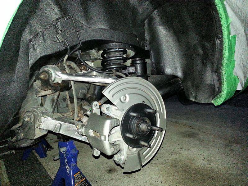

Polished all the upper/lower Control Arms to a near perfect chrome shine. As good as it's going to get in-car, would have to be taken apart and out of vehicle to get it perfect. Not interested, good enough, all cleaned up, looks 10 times better.
Yup!
Almost got the brakes back in. Takes me a while.
Looks good :Beer

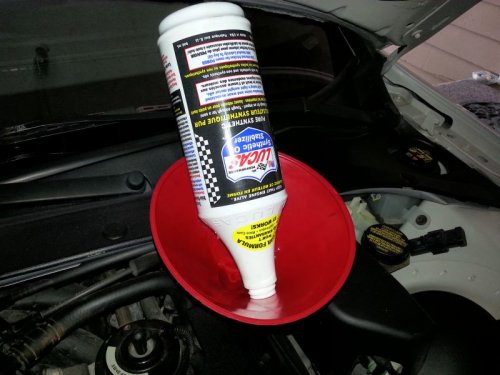

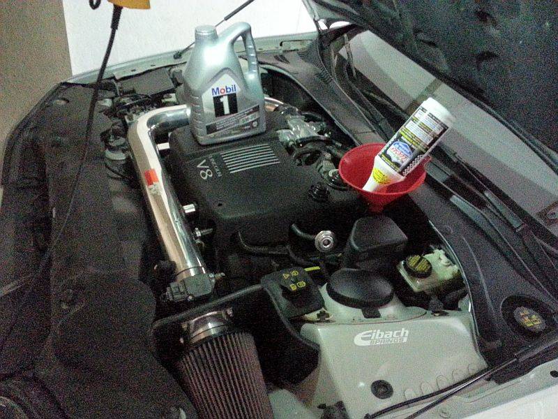

Didn't get much done today/weekend, just an oil change.
New drain plug, new Motorcraft FL-2021 oil filter, Mobil1 5W20 Synthetic w/ LUCAS Synthetic.
Ran it for a bit, idles nicely.
~ painted the bottom of the oil pan.

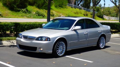

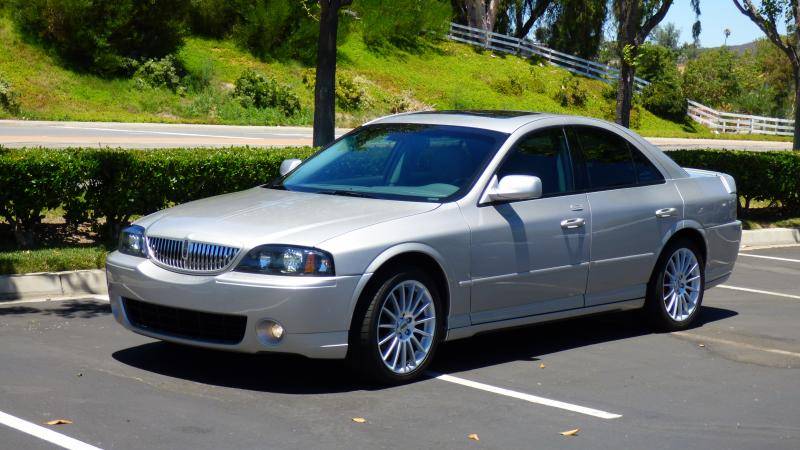

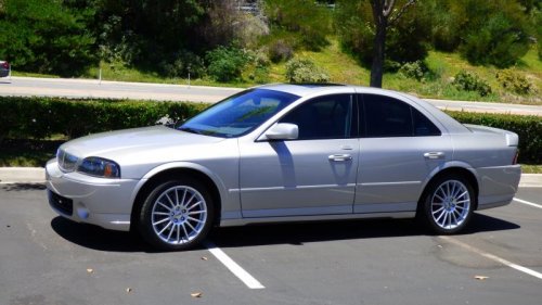

Had the old tint removed (I don't think I got what I paid for and the installer is out of business) and new installed. On our recent trip to Texas my wife got a little sunburned with the factory "tint" and my daughter also got a little pink with the alleged 50% tint on her window. I used SunTek CXP tint. Wasn't cheap, but well worth the outlay, IMHO. It looks OUTSTANDING!!! Can't recommend the tint enough!!

Mine was ~$445 which included removing the old tint. The People's Republik doesn't allow tint on the front windows. I got one fix-it-ticket up by Eureka years ago but I think that was in lieu of a ticket for 10 over. I went with 45% on the front two windows and 20% on the back 3.
Pics later..... Should I find the time....
BigRig, your LS always looks so clean! And you always seem to be taking great care of it. Good work.

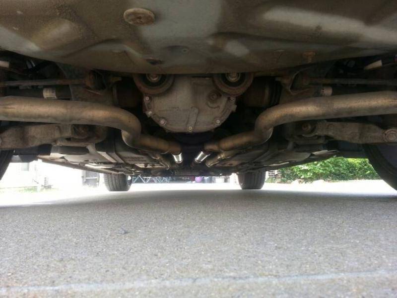

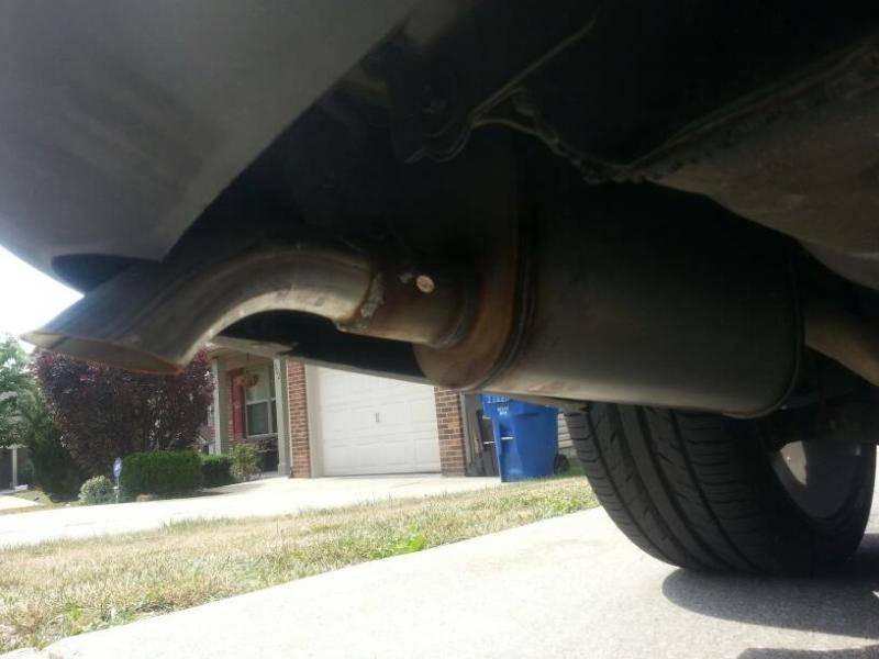

Finally got an intake. Just went with the kkm intake and may get the asmi one later on... cleaned my mass air sensor and also the throttle body while I was at it... also got my resanators cut and replaced with straight pipe along with 2 flo pro mufflers. Sounds decent... Exhaust only cost me 350 installed so I cant complain... ill try to get a sound clip somwtime soon. All in all a good day for my LS...

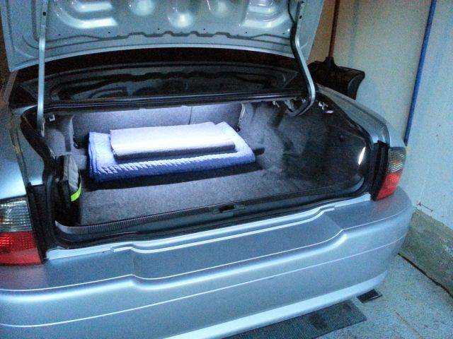

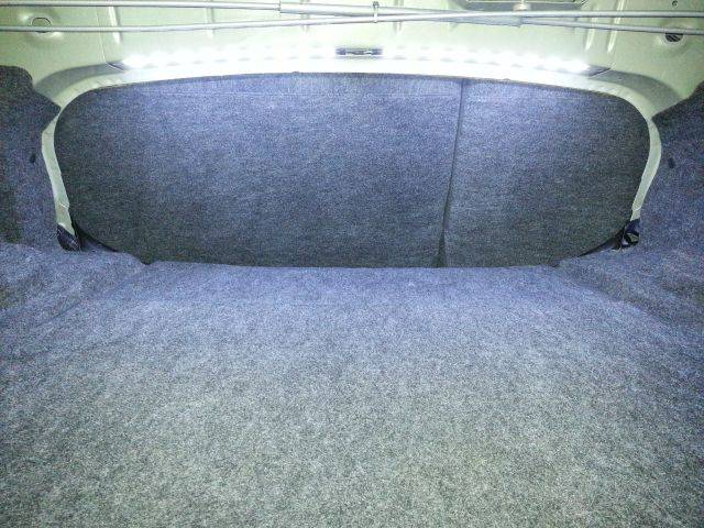

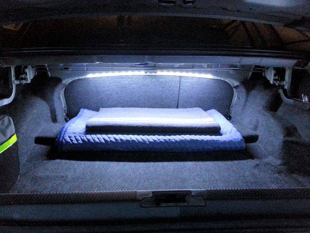

What's the deal with the trunk lights? Always in the dark with factory trunk light on my '02 LSE. Care to share where you goy them?
I got some LED strips from www.superbrightleds.com and wired them into the factory light. I mounted 2 up front, two I the middle (to the back of the factory amp cover) and two at the rear facing forward, down by where the spare tire cover meets the back of the trunk. Just install the strips where you like them.
Since you demanded and questioned my voracity :p .........
I did demand, didn't I ?
This thread is worthless without pics! If we did something to our LS'es today,
we ought to take the time to take a pic and amaze others (IMO)
Pics or it didn't happen!
... now please, don't take me so seriously!
Oh BTW ... sweet looking LS for sure, KUDOS to you!
Always "quote" a reply so the forum can understand to which post you are referring. If you see something on page#7 and you hit "reply" it will put your post at the bottom of all the pages, it could skip 50+ pages and others may then not clearly understand to which item/post you are commenting.

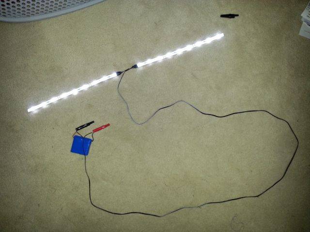

... It's just two of them soldered together (came two in a package), protected with some heat shrink tubing and running the lead
to the contacts on the trunk light, which I also switched to LED.
It comes on when you open the trunk ... Simple as Bob's your Uncle.
MAXLED, (many available colors) ... By Alpena, distributed by Walmart and others.
Pics or it didn't ..... LOL
Cool, no X-pipe! Hmmmm???
