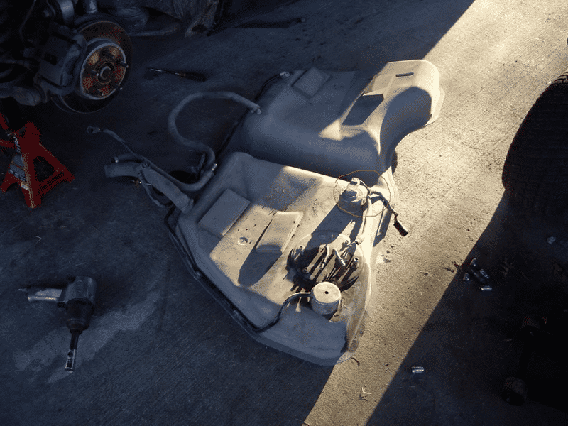

This isn't my picture, but that's what broke when i tried to take it off.

I recognize that picture cause I am the one that took it! :lol:
Thats my old 97 tank. And if its the circle then thats a level sensor or evap, forget which but thats not your problem. BTW, you didnt need to remove that to drop the tank.

thats the fuel tank psi sensor, used to detect an evap leak, it will run without it but you will get a CEL and a leak with it broken. and dont glue it back together cuz that wont work

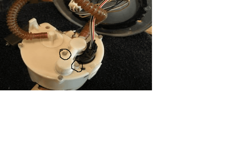

Thanks for the help guys but I reversed the wires and I can hear the pump working but still cant get my car to run and it was running before I did all of this. So I think im going to get another fuel pump and see if that helps. Another thing I noticed when I took the entire fuel pump assembly out is both these screw were at the bottom of the tank and the bottom filter was there with them.
