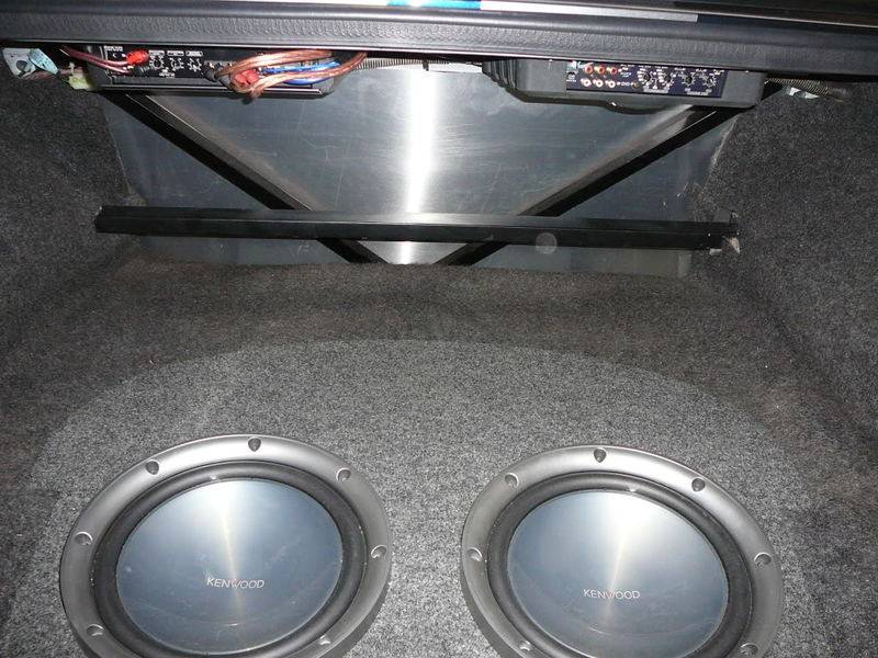

Here are pics of the setup in my XR7. Hopefully they'll give you some ideas.
When running on the street (kill switch is on the right, next to the methanol tank):
When I go to the track, I swap the passenger taillight out for one with a hole through it, and install the pusher assembly on the switch.
The car also has a NHRA-legal aluminum rear firewall and package shelf (since I'm not running a sealed battery box), and the subs are removed for runs at the track as well. I used 2/0 fine-strand welding cable for the positive lead to the starter and for the main ground.
I'd recommend a 200 amp mega fuse on the cable from the battery to the kill switch (as close to the battery as possible) and another on the cable from the alternator to the battery or battery post of the kill switch (as close to the alternator as possible).
