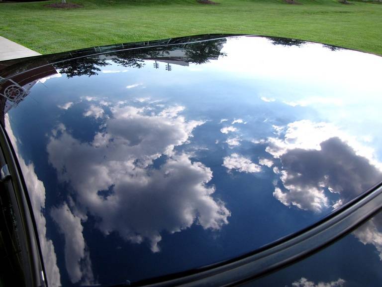

Lol apparently I've got problems. Went over to my dads today. He saw my car and say "Sweet Jesus that thing is f*cking shiny!" to which I say "Meh.." He looks at me funny and I turn around to look at it and realize its a freaking mirror. Could perfectly see all the reflections of the clouds and nearby buildings lol. I need to learn to just step away and enjoy the damn thing. I've become ubsessed with the little tiny barely visible scratches. Gotta chill the f*ck out haha
No, nothing wrong with you.
Yes, to the average person, a wash and fresh coat of wax is enough. Looks good from far, but far from good. I'm overly picky about a car's appearance. The times it bothers me the most is under the lights at the gas station at night. You can see everything under those. I bought one of those lights, and it's hanging in the garage for me to spot defects.
You can have "good enough," and you can have "amazing."

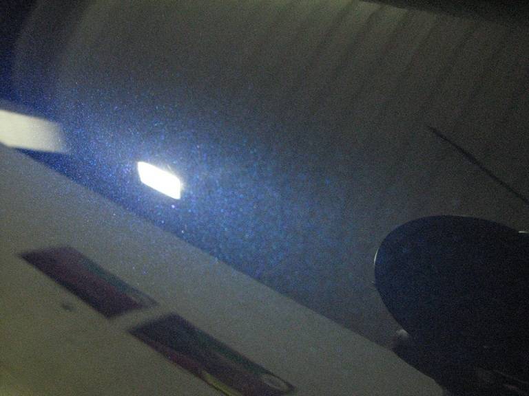

I wouldn't notice those small scratches until I began to look through the paint, not at it.
Try looking at a reflection of a light bulb, like ones in your garage ceiling, at night. You'll be able to see all the scratches on your paint. You can actually get your paint to get an almost perfect mirror reflection, like pektel got once he wetsanded his car.
