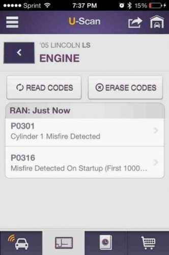

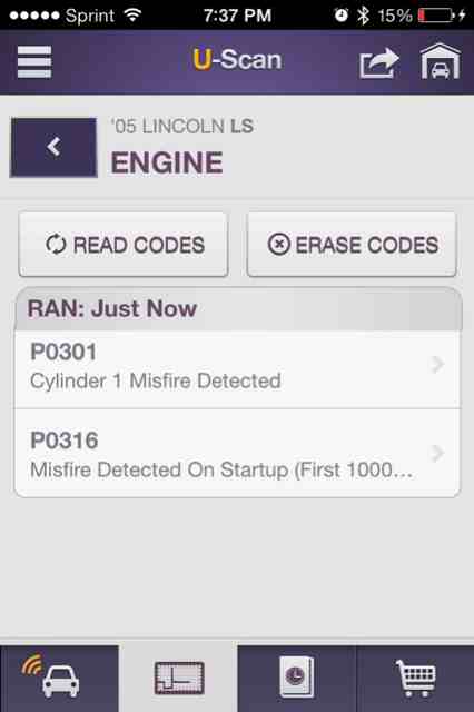

05 v6 has a very rough start in cold weather. The rpms go up and down then drop below 1 and the car shakes like crazy. Eventually it adjusts and feels smooth. I thought it was the weather or starter until the check engine light came on. The cold came up as a misfire. Besides changing the coils any other suggestions fellas? ImageUploadedByTapatalk1389023680.533367.jpg
05 v6 has a very rough start in cold weather. The rpms go up and down then drop below 1 and the car shakes like crazy. Eventually it adjusts and feels smooth. I thought it was the weather or starter until the check engine light came on. The cold came up as a misfire. Besides changing the coils any other suggestions fellas? View attachment 828464547
1. You must change the spark plugs at the same time. Verify the gap on the plugs.
2. Check the PCV plumbing.
3. Check the o-ring seals on the runner valves.
Generally speaking, it would be good to look for vacuum leaks when the engine is running badly. You can use propane for this.
